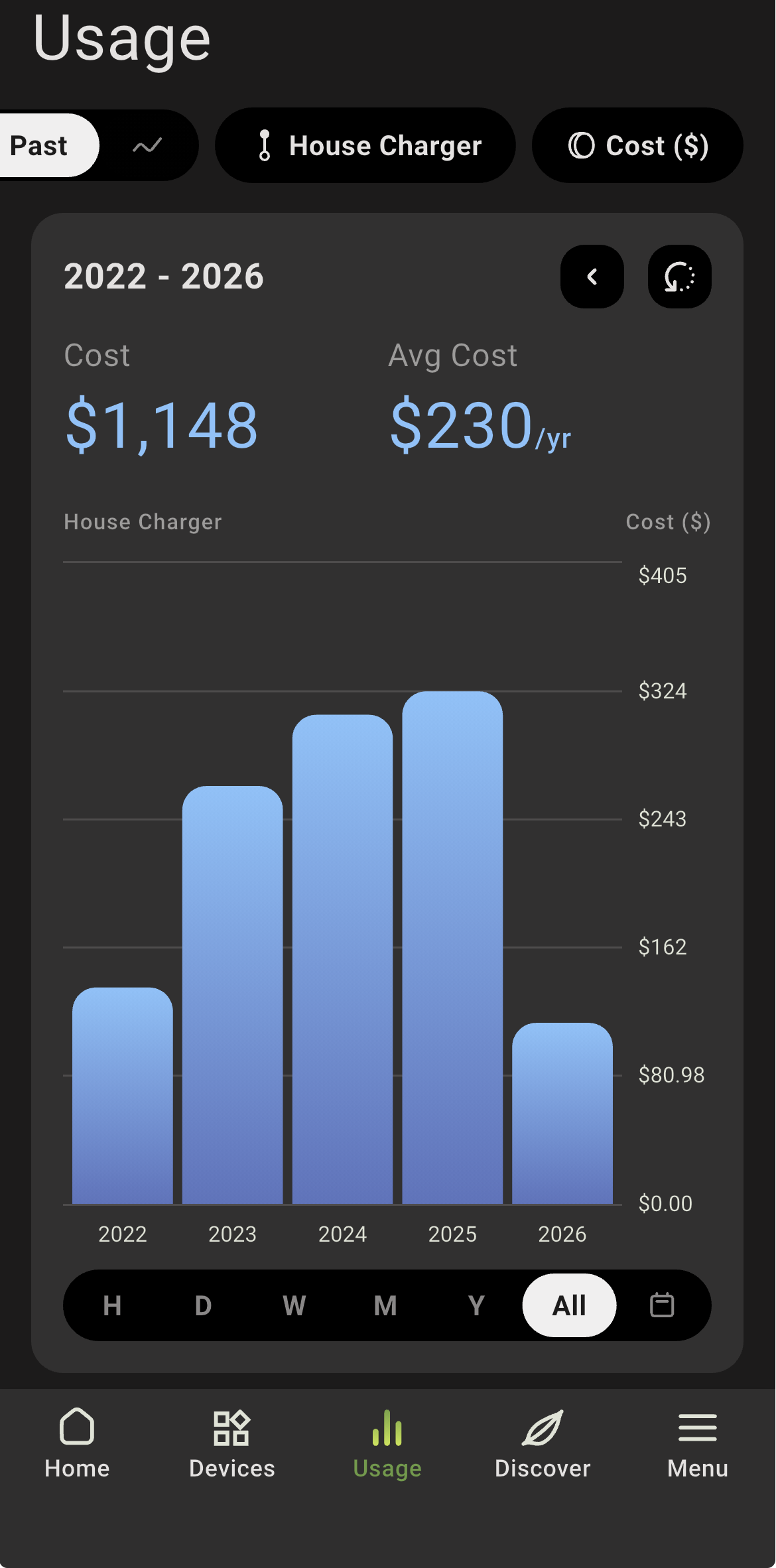

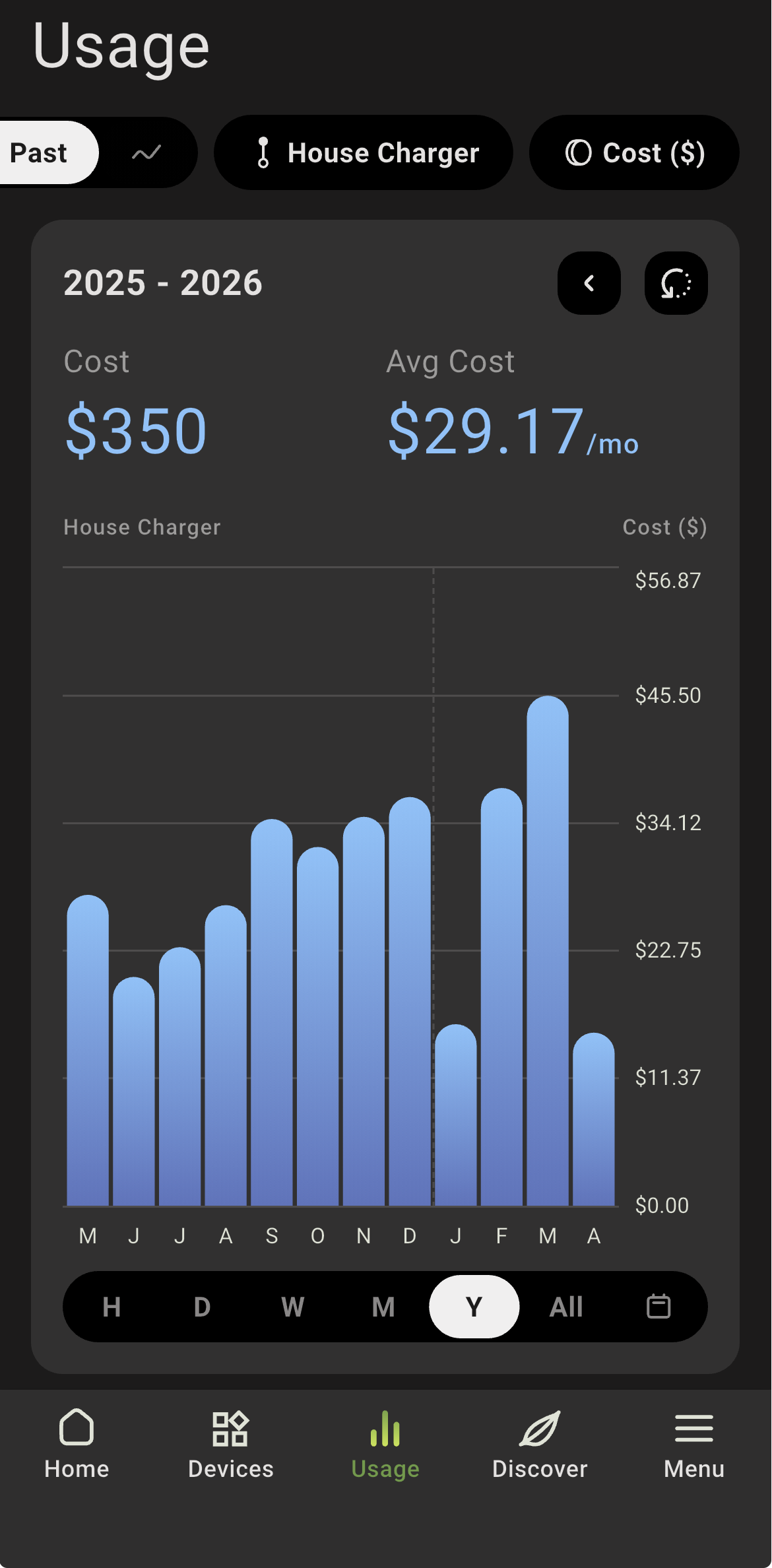

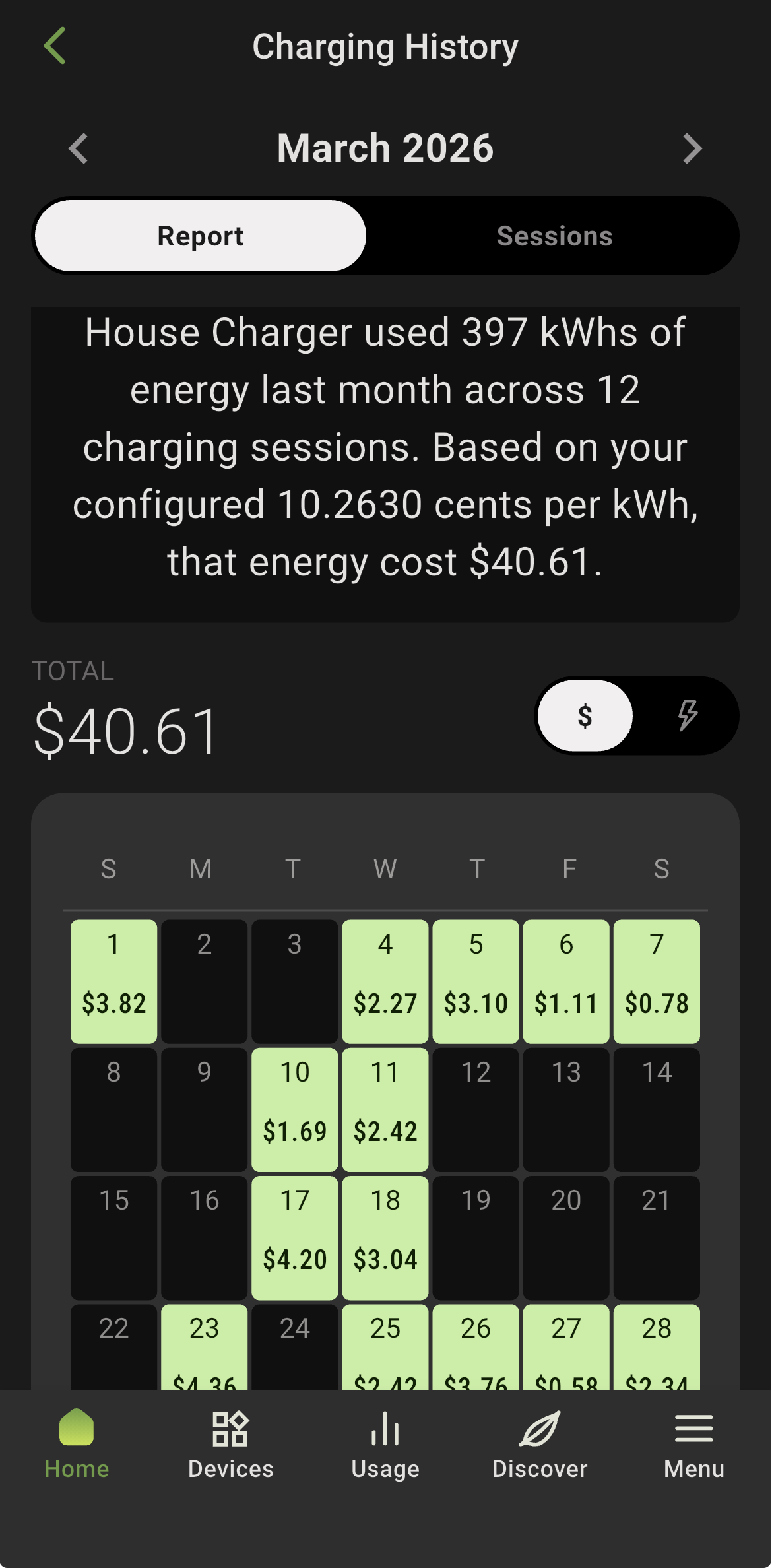

Also, a lot of smart/connected L2 chargers you get for your house, have apps/data you can use to look at JUST the EV chargers consumption/costs. So that is another easy option. I can post a screenshot from my phone later.
Here are a few examples from the emporia charger I have.
You can see it in a report for the month. You can see the days of the week we charged, and how much that cost us.
You can check historical usage (you can actually do this down the minute, or out to all time)
You can change the units from cost, to KWH, or a bunch of other things.
Anyway, just showing off what some of the options are :).

I like the information your Emporia gives. If you had a time of day utility rate, would you be able to input that?

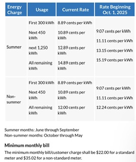

Here are the current rates in Columbia, MO (far right column)
I believe so?
I haven't had to do that yet, as they don't really have time of use here (its in testing... but very not worth it yet. Its like 2-3x more expensive during peak, and $0.01 less during off peak (yes, one penny cheaper).
It lets you put in your electricity rates, or even lookup your plan for you (which I just tried, and it found mine).
It also has a charging schedule feature, with an option to "charge when cheapest" (smart saver), where you can define a whole bunch of stuff. I'm sure you could look into it more/find more info in reviews if needed.

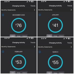

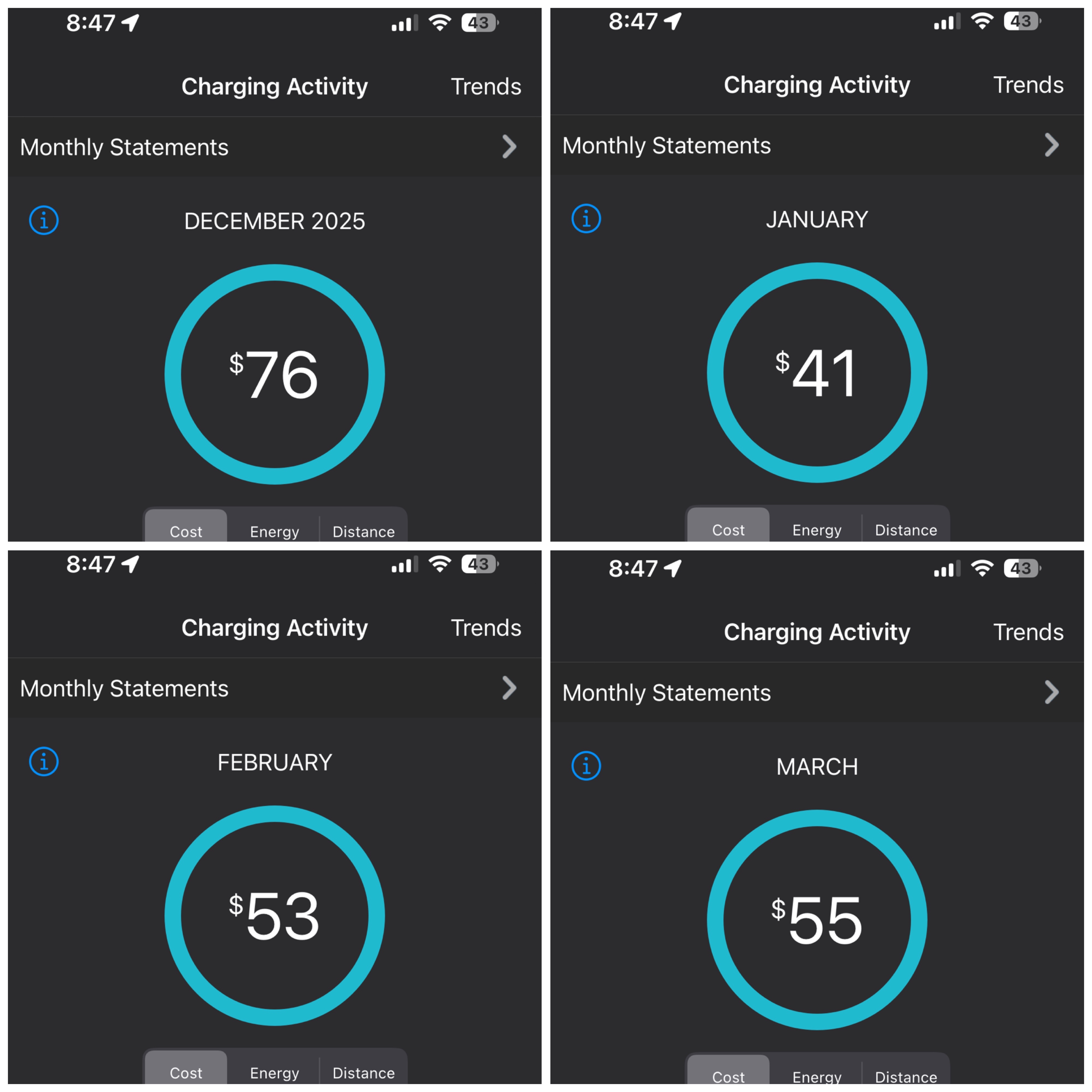

This what I paid for my bolt, driving 120-150+ Miles a day 5-6 days a week with extra travel in December for festivities
