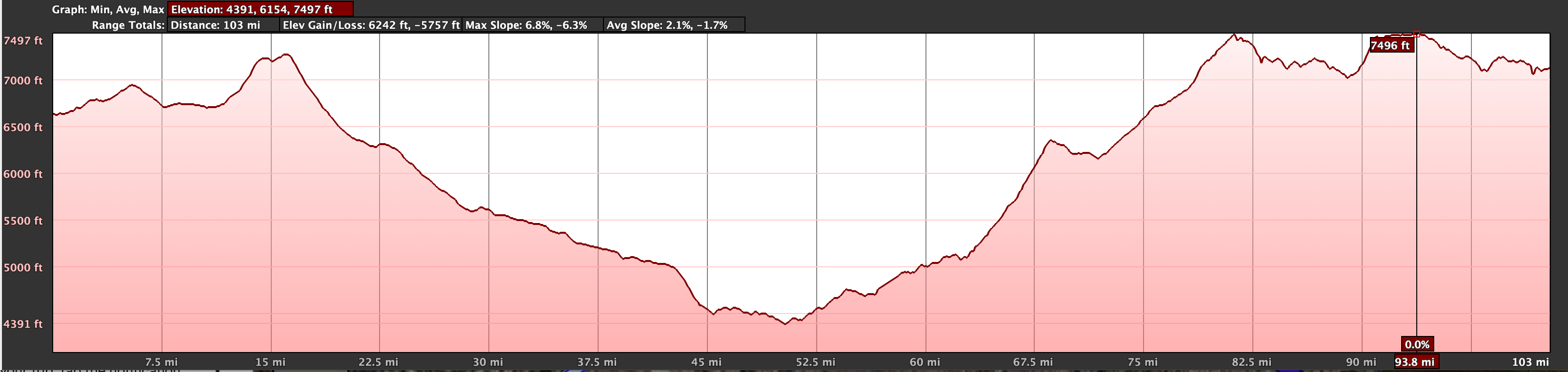

Assuming the EPA range estimate was correct would suggest that we should have used 66% of the battery on the round trip.
We arrived home with 17% state of charge. That is, we used 77%. It’s not really surprising, considering the speed and cold, and considering the elevation climb both on the way there and on the way home—yes, it really was uphill both ways.
Here’s the one-way elevation profile: We started at about 6700 feet elevation, climbed to about 7500 feet elevation, and descended a little bit to the rim.
