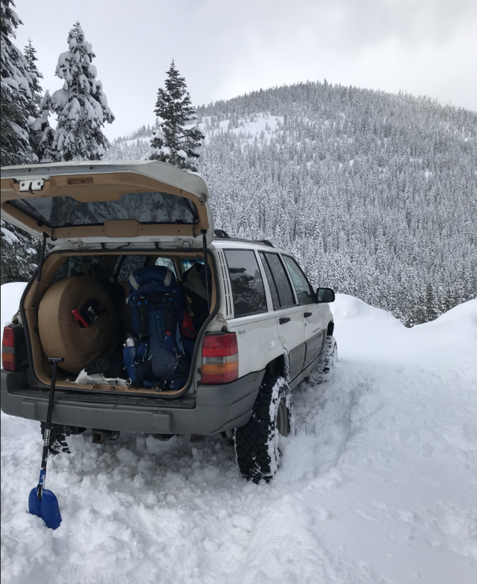

I mentor a group of 15-18yr old boys, and we do a yearly winter snowshoe hike. And... this is what we did last year. Snowjabba :D. He was a solid 5ft tall. So pretty good size.

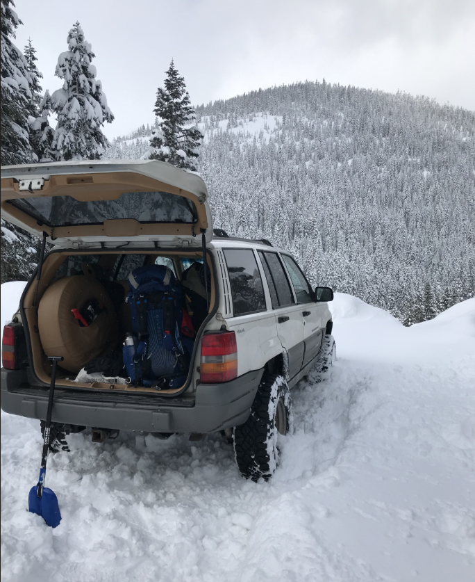

Figured people would like this photo as well. The ZJ that I've had for almost 20yrs now. Not stuck, just parking.
