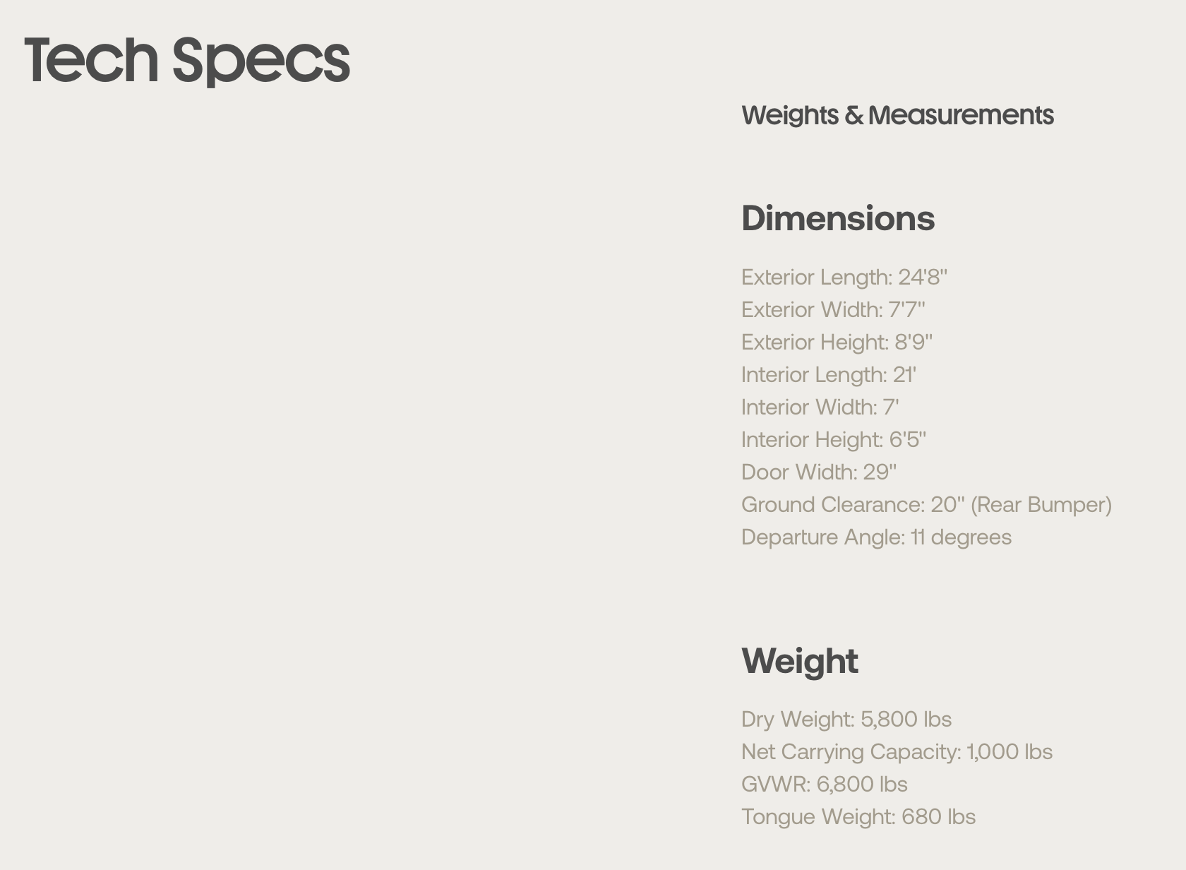

Pebble says you don’t need a WDH, some people are using one anyway.
Pebble is wrong unless they’ve found some magical way of reducing tongue weight (hint: they haven’t). They have a tongue weight of 680 pounds, 136% overload of any SD vehicle with a 5000 pound capacity without a WDH.
