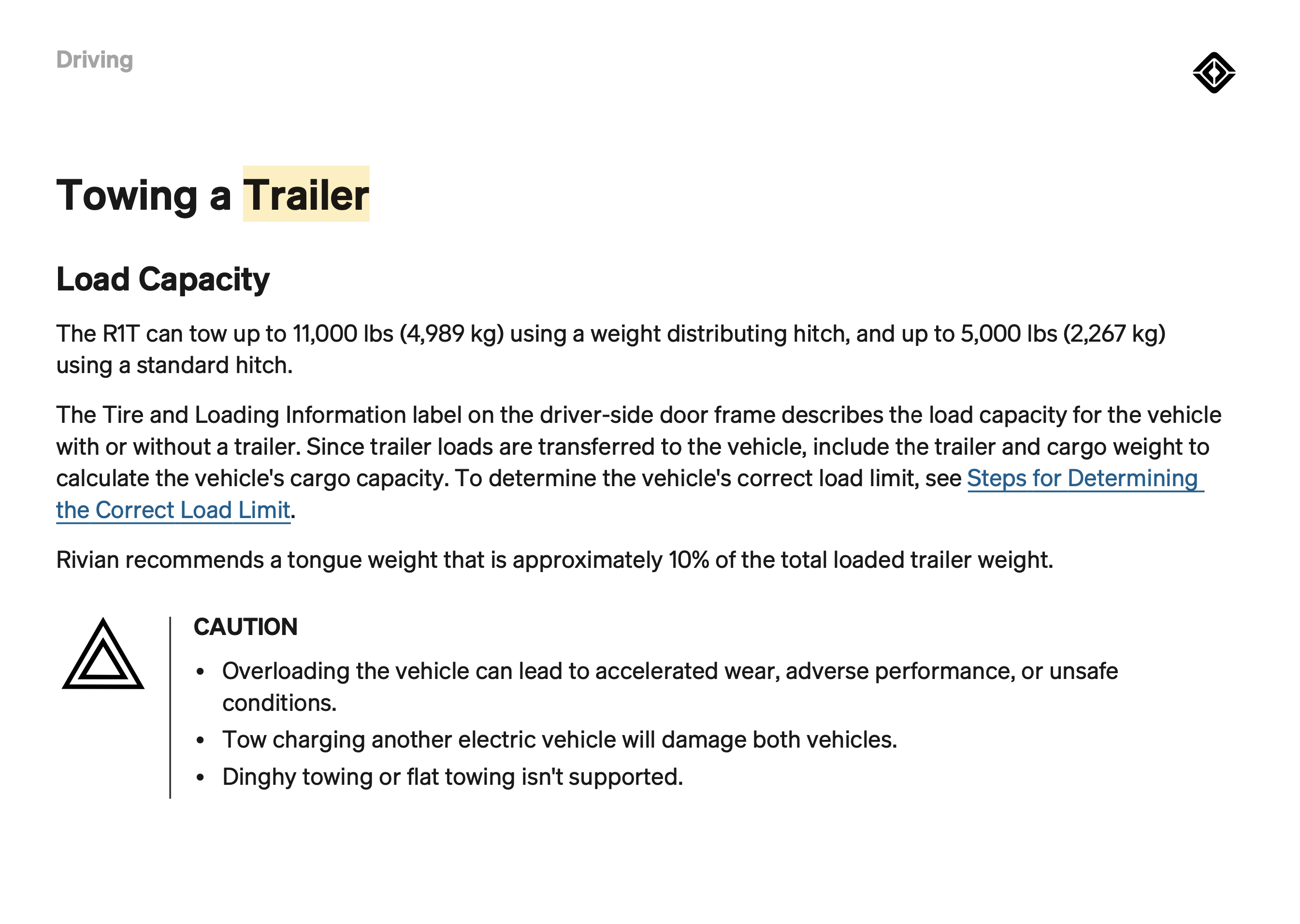

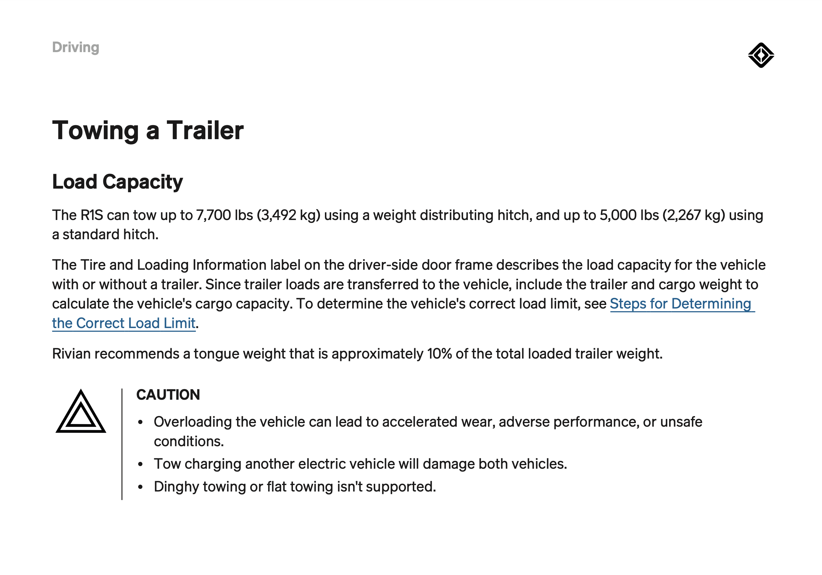

I know a lot of people like to think their truck is more capable than it is rated for. The ratings aren’t just for a thing breaking, they’re—more importantly—for the safety of other people on the road.
The images below are screen grabs from Rivian’s owner’s manuals. Rivian do not rate the truck nor the SUV to tow more than 5,000 pounds without a weight distributing hitch.
It’s not about the pulling capability. It’s about the weight on the hitch and the suspension response to the weight on the hitch. A >500 pound tongue load on the hitch will overload the rear suspension of any non-HD truck and could cause damage to the frame.

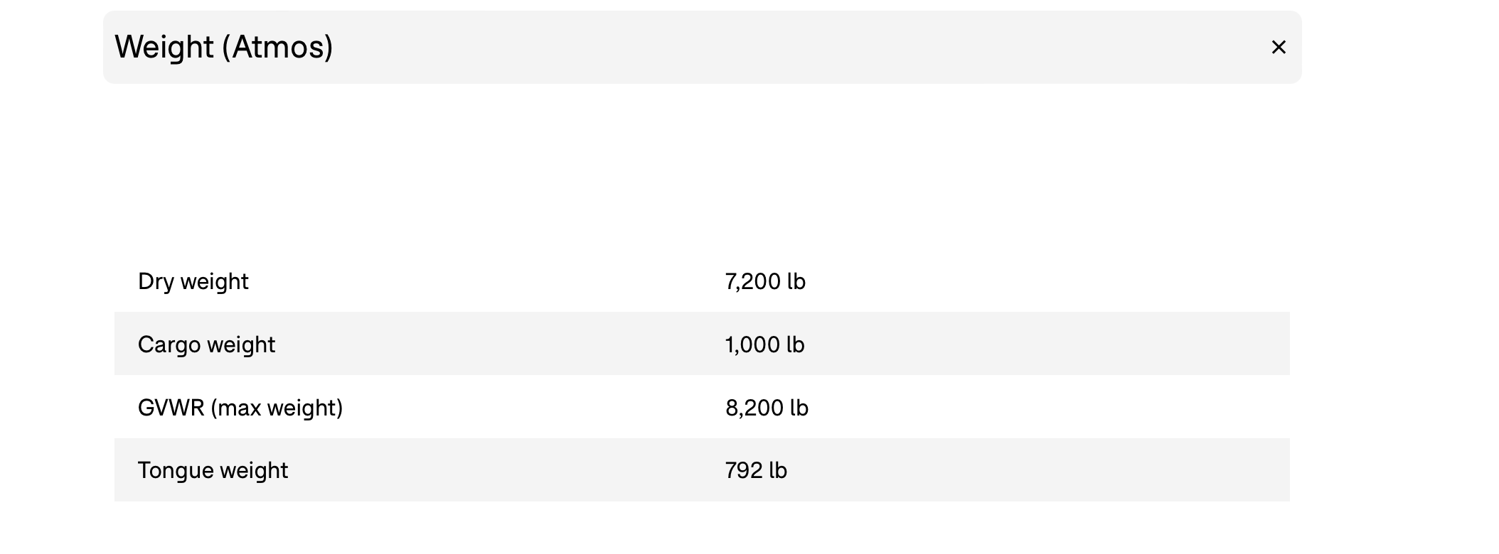

The Lightship Atmos has a tongue weight of 792 pounds. That’s 158% overloading the R1’s hitch.

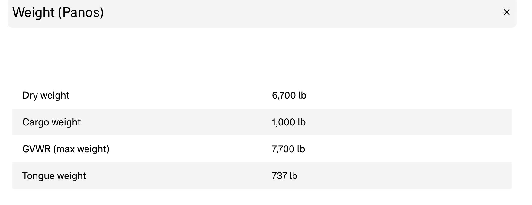

The Panos has a tongue weight of 737 pounds. That’s 147% overloading the R1’s hitch.
