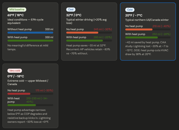

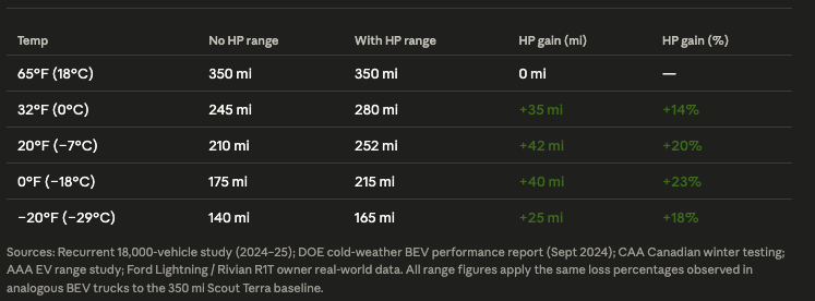

Now, here's a look with temperature impacts on range across 4 different temperature bands... The one I am really most interested in myself is the band at 20 degrees, which is a pretty good average winter temp for the Northeast over the span of my winter driving where DCFC charging will come into play on longer road trips:

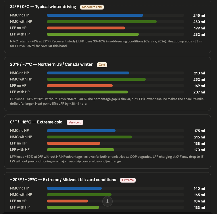

I guess my conclusion is that a 20% gain WITH a Heat Pump on NMC is really good. But, this lead me to a comparison of NMC vs. LFP:
This data tends to verify that NMC with a Heat Pump would be optimal for my own use case, and for those in the Northern tier. I'm guessing this will all come down to cost and capability, and what Scout's addressable market looks like for those seeking better winter performance. Obviously a lot of decisions surrounding battery size, chemistry, heat pump or no heat pump, efficiency, etc. all still need to be finalized before ANY of this data can be validated, but this is an interesting consideration for winter performance for sure.
