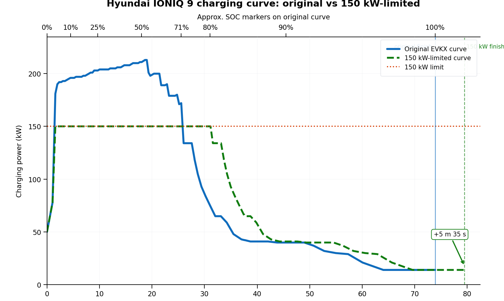

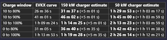

Well, I threw AI at it, and tossed the charging curve data for my Ioniq 9 (data), and had it do the math I was too lazy to do. Our Ioniq 9 holds over 150kw from 2%, up until about 71-72%. But it peaks at something like ~230-235kw.
According to the AI math, its showing that the difference in recharge times on a 150kw charger, vs a 350kw charger, is really only about 5 minutes. But the 50kw charger is really going to slow things down in comparison (an hour or so longer).
EDIT: Whoa, that got mangled. An image instead.
