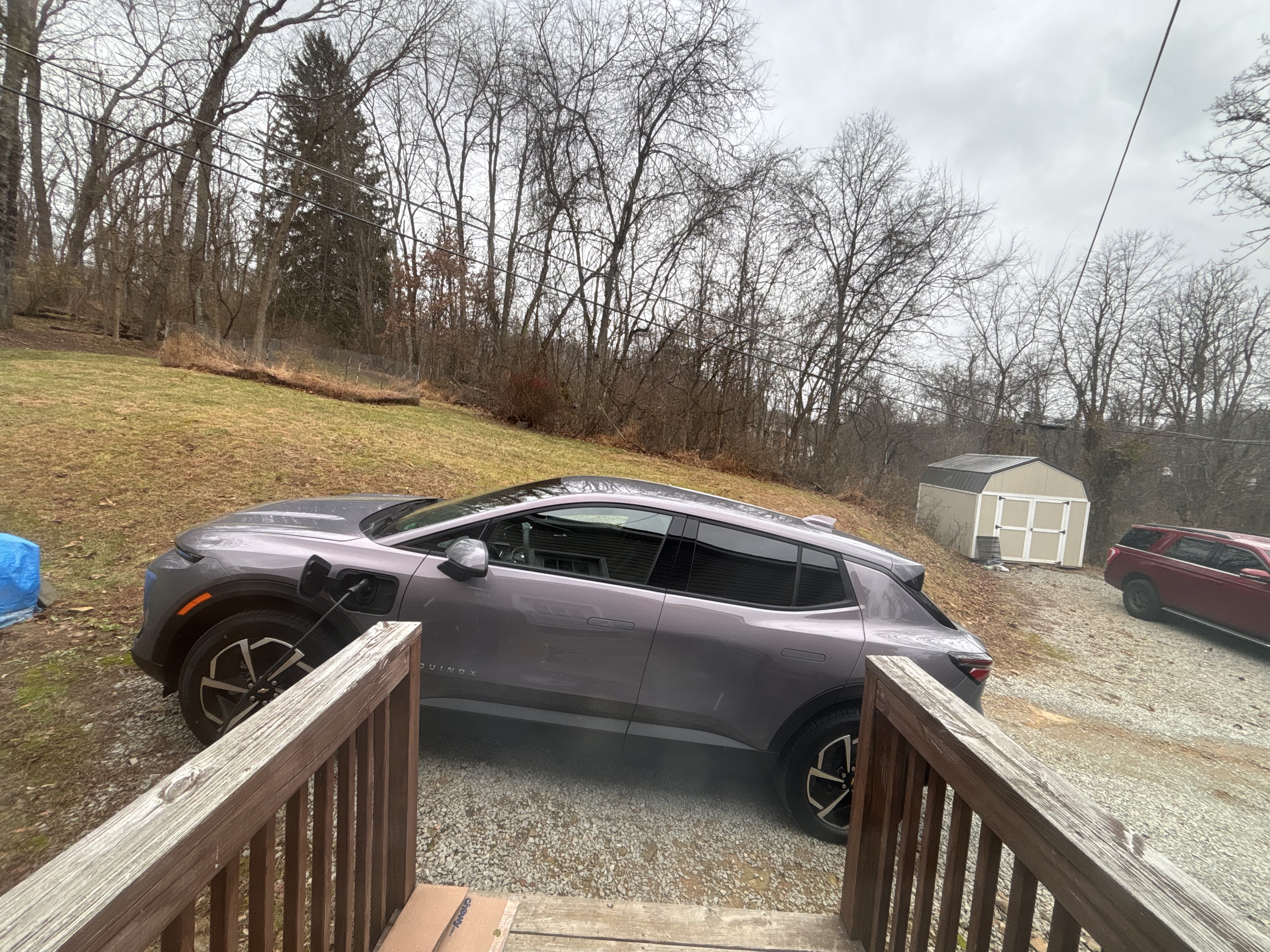

I had begun installing an Emporia Pro charger the days before but hadn't completed installation yet. So first thing this morning I rolled out of bed and installed my hardwired whip (needed more length than the installed charger whip provided), mounted the charger on the wall, secured the hardwired whip to the exterior wall (everything is mounted on the exterior of the house right next to the main meter with distribution panel), installed whip into the panel and secured it, installed 60 amp breaker (48 amp install with 6 awg wire) and torqued to specified torque. Placed panel cover back on initialized the charger app, cleaned up the work area in 30 degree F temps and hooked up the car.
I confirmed the car was charging and then walked back inside to drink my coffee...
Happy Thanksgiving Everyone!View attachment 11730

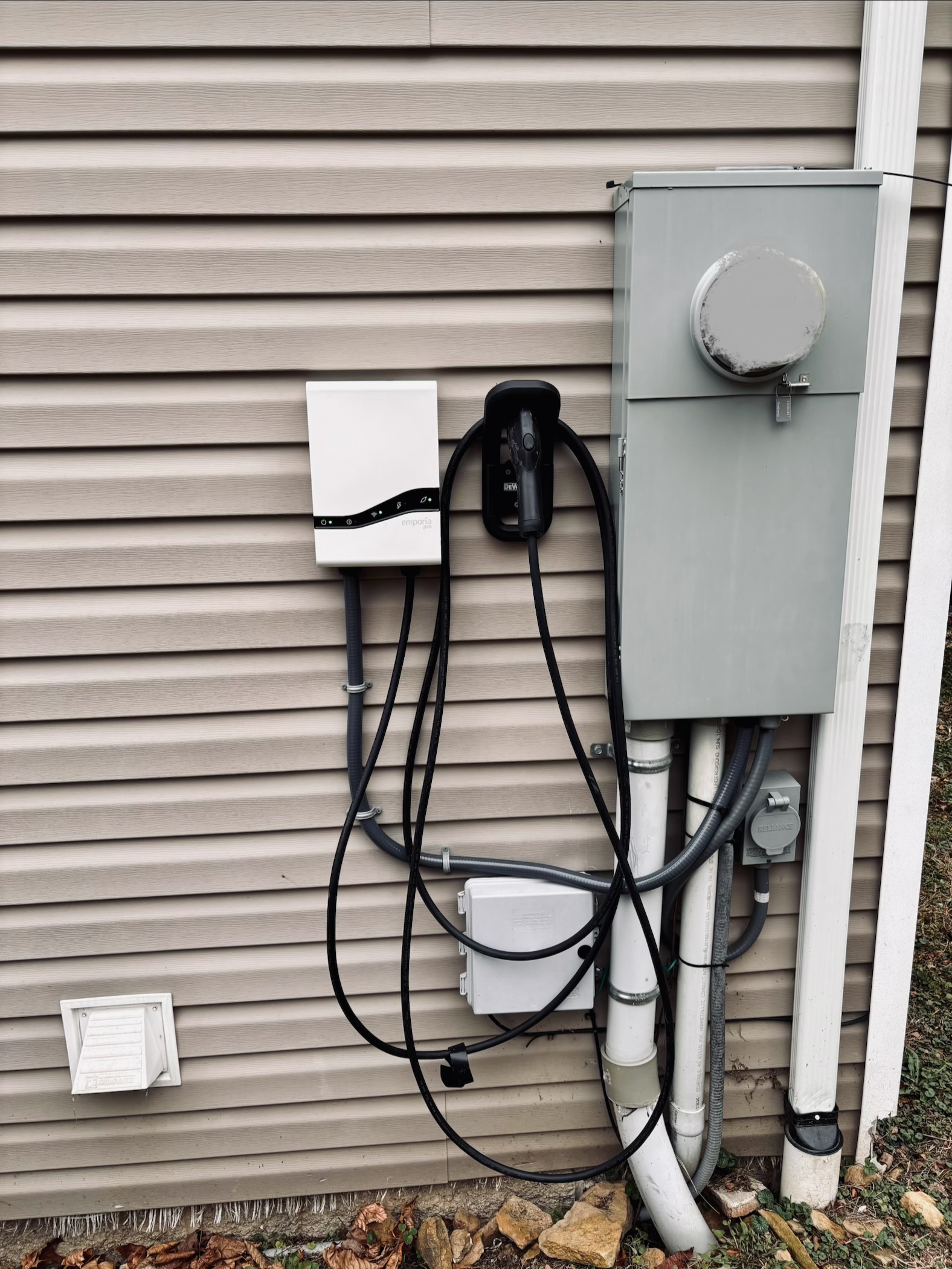

Thought I’d show off the end result of installed the level 2 EVSE. I wish this panels main feed was located on the right side of the panel but that’s unfortunately not the case. Really makes cable management a royal pain since all the expansion knock outs are on the right and the only room to mount to the wall is on the left of the panel.
Used a DeWalt holster. It’s a much better quality powder coated mount with plastic insert for the holster that’s angled down and slims the outward profile of the charge handle when docked.

Thought I’d show off the end result of installed the level 2 EVSE. I wish this panels main feed was located on the right side of the panel but that’s unfortunately not the case. Really makes cable management a royal pain since all the expansion knock outs are in the right and the only room to mount to the wall is on the left of the panel.
Used a Dewalt holster. It’s a much better quality powder coated mount with plastic insert for the holster that’s angled down and slims the outward profile of the charge handle when docked.
Looks great!
One hint coming from experience: Moths and other critters love the dark hidey space in that holster/plug. Check it every time you go to plug in so you don’t squish a critter into your vehicle’s charge port...

I’ve only seen it once. A moth had decided to hide in the warm charge plug of the charger. I squashed it when plugging into my truck. Kinda gross. I suspect it’s not a high-probability event since I’ve only seen it that once. But I’m trying to make it a habit to look down the plug before plugging in. Also while on road trips.
Probably not but I suspect spiders and webbing will be a potential issue along this all the web balled insect carcasses
