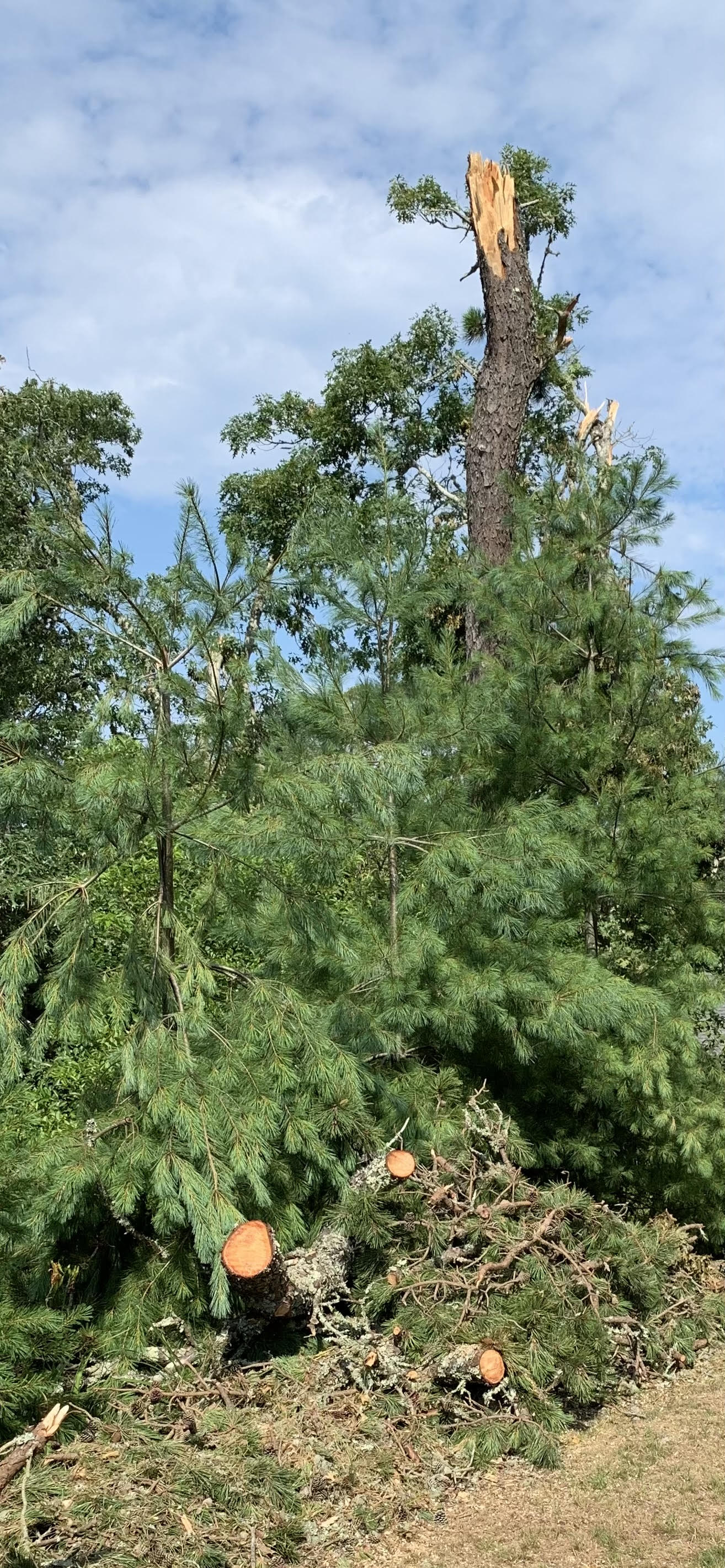

Bad storms. Ours was minimal-hundreds of trees in the county came down, cars and house crushed, lots of downed power lines so minimal work and still have power so can’t complain-but had me wondering about options that could spoil up an electric chainsaw. Just our township had 40 roads closed still today and storm was Saturday night.
