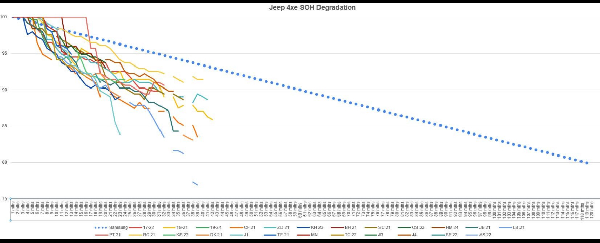

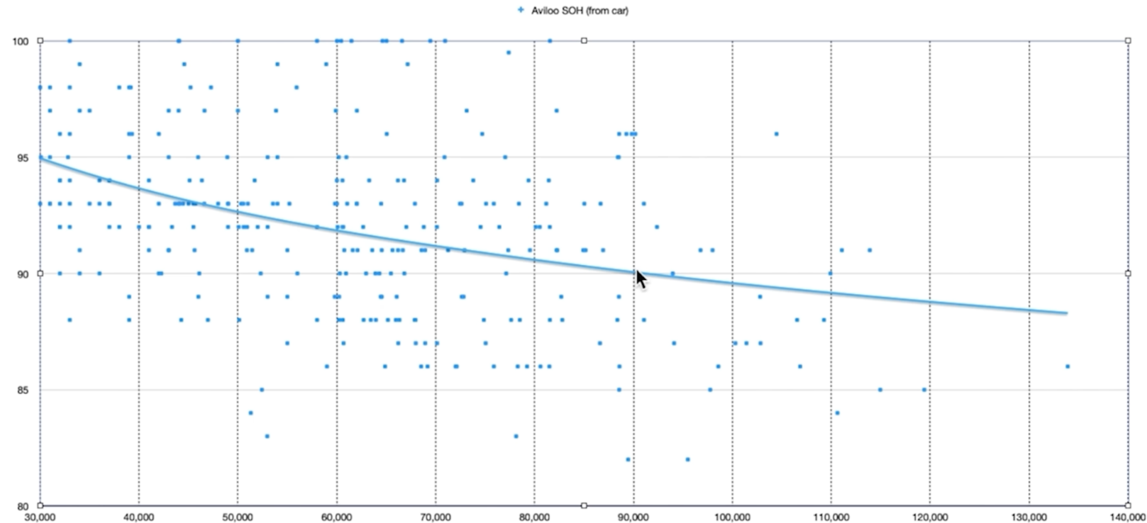

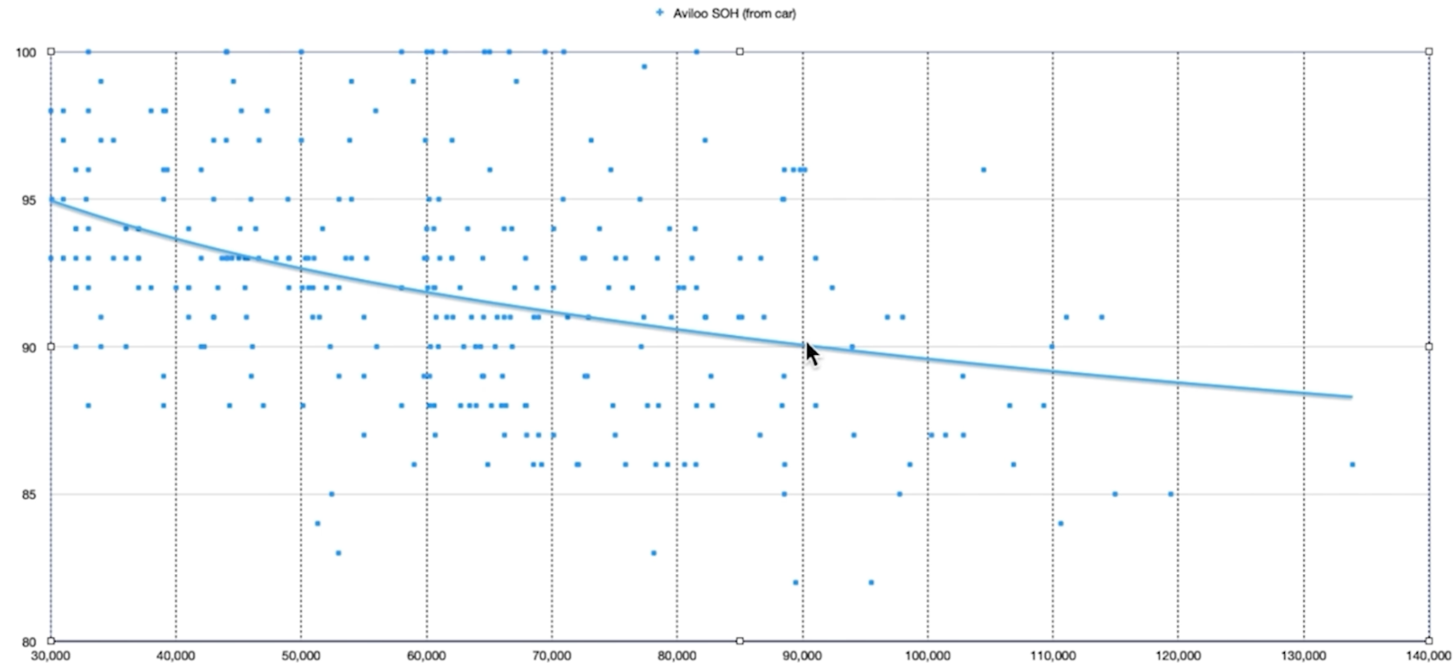

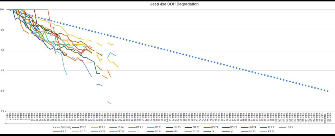

But I hear you. From an article just last week.
So, to your point, battery degradation is definitely a thing. It does seem to drop "sort of sharply" at the beginning (look at the Y axis scale though), and then sort of taper off. With most EV's having ~88-89% of their original capacity after 100k miles.
That’s how it should work but the 4xE is not acting that way. I do think it is due to the engineering of the parallel hybrid and likely bad batteries from Samsung. Here is the data to show what is happening:

Sure, when you start with a tiny amount of range (21 miles) AND you couple that with faster degradation at the start of the health curve, I could see how that could appear more worrisome, but we aren't talking about a tiny 17 kWh battery in this case for the Harvester or the Pure EV. For reference, and based on 41,000 miles of driving and charging (mostly L2) to 70%, with a mix of DCFC to 80% on many weekends, I have seen only ~2-3% degradation on a 131kWk LG Pack. Again, this is why warranties will be an important factor in many people's decision to convert their reservation, and I think Scout will have a similar and competitive warranty to 8 years or 175,000 miles, but we will see. I can't imagine buying a vehicle that is begging to be charged and driven, but also having to worry about battery health. That would be a deal-killer for me.

I agree with you. I think the 4xE is a fault of poor engineering with too small a battery. And I am happy that I will likely get a new battery for my 4xe under warranty in the next year. For Scout’s sake I do hope they engineer it better than Stellantis.
