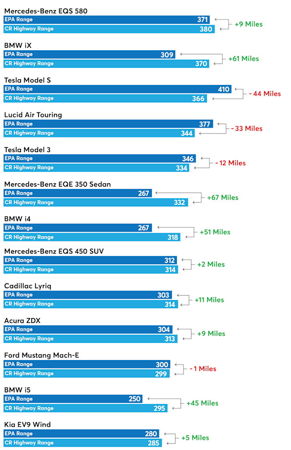

Totally agree.. the bar has been raised. Btw.. I charged at Rivian chargers the other day.. they are really good. As good as Tesla. The chart you shared with model 3.. I can't speak to other vehicles but it's hard to believe the Tesla. Lol
I will say, as an owner of a 320mile rated EV, range around town/day to day local use, is almost never even thought of. As almost any EV these days, will have enough range for normal day to day use on a 80-100% charge, unless your needs are extensive (200 miles or more, especially if it is on the highway, in winter time, could be an issue, but the number of people with 100+ mile 1 way commutes, is relatively small).
So in that case, I don't really think that city/mixed range "matters" all that much to most modern EV buyers anymore. Simply because as you say, EV's get better efficiency in town/at slower speeds (I've had mine show an estimated range almost 90 miles over the EPA range), and you also ... go slower at slower speeds, so it almost gets hard to drive more than a single charge in a single day. I mean, you could totally do it, but I think you'd almost have to try for it to be an issue for most people.
I do think that the 70-75mph range tests, are useful. Because, I do think that the times when people DO care about the range, it is on the highway.
So I'd actually be in favor of the EPA range being split into mixed, and highway numbers, much like fuel economy has been done in the past. That way people could buy knowing what sort of actual highway range they should be able to expect, when it matters most.

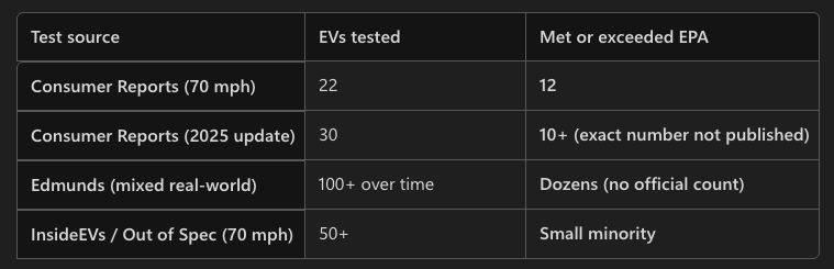

Totally agree that range is really only important and something I think about when on a longer road trip.
My point was more along the lines of showing that the numbers are lining up for a variety of different tests, and that if you do the research you will see there are actually a healthy number of EV options that meet or exceed their published numbers. The variables are everything though, and with all the tech that EV's offer, you see range impacts in real-time on the screen in front of your face. When range is degraded (and I do see that in the winter for sure), it often time has very little impact on my overall travel, I would need to be going really long to be adding significant stops (increasing trip duration).
This shows that 1/3 to 1/2 of EV's tested meet or exceed EPA range estimates. Most humans (myself included) don't really drive to an "EPA number" though:
I didn't realize it was that high. I assumed Tesla was the leader. I'm happy to know that things are moving that direction.
I will give one caveat.. numbers on papers and what people can actually achieve are definitely two different things. Like I just saw a chart that says the model 3 got 1 mi below the rated range.. there's either quality control issue or that's complete BS and not achievable. I ran tests and we're talking about 188 mile run and I would be worried about making it

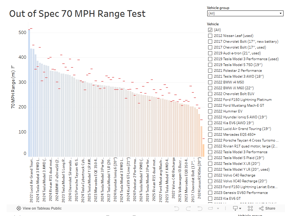

How many highway miles you get? 70 MPH. You can see from the video above, the only one that pulls it off is the SEV long range. The Rivian is close though. Only thing is we aren't going to drive to 0%.. So it's a bit unrealistic in that sense. That’s an important factor in my buying decision. I want a vehicle that performs as advertised. The old model of EV manufacturers overstating or misrepresenting range just isn’t acceptable anymore.
But the ranges are set based on consistent performance testing and day to day driving will vary with every driver. So there may be some that see it spot on while other get impacted on “lead foot” alone whereas a fully urban driver may rip 400+ miles of range. And geography and seasons play a huge role as well. So how do you establish the defined range with all those factors? Somebody is always gonna fall short and someone else will do very well
