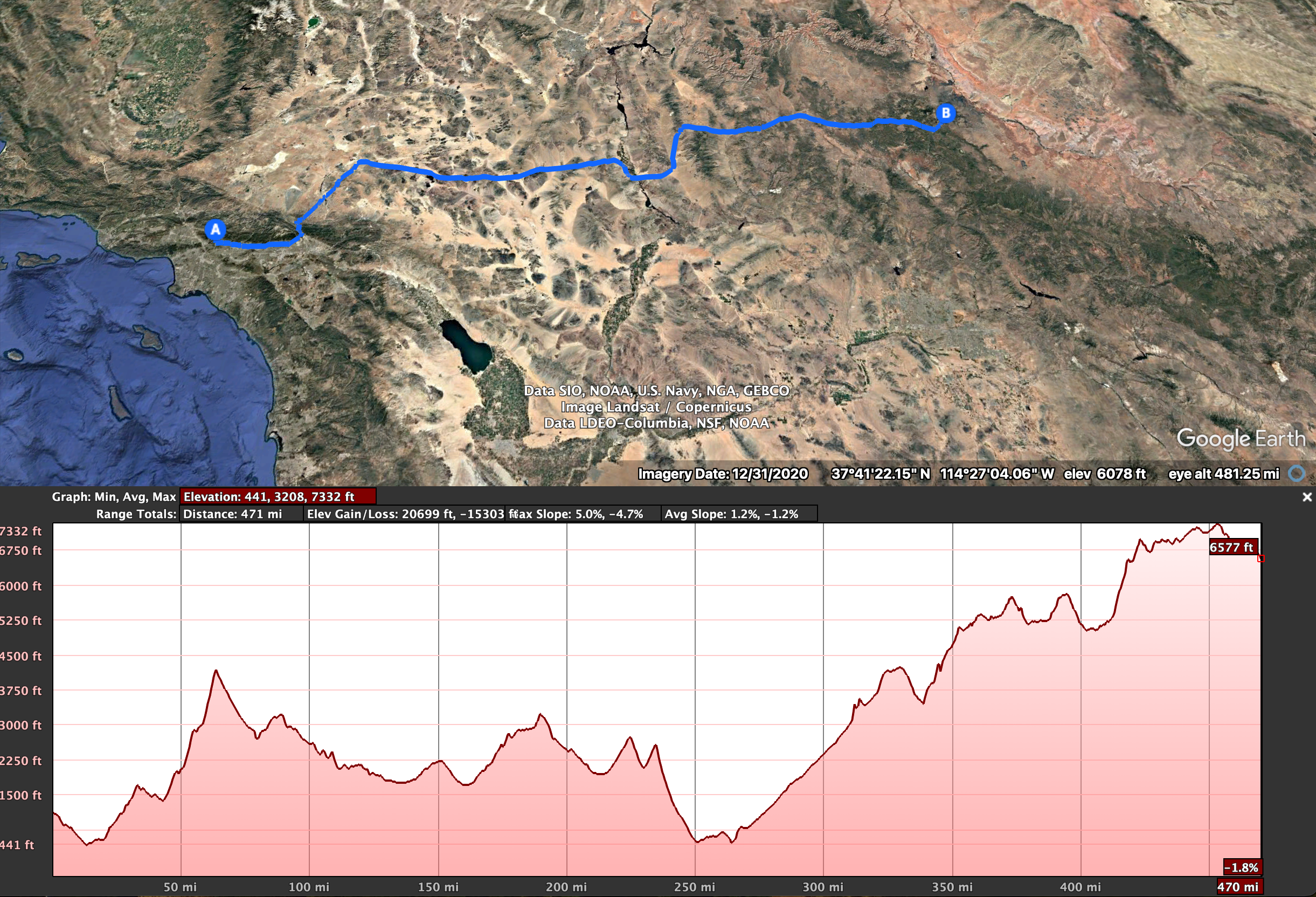

I run a regular road trip from northern Arizona to Los Angeles and back about one or two times a month, sometimes less, sometimes more. No fewer than six times a year. The one-way distance between my departure and destination is 474 miles. I drive at 72-73 mph unless I get stuck behind a truck for a few miles (slower) and then overtake the truck (faster than 75 mph). The trip includes two stops for restroom, charge, and meals. It takes me between 7 and 8 hours every time, and the 8 hours is usually due to traffic, sometimes due to weather. I usually do 100-300 miles around the LA valley when I’m there, and then I drive home. The usual total distance is 1100-1200 miles round trip.
Since buying the Lightning, I’ve almost exclusively driven it on this trip. Its size sucks for in-town driving, but it’s the most comfortable vehicle I’ve owned.
On that trip, my median range while driving down to LA in the Lightning is 330 miles, or just over 2.5 miles/kWh. The only time it’s been less is when there are snowstorms at high elevations and in the springtime when the Santa Ana winds come up. (These are 30 mph to 40 mph steady winds with higher-speed gusts. Looking back at the post in this thread by @R1TVT, you add those winds to your travel speed to get the power requirements, which goes as the cube of the sum of the speeds, so it’s like driving 100+ mph). For most of the year, I can comfortably travel 255 miles on the freeway to my first charging stop with enough reserve to make it to a backup charger, if necessary, but I always know if I need to stop early. When the Santa Ana winds are blowing, I’ll usually stop a little earlier to charge up, eat, and relax before going into the maelstrom.
In LA traffic, my median range is more than 1,000 miles. That’s not a typo. I drive several regular routes that allow me to keep a steady speed of 35 mph for 40-100 miles round trip. At 35 mph, minimal stopping and just flowing, I can easily get 8-9 miles/kWh. I will never realistically get 1000 miles range on one charge because I’m never driving 35 mph for 28 hours. But when I drive off-highway, through the desert, on forest service roads, etc., I can often get 4-5 miles/kWh.
On the way home, I climb from near sea level to ~7300 feet elevation, still fight the Santa Ana winds (they’re crosswinds, so their impact is actually greater than if they were headwinds, and they’re usually not helpful as a tailwind). The return trip is, obviously more energy expensive. I typically get around 2 miles/kWh for the entire return trip when it’s windy in the desert and cold on the mountain.
Overall for the freeway portions of the trip—down off the high elevation, through the windy desert, to city, then back up through the windy desert (against the wind both ways because they’re crosswinds), up the high elevation climb—I get an average of about 2.25 miles/kWh (288 miles range on my 131 kWh battery). The 2.25 miles/kWh doesn’t include the outlier range driving around town in Los Angeles.
Some things I do differently from maybe some other drivers: I did the calculations of what’s the optimal speed for getting where I’m going in a reasonable time vs energy use vs the overhead cost of stopping, and 72-73 mph is the optimal speed; faster and I just have to charge for longer, and slower means I don’t save enough to justify unless there’s an issue like especially strong winds. I run with 45-48 PSI in my tires, despite the Ford recommended pressure of 39 PSI; I don’t have significantly faster tire wear, but the ride is rougher. I don’t feel the need to rush. I don’t eat in the vehicle. I’ve been doing this trip for decades and it’s always taken me 7-8 hours depending on weather and traffic. It still does in the BEVs.

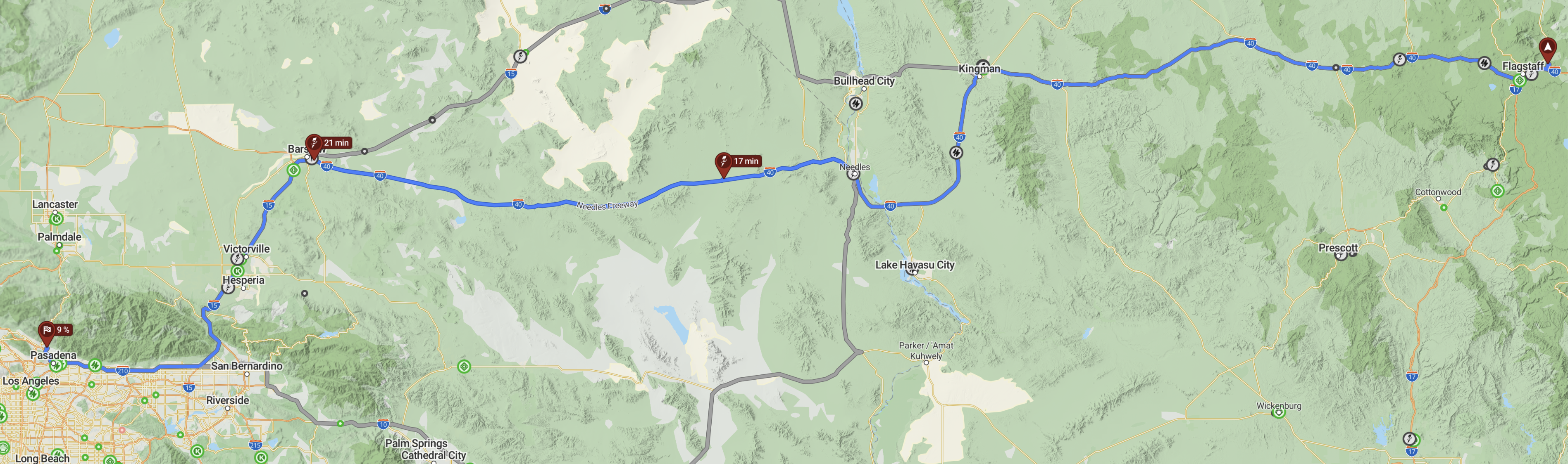

The ABRP route planner suggests it takes about 8 hours, but it’s conservative. It’s conservative for good reason, but its conservative models mean people assume take that as gospel and that you can’t do better than their model.
Even so, there are two short stops in ABRP, and if I wanted I could reduce it to one stop. Notice the large distances between charging stations along most of the route. The longest distance between chargers is 122 miles and they are highlighted as the two stops in the map below. Between those stops is also where the winds are the worst and there’s a lot of elevation loss and regain and loss. I don’t usually stop at the 17 minute stop; I usually stop earlier because I like good food for lunch and the indicated stop doesn’t have decent food. I also like clean restrooms, and that stop doesn’t have clean restrooms.
