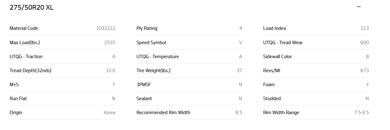

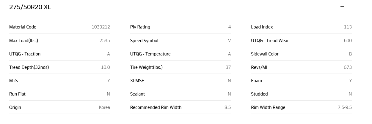

Also, I read a lot of reports of other owners having poor experiences with the Kuhmo Crugen HP71 tires not lasting. So despite those being the cheapest replacement, I opted to replace them with Hankook iON Evo's that cost a bit more. Partially because of the reputation/etc, but also partially because of the whole "once bitten twice shy" sort of thing.

Going from tread wear warranties, the Hankooks would still cost more per mile, but I've seen a lot more reports of those actually reaching close to, or their actual tread wear warranty (which matches up with their expected tread wear rating, as its UTQG - Tread Wear is 600, vs 500 for the Kumhos).
