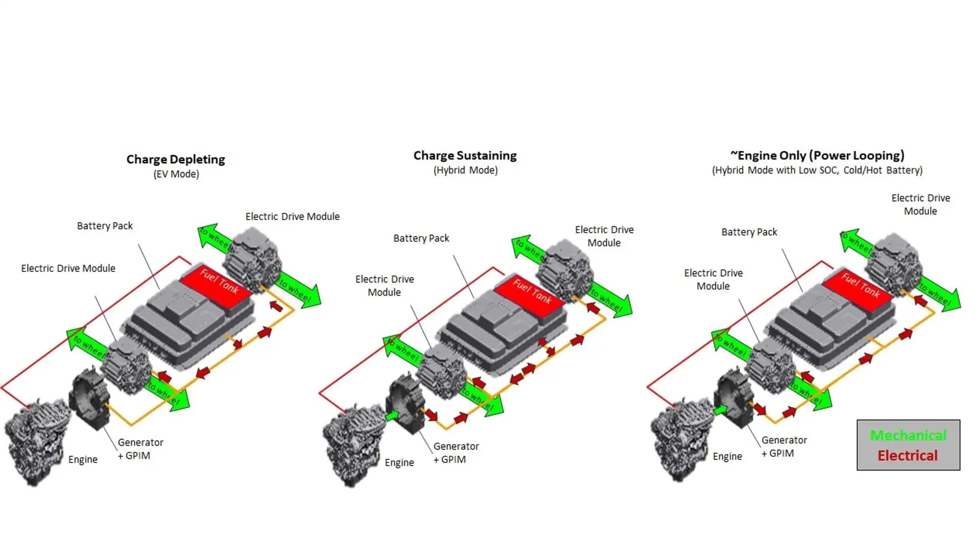

This diagram indicates what some of us have been saying...that the generator supplies electricity directly to the drive motors, so it doesn't just "recharge the battery"
That's for the Ramcharger though. People claiming it will only charge the batteries were claiming that for the Harvester. Based on the simplified marketing that Scout is presenting.
But yes, the Harvester will work like this as well. They all do.
It's nearly impossible to "only charge the batteries", unless you drive until your run down the batteries, and then park it while it "charges the batteries". It's just an unfortunate marketing simplification that Scout is using, that some people are taking literally.

That has never been stated so it’s hard to just assume that. To date, every time Scott talks about it the generator charges the battery. Until they give final distinctions I will wait to see what is legit and what isn’t.
I guess it is semantics. This is a completely electric power train. If charge is fed to the battery at the same time that a load is applied - then sure, the charge is effectively bypassing the battery and directly connected to the motor controller. But I still think it is easier to think of this as a generator charging the battery, and the question is weather or not the charge exceeds the load at any given point in time. The Ram is being designed so that is normally the case. The Scout appears to be designed with a more balanced and economical approach - targeting steady state under normal usage as opposed to targeting steady state under all but the most extreme maximum load (hard acceleration at max towing capacity).
It isn't hard to assume that at all. It's essentially a requirement that generator must be able to send power directly to the motors directly. It's just how series hybrids work, and must work to be practical.
It's only unfortunate marketing speak that is convincing people otherwise.
That's not how it works. There is nothing incidental about this. They aren't passively connected to each other with overflow going to the motor. They aren't even the same type of power the motor uses AC vs the batteries are DC.
The battery is not the central component. The inverter is. All power flows go through the inverter.
Generator output (AC) will be fed into the inverter where it will be conditioned and portioned out. Computers deciding exactly how much power goes to the battery for charging ( 0-100% as DC voltage) and how much goes to the motor (0-100% as AC Voltage).
In cases of high demand 100% will go to the wheel motors, and additional will be added from the batteries. Obviously NOT possible while the batteries are charging only.
