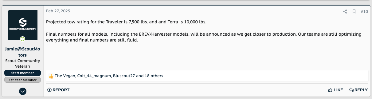

Yes, there have been many threads about this already.
This is Scouts official response to the concerns about towing ratings.
They are aware that we are concerned about it.
