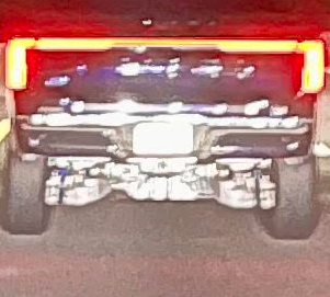

Last night I was driving behind a Ford Lightning and realized how little ground clearance there is due to the motor and battery. The underbelly of the Lightning is rather unsightly, and has 8.4" of ground clearance. I'm not sure I would want to be driving this thing through some of the dirt mountain gaps we have here in March or April during the freeze / thaw. We can see ruts that are easily a 6-12" deep, which would put those motors in some precarious positions.

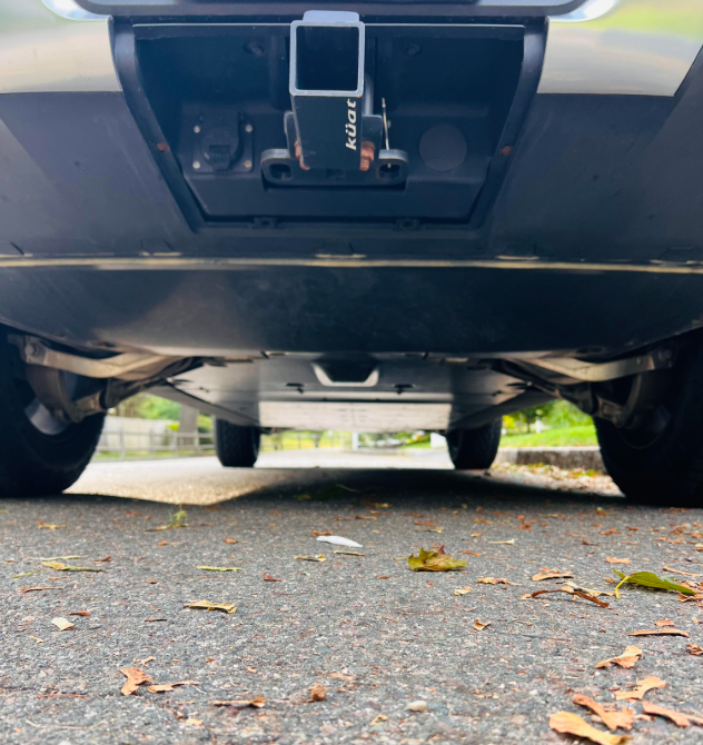

One thing I love about the Rivian is the completely flat underbelly with the skateboard platform. Even the lower control arms are tucked up and in, so you get a wide, flat swath of clearance between the tires.
I snapped a photo of the Lighting I was driving behind last night for reference:

By contrast, this is the underbelly of my R1T. With Air, my max clearance is up to 14.9" (I rarely use max height but it is good to know that it is there when needed):

With the bottom being flat like that does it keep dirt etc out? Have you seen any rust underneath?
There's nothing to rust on the underbelly - the flat bottom that is exposed to the road is a carbon fiber composite material. The reinforced shield consists of layers of high strength steel, aluminum and carbon fiber. I added the reinforced underbody shield with the launch edition. I believe the shield is now bundled and included in the gen2 "off-road package".
One of the biggest complaints I have about the Lightning is the poorly-designed underbelly. If it were flat and continuous, the truck could have an efficiency at least 10% better than it is now.
The Lightning was never advertised as an off-roader. The relatively low clearance is a compromise I was fine with given my needs for the truck. I couldn't give up the bed length nor the extra $20k.

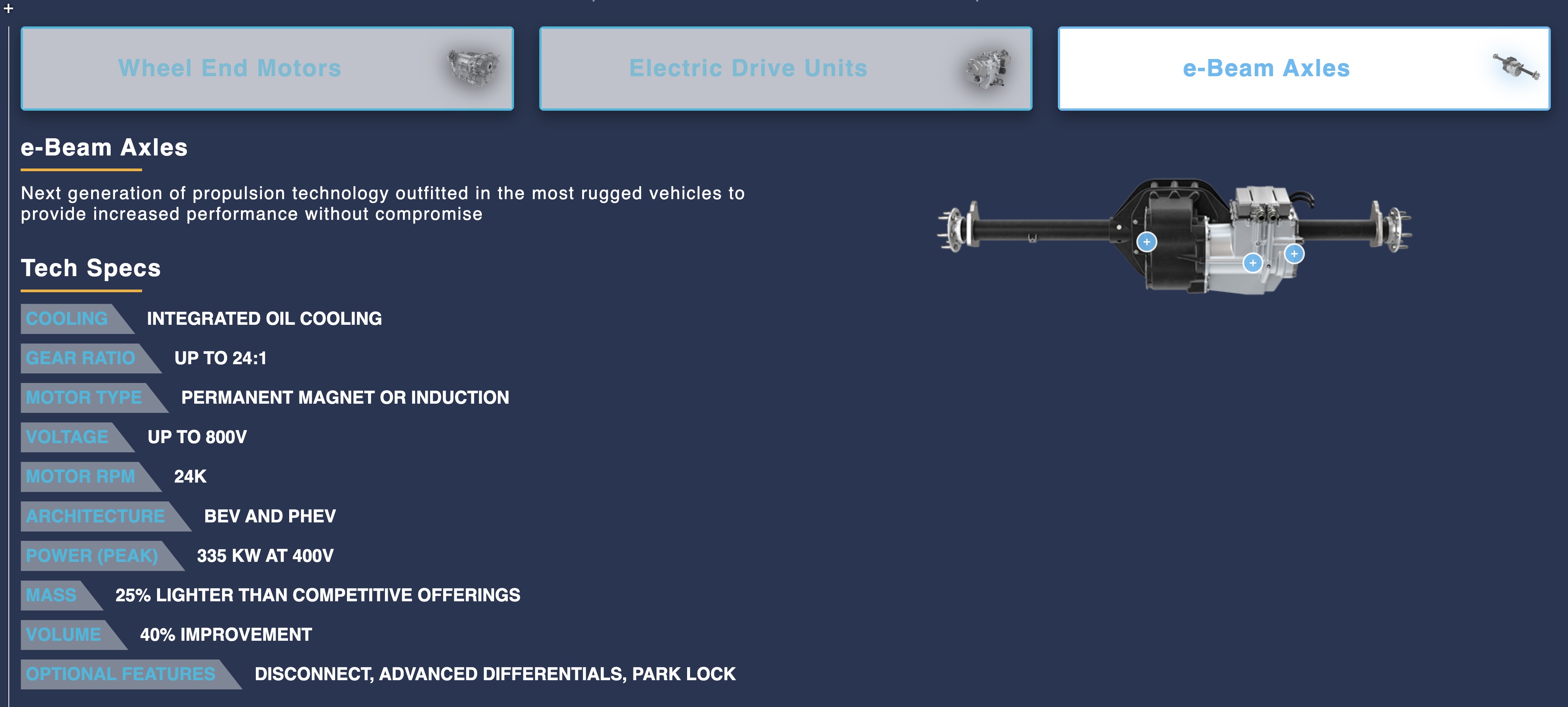

Not that my experience counts for much, but I’ve never seen an ebeam axle with the support linkage necessary for a Watts-link. I’m certain the cast aluminum could be recast with the necessary bits, but it would be custom and not COTS. Obviously do-able, but might be more expensive.
Interesting. Are most of them aluminum? I thought most traditional straight axles were various flavors of steel and cast iron.
Reactions: SpaceEVDriver
The center housing with the motor, differential, and (sometimes) inverter is generally aluminum. As far as I know, American Axle—the brand Scout has said they will be using—uses an all aluminum housing and it includes the inverter in the assembly for their ebeams. I believe that aluminum housing is then mated with steel axle housings for the rest of the beam.
Poor example image here:
