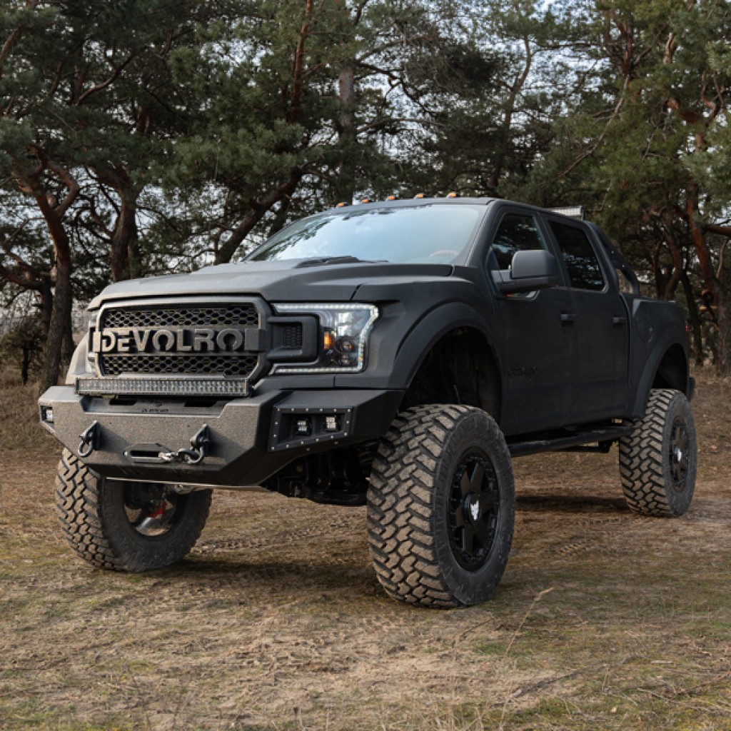

The cost of a set of portal axles for the F-150 (not the Lightning) is $25k.
I can only imagine what the cost would be for new development for a Lightning.
That’s way more than I’m willing to pay.

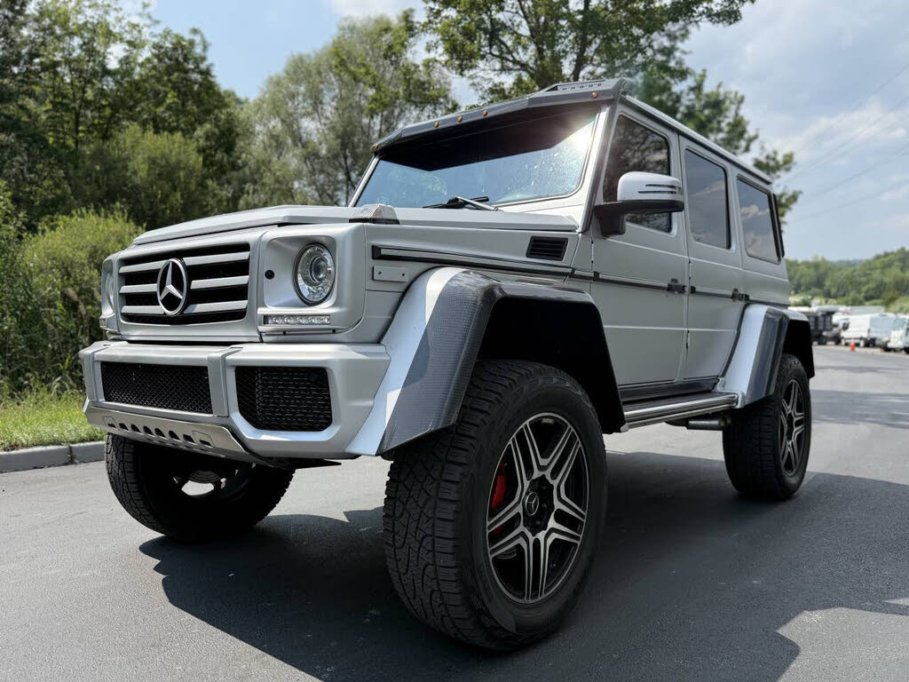

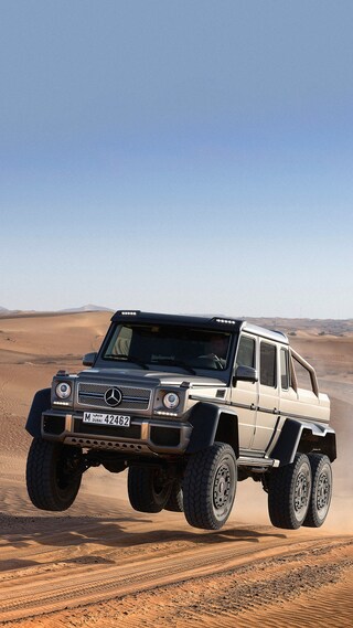

Don’t forget the AMG G 63 4x4^2 and the 6X6 have factory portals too.
They will also make your wallet prolapse.
This used one is a bargain at $130k

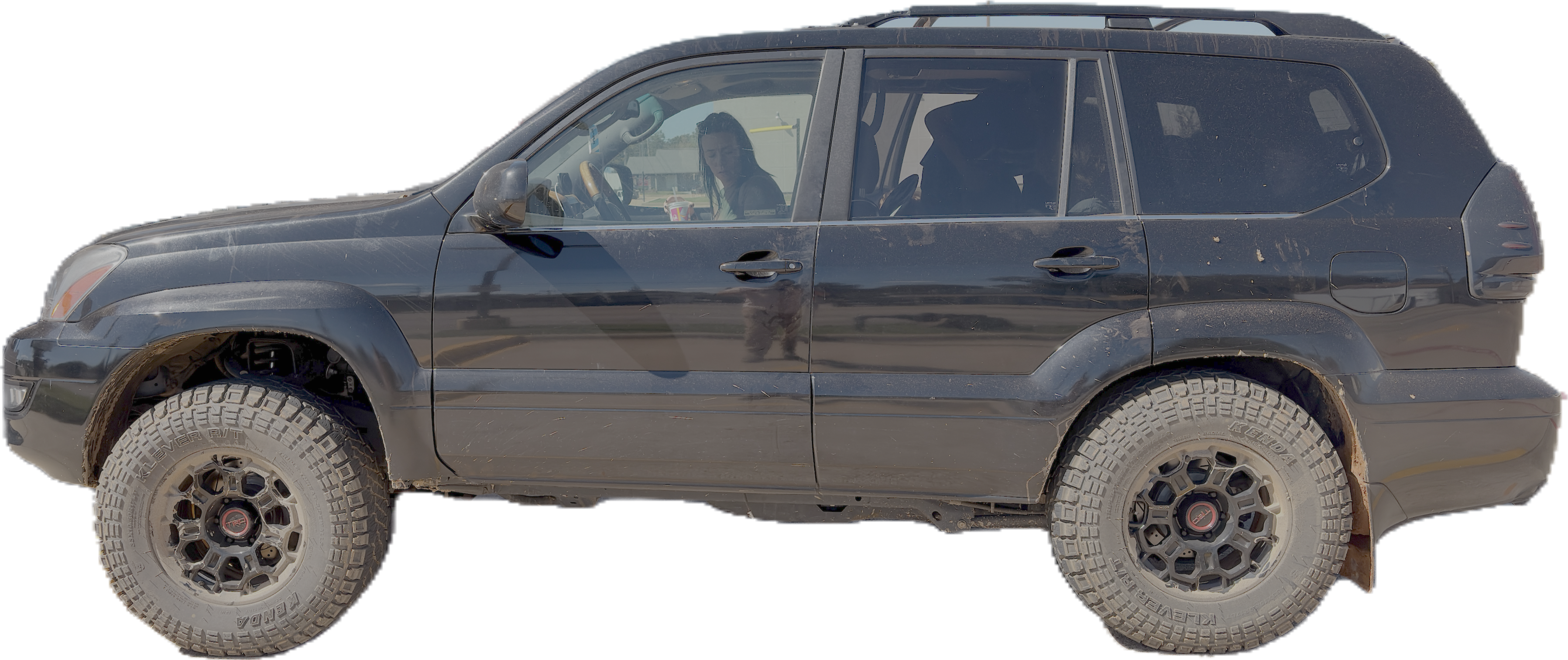

Time for me to eat crow.
Failed at 213k miles and over 20 years of exposure to the elements. A little abuse sprinkled in there.
I went off-roading this weekend and finally blew a factory air bag. It was loaded down with 7 people and some provisions.
Was climbing up a very steep incline with a substantial rock shelf about halfway up the hill, and slammed the rear down pretty hard on it.
Pfffffft and that was all she wrote 😂
Rode home on the bump stops.
Have a new set coming for $85 and they arrive Wednesday.
The factory bags were overextended by about 2.5” after I shimmed the leveling arms for the last 30k miles.
My buddies were all trying to bully me into getting a rear coil conversion and some long travel springs and shocks. I was looking at around $800-$1,200 for an entry level mid-travel setup. Real long travel for the front and rear is around $10,000. Woof!
The buddy that Dana 60 swapped his GX470 was offering me his fully decked out long travel kit that he ran before solid axle swapping it. Links. Dobinson MRR long travel shocks and progressive coil. All for dirt cheap. But I am going to stick to the airbags.

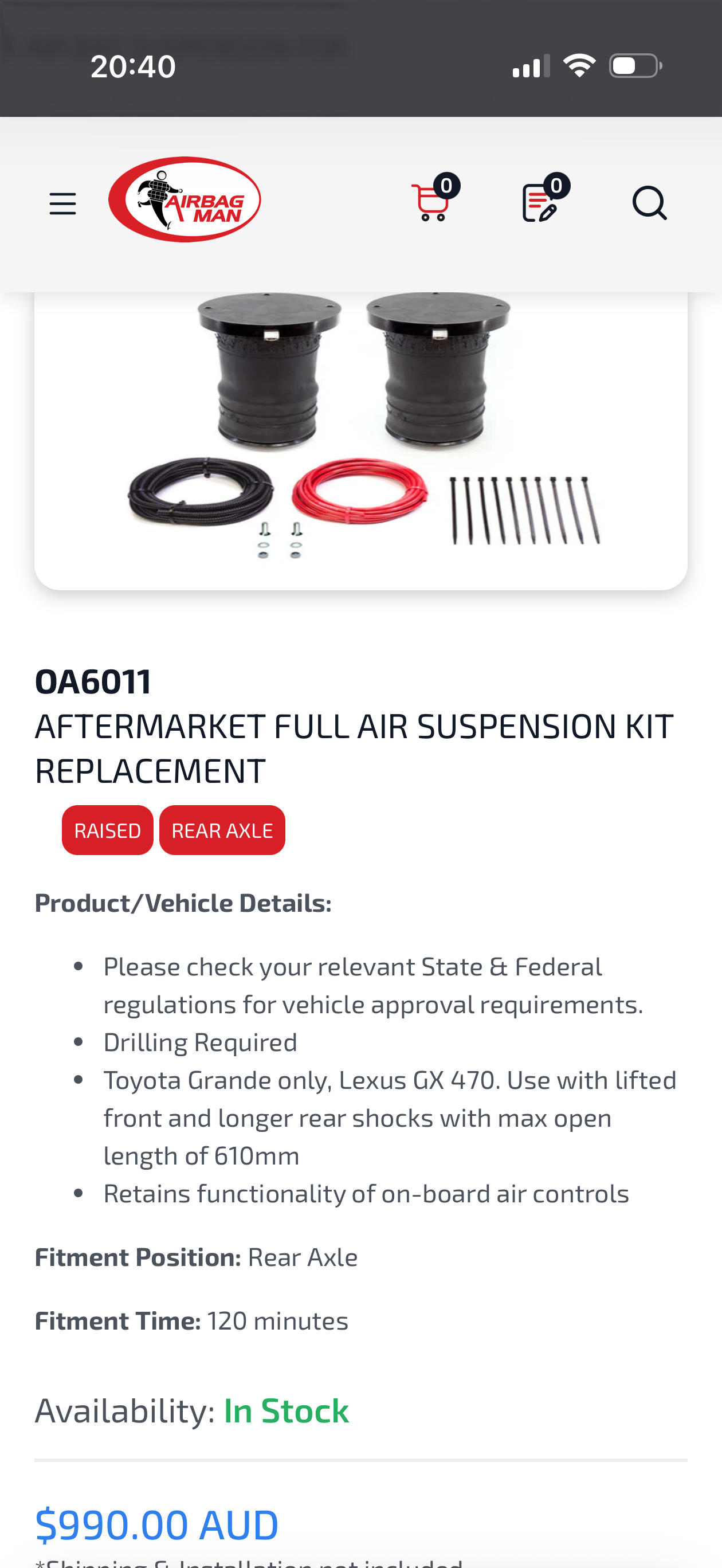

Contacted several vendors today but couldn’t get long travel bags through any of the Land Cruiser boutique shops.
Ended up emailing AirBag Man in Australia directly and they are going to give me a quote to drop ship them to me here in Texas because there are currently no vendors in the US that offer them. They make “raised height” air bag kits that will work with my mid travel Dobinsons shocks.
I’ll use the over extended factory height bags again until they arrive.
They typically use Firestone airbags in many of their kits, which are the same type you’ll find on buses, semis, etc. So I should be able to source replacements domestically once I figure out what they use and if they are modified.

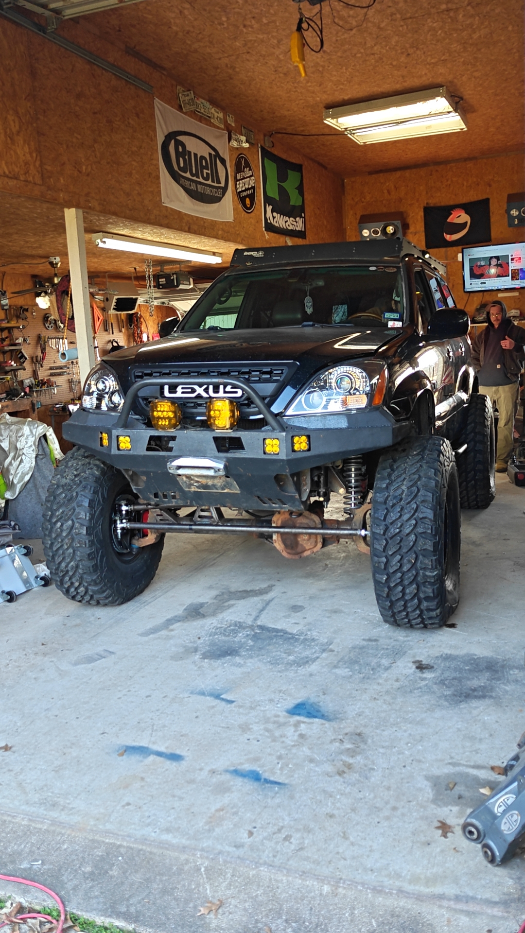

Where’d you go to? You’re down south right? I’d love to see that SAS GX it’s probably a tank. My buddy had an FJ I was pushing him to one ton swap but he got rid of it for an LS swapped 80 series. Can’t blame him there
Barnwell Mountain in Gilmer Texas. Great place. Spoiled by living so close to it.
His GX is nuts. I’m sure he would be glad to take you out for a spin in it.
Can’t blame him either, those things are monsters with an LS.
