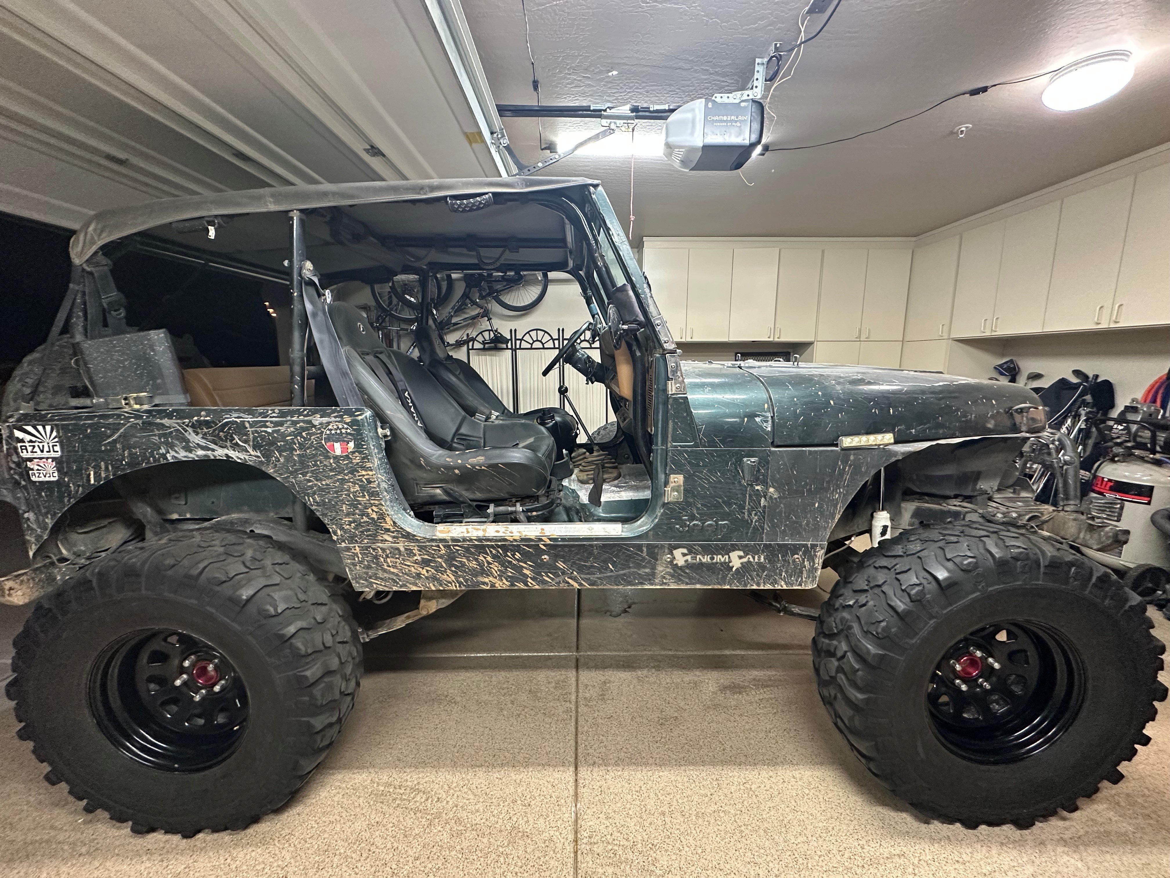

My '93 Wrangler came from the factory with 29" tires lol. When I bought it about 13 years ago, it had a 3.5" lift and 33s with extended bump stops and factory fenders and fender flares. When I put 35s on it, I moved to a 5.125" suspension lift + 1" body lift, and went back to factory bump stops to provide maximum uptravel. To accommodate the uptravel, I had to cut the front fenders completely off, and remove a lot of sheet metal from the rear quarter panels to create a teardrop shape. Basically just short of a comp cut which I think is ugly and don't want to do.
About 2 months ago, I put on 2" wheel spacers and finally moved up to 37s. Even with all the added clearance, they will jam all the way up into the fenders under maximum articulation. Here's what it looks like now. I can't cut the front anymore because there's nothing left to cut, and I don't want to comp cut the rear, so I have decided to add the extended bump stops back in.
Anyway, yeah, cutting is definitely a thing. I sure wouldn't do it to my newer vehicles though, and I definitely wouldn't do it to my (future) Scout.

Looks like FUN!
