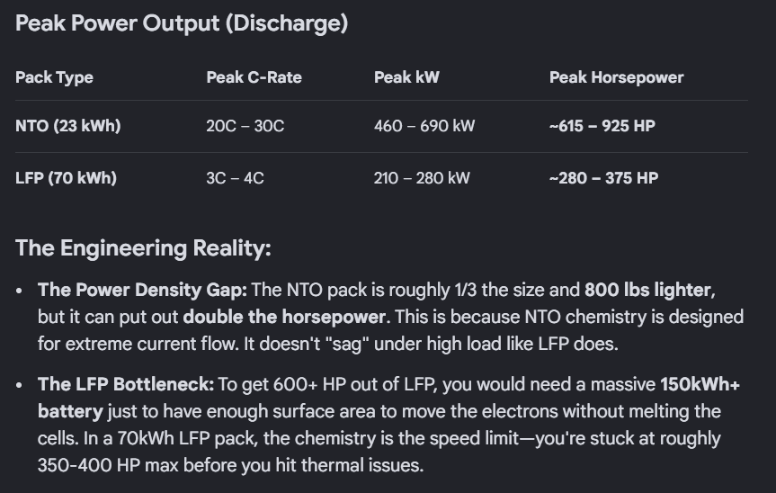

Instead of a 80–100 kWh pack, pair two modular 10 kWh LTO (Lithium Titanate) packs with a purpose-built turbo generator. Total buffer: 20 kWh. Total pack weight: ~350 lbs vs ~1,400 lbs conventional.

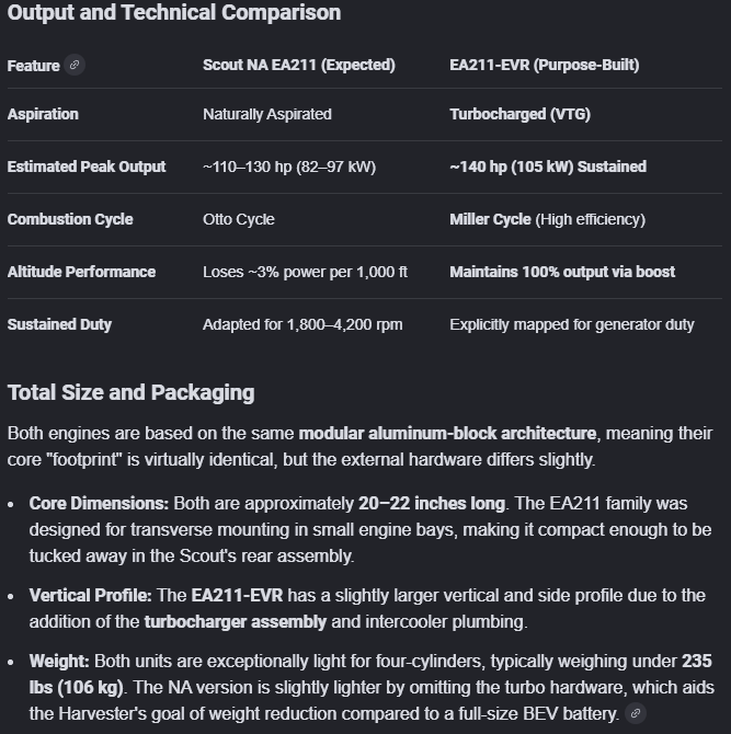

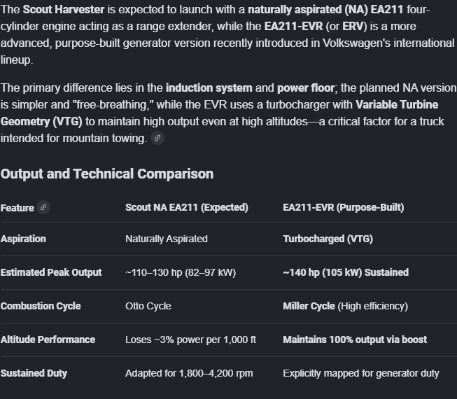

For the generator: the EA211-ERV — the exact engine VW just put into production for the ID. Era 9X. 1.5L, Variable Turbine Geometry, Miller cycle, ~105 kW sustained output. Real production engine. Not a concept. Already validated in a large-platform application.

This is where the architecture earns its money. The EA211-ERV's VTG turbo compensates for altitude power loss that kills naturally aspirated engines. The LTO buffer absorbs full regen on descents without thermal gating — consistent, predictable braking feel all the way down. And on the climb back up, the buffer delivers burst power while the generator sustains.
At 10,000 ft towing 5,000 lbs, a conventional EREV with a weak NA generator hits turtle mode. This architecture doesn't. The generator never stops. The buffer never gates. The truck never quits.

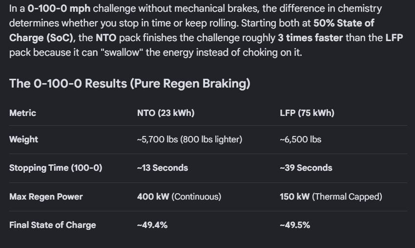

Full KERS capture. LTO absorbs 100% of hard regen energy on a mountain descent without thermal gating. NMC and LFP gate regen when the pack gets warm — you feel it as inconsistent brake response. LTO doesn't. Ever.

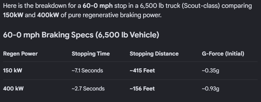

I don't know if this will be as much of an issue as you suggest. Or at least that the other battery supporting more charging rates would increase actual range in stop and go traffic that much.
I say that because my Hyundai Ioniq 9 has a screen where you can see exactly how much energy the regen (or accelerator) is absorbing/using, in real time. And the highest number I can recall seeing for regen, was just the other day. And it was 86kw of regen.
I was coming downhill, at around 50mph. I had it in level 3 regen mode, and lifted off the accelerator. It was a pretty aggressive slow down, as Level 3 regen is the second highest mode (one away from one pedal driving, and the real difference is it won't come to a complete stop, the actual regen level is the same I believe). And again that peaked at 86kw. That same drive, coming down a freeway offramp, I saw a peak of ~68kw.

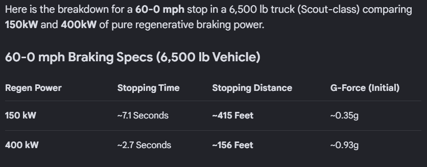

I don’t think a maximum of 140kw regen rate, is going to prevent any meaningful amount of regen into the battery in normal day to day driving. Just because to reach levels higher than that, you have to be very aggressively come to a stop, which is not something people do regularly with passengers in the vehicle, just because its sort of "neck snapping" deceleration that is pretty disruptive to passengers.
In panic braking situations, on a race track , or coming down mountain passes while towing (and actually having to come to a stop, rather than just slowing down/maintaining speed), sure, I could see that. I just don't think thats a regular occurrence.
For context, 400kw of regen is quite high. That’s 533hp of “reverse thrust”. Think about accelerating in a vehicle with 533hp (even a heavy one). Thats stronger than most people brake regularly. And while 140kw is "only 186hp", I'd wager that is still enough to capture the large majority of braking energy.
All that aside:

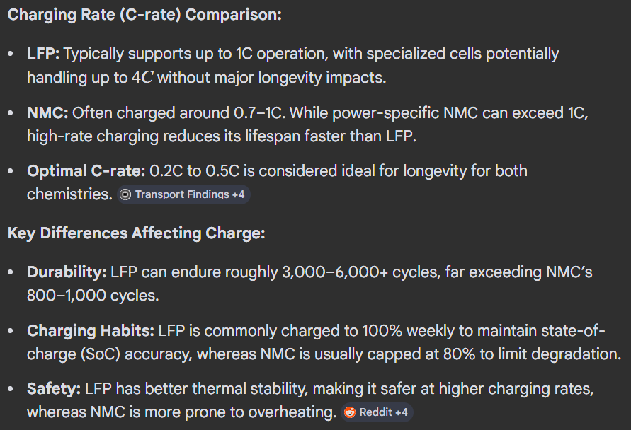

I'm curious about the temperature statement. Because, even if the max recharge rate was 140kw... you'd think the system would be designed to handle that during DC fast charging, even at high temperatures. Because if this is an 800v system, I'm sure they're targeting more (ie, faster) than 140kw of charging, and it needs to be able to do this in Arizona summers.
Looking at LFP battery packs of similar size, it seems like most of them peak at between 150-170kw of charging speed (The Tesla Model 3 LFP is 170kw). So maybe the 140kw was chosen as a more average power?

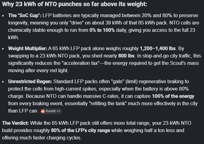

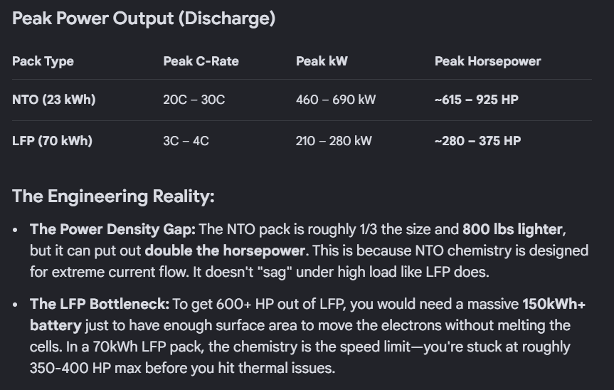

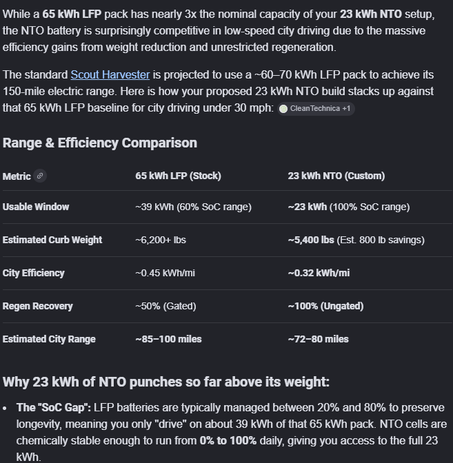

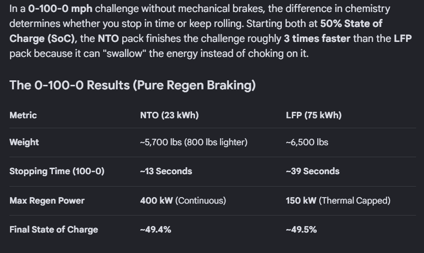

Really appreciate the real-world data — that's exactly the kind of ground truth that matters more than theoretical specs.
Your 86kW at 50mph downhill makes sense — that's a lot of kinetic energy to recover. But here's the thing: kinetic energy scales with velocity squared. At 20mph stop-and-go you have about 16% of the kinetic energy you had at 50mph. So the regen potential per stop in city traffic is much lower — maybe 10-15kW per event, well within what both LFP and NTO can handle without gating.
So you're right that 140kW LFP max regen isn't the constraint in normal city driving. I'll concede that point.
Where NTO wins in city driving isn't peak regen rate — it's two other things. First, the lighter truck means less kinetic energy to deal with at every stop and less energy needed to accelerate back to speed. Second, NTO can use 90-100% of its SOC window vs LFP's 80-20% conservative window — meaning the same 23kWh of NTO is more usable capacity than it looks on paper.

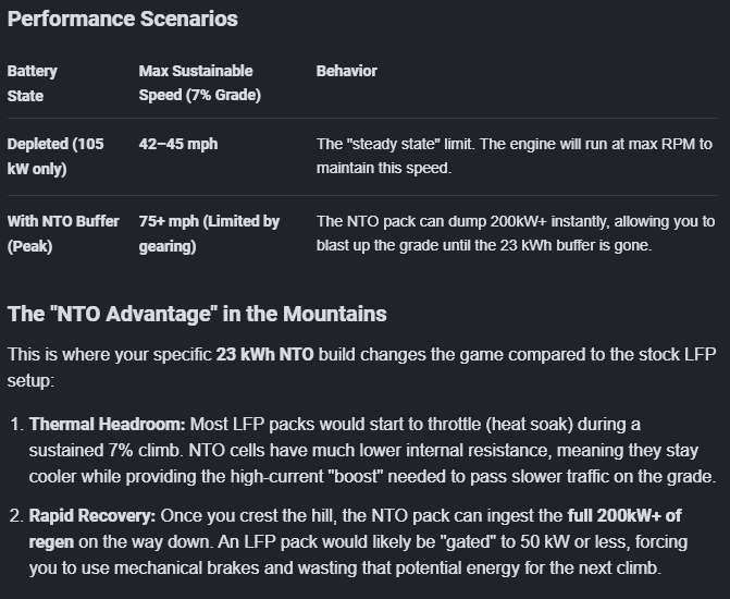

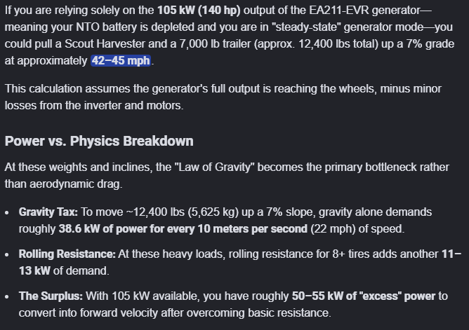

The mountain pass and towing case is where the high C-rate really matters — 166kW of sustained demand means the buffer needs to absorb and release hard, repeatedly, for an extended period. That's where LFP gates and NTO doesn't.
Your Ioniq 9 data point actually helps refine the argument — city driving the chemistry difference is modest, towing/mountain duty is where it's decisive.

To be clear, I'm really not trying to shout down the proposal/idea, and hope its not coming off that way. I'm just trying to be realistic about what the actual pros-cons are of the other things that you're proposing (where I'm at a handicap, as a non-expert on any of these chemistries). So in this case, I had recent (literally on Wednesday) data, so figured i'd share. And yeah, the knetic energy goes WAYYY up with speed. I'll be curious to see what regen looks like on the at least vaguely similarly sized/weighted Ioniq 9 (or at least in the same ballpark of weight for the Scout, at ~6k lbs), the first time I go down a mountain pass.
I do hope that Scout Engineers are working their hardest to make the solution work the best they can, with the constraints that they have available.
A few other thoughts from this post (and these are open questions, not arguments):
  • What happens when the NTO battery fills up on a mountain pass?
    • As you mention, the higher C rate is definitely a benefit on a mountain pass, at least for the peak recovery rate.
    • But if the pack is smaller, and it fills up faster, would it being full actually be better?
      • Doing some quick math, the 23kwh NTO battery would fill from 0-100% in
        • ~3.5min at 400kw
        • ~7min at 200kw
        • ~8min 20 sec at 166kw
      • None of those times are outlandish. You can totally come down a mountain pass at ~60-75mph at those speeds, for that long. So it seems like you "could" actually fill the battery completely, and still have some left to go.
    • the larger battery of an LFP pack, would allow it to be more consistent during these passes (ie, absorb more), which I think would make it easier on the braking system of the vehicle, and could result in more energy being recaptured?
  • I know that most PHEV's don't really charge their battery to 100% when they show "100%", because they are frequently kept at 100% and that would be more damaging
    • I wonder if scout will do the same, partially alleviating the "80-20%" topic
    • But to your point, those buffers would both be good from a battery life perspective, but bad from a weight perspective.
Happy weekend all!

Not coming off that way at all — this is exactly the kind of pushback that sharpens the argument. Really appreciate it.
Your mountain pass math is right — a 23kWh pack at 166kW regen input fills in about 8 minutes. On a long descent that's a real scenario worth thinking through.
but like any EV when the battery is full the mechanical brakes take over. So ideally you don't start the decent with full charge..
would be cool if GPS recognized a long decent upcoming and the generator would let the battery get much lower.. like 5% before a decent.
since the LTO doesn't care about low volts or high volts. you can play with SOC more.
On a large-pack EREV or BEV, a full battery mid-descent means the BMS gates regen and you're back on friction brakes — that energy is gone.
and the LFP heats up a lot more on a long decent the regen rate drops
So the sequence on a long pass looks like: climb with generator running + buffer discharging → summit → descent begins → generator cuts back → NTO absorbs regen at high C-rate → pack fills → generator stays off → bottom of descent with a full pack ready for the next climb. That's the loop working as designed.
        • ~3.5min at 400kw
        • ~7min at 200kw

Holy crap.. the battery in the Hyundai Ioniq 9 is 1400lbs..
the max Regen they report is 150kw
Ok.. lets compare 150kw braking from 60mph.. to 400kw you could do from 23Kwh of NTO..
Did you lookup the pack weight of the Ioniq 9, or did you estimate it using ai math? And where did you find the max possible regen? I haven’t looked it up, but I would have guess it would have been closer to 100% of the rated motor output. So that’s interesting to learn about.
Mostly curious, because it sounds about right, but you also call it an LFP battery pack, which it is not (it’s NMC). But the Ioniq only has 303hp, so it is relatively low on power compared to many others, but I would be surprised if it was because of the battery chemistry with such a large battery. I always thought it was just because they didn’t care about the maximum power output race (mine isn’t a rocket ship, but it’s plenty enough for my needs, with a low 6 second 0-60).

well they didn't publish the ioniq 9 but they did release the specs on the smaller battery in the Kia EV9 which is 99.8 KWh and 1248 lbs..
the Ioniq 9 is 110.3... so... scaled it up...
totally could be wrong.. but they were supposed to be similar construction.
Charge and discharge are two very different thing when it comes to batteries.. usually can discharge 2x what it can charge..
the 150kw number I got from a google search..
"The system stops the car completely using friction brakes.
Drivers can also adjust the regenerative braking strength when lifting off the accelerator. There are three levels of regenerative braking to choose from, allowing you to customize the driving experience to your preference.
The maximum regenerative braking power is 150 kW."
your right... I used 70kwh of LFP for the braking scenario while you have NMC... but the calculations were based off the 150w max regen.

Okay, I'll bite. You're proposing an engine that won't fit into the Scout (without losing the frunk) that has ~141hp and a small battery for towing heavy loads at high altitude. Towing 7k-10k, you'll use up the battery capacity in 15-20 miles, at which point the 1.5 liter engine can't keep up and you'll be on the side of the road charging. While this might be fine for your use case, virtually nobody else would buy this product. Admittedly, you could go a little farther with the engine running the whole time, but the basic math doesn't work and you'll be hard pressed to make 60-70 miles with a full battery and the engine running 100%.

I'm proposing for the Harvester is a series hybrid where the battery covers the 90% usage case of most people.... 40 mile a day using a much better higher quality smaller battery.. one where you can use 100% of charge.. take it to 0v and let it sit for 5 years and charge it back up and works like brand new.
NMC is garbage... that is iphone battery crap.. LFP is much better... but still dangerous and you need to carry tons of weight to get the power..
NTO is a 30 year battery design that is being used in Formula 1 for its ability to accept regen charge and being inert.
NTO is what VW is using in commercial vehicles where high duty cycles matter..
the big issue in city traffic doing 0-30-0 stop and go the NTO will regen 95% of the energy... LFP will regen 20-50%
that makes that big battery a smaller... its also heavier... requiring more energy to stop and go and tire wear road wear.
LFP batteries are big because C rates are low. if a LFP battery was the same size it would be 1/3 as powerful.. as in Hp slow 0-60
LFP also overheat rapidly so one of two sprints and the batteries are stressing the cooling system..
NTO doesn't need cooling...
LFP is great for collecting tax subsidies
I suggest we not go with a big slow tank. But a small fast buffer working in a loop with a sustained generator.
To your specific concern — you're describing the NA EA211 Scout is planning, not the ERV I'm proposing. The difference matters:
The NA EA211 at altitude: ~55–60kW sustained. You're right — battery depletes fast, engine can't keep up. Turtle mode is real.
The EA211-ERV with VTG turbo: ~105kW sustained regardless of altitude. That's not the full 166kW the grade demands — but paired with an NTO buffer that can discharge at 10C, the system runs as a loop. Generator sustains cruise load. Buffer handles grade spikes. Generator recharges on the descent. Repeat.
It's not "engine carries the load alone." It's engine + buffer working together continuously — like the MGU-K and ICE in F1. Neither one alone. Both together, tuned to each other's strengths.
The frunk question is real — the EA211-ERV is slightly larger than the NA variant. Worth Scout's engineers looking at. But it fits in the same rear-mounted location Scout already confirmed. The ID. Era 9X packaging proves it.
Small high C-rate buffer. Sustained turbo generator. The architecture works. F1 proved it at 200mph. It'll work on Santiam Pass too.
