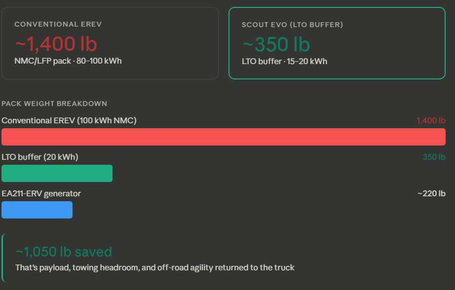

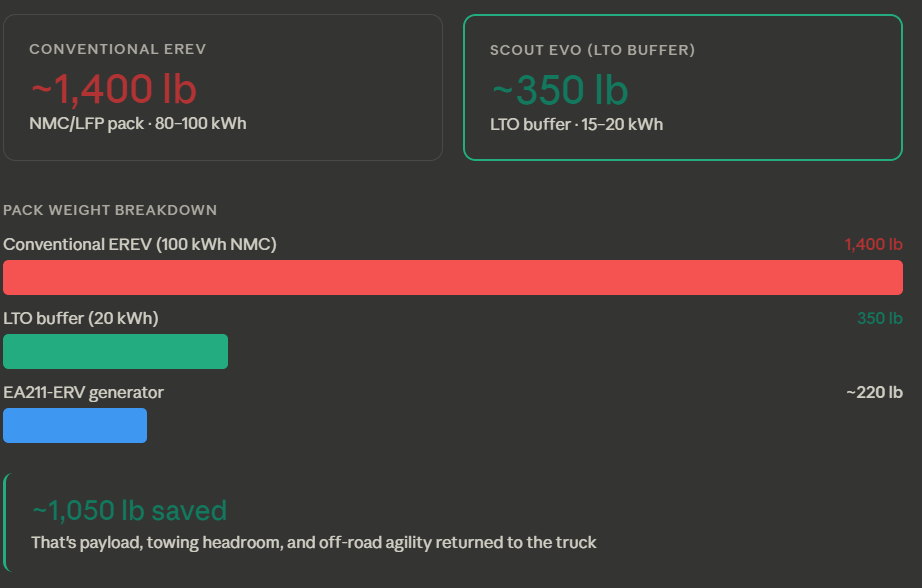

THE PROBLEM: EREVs ARE JUST BLOATED EVs WITH A GENERATOR BOLTED ON
Every current EREV design makes you haul 1,200–1,500 lbs of low-C-rate NMC or LFP just to provide range. That weight spiral kills towing dynamics, destroys payload headroom, and wrecks off-road agility. It's engineering compromise stacked on engineering compromise.
And the cruel irony — you're carrying all that pack weight specifically so the generator doesn't have to work as hard. The tail is wagging the dog.

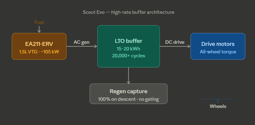

THE PROPOSAL: A HIGH-RATE BUFFER ARCHITECTURE
Instead of a 80–100 kWh pack, pair two modular 10 kWh LTO (Lithium Titanate) packs with a purpose-built turbo generator. Total buffer: 20 kWh. Total pack weight: ~350 lbs vs ~1,400 lbs conventional.
For the generator: the EA211-ERV — the exact engine VW just put into production for the ID. Era 9X. 1.5L, Variable Turbine Geometry, Miller cycle, ~105 kW sustained output. Real production engine. Not a concept. Already validated in a large-platform application.

This is where the architecture earns its money. The EA211-ERV's VTG turbo compensates for altitude power loss that kills naturally aspirated engines. The LTO buffer absorbs full regen on descents without thermal gating — consistent, predictable braking feel all the way down. And on the climb back up, the buffer delivers burst power while the generator sustains.
At 10,000 ft towing 5,000 lbs, a conventional EREV with a weak NA generator hits turtle mode. This architecture doesn't. The generator never stops. The buffer never gates. The truck never quits.

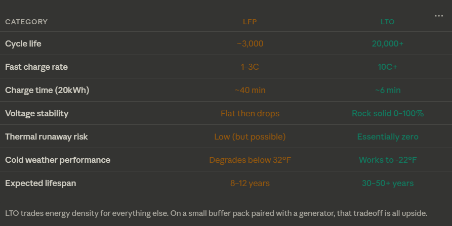

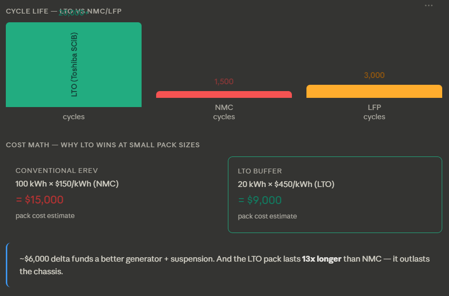

WHY LTO WINS THE LONG GAME

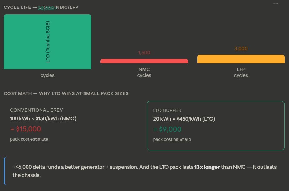

[ INSERT: Cycle life / cost math graphic ]
20,000+ verified charge cycles — Toshiba SCiB production cells. At one full cycle per day that's 54 years. The pack outlasts the chassis by decades.
Full KERS capture. LTO absorbs 100% of hard regen energy on a mountain descent without thermal gating. NMC and LFP gate regen when the pack gets warm — you feel it as inconsistent brake response. LTO doesn't. Ever.
Long term replacement cost. When your 100 kWh NMC pack degrades in year 8–10, you're facing a $15,000–20,000 replacement that may not even be available. With two 10 kWh LTO packs doing 20,000 cycles — that conversation essentially disappears.
Tire life and payload. 1,050 lbs off the chassis is real tire wear reduction over a 15–20 year ownership cycle. Multiple sets of tires. On a truck people actually keep, that math matters.

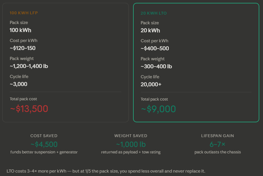

The cost math works. LTO is ~3–4x per kWh vs NMC — but at 20 kWh vs 100 kWh you're buying a fraction of the cells. The delta funds a better generator, better suspension, and still comes out ahead.

I don't know if this will be as much of an issue as you suggest. Or at least that the other battery supporting more charging rates would increase actual range in stop and go traffic that much.
I say that because my Hyundai Ioniq 9 has a screen where you can see exactly how much energy the regen (or accelerator) is absorbing/using, in real time. And the highest number I can recall seeing for regen, was just the other day. And it was 86kw of regen.
I was coming downhill, at around 50mph. I had it in level 3 regen mode, and lifted off the accelerator. It was a pretty aggressive slow down, as Level 3 regen is the second highest mode (one away from one pedal driving, and the real difference is it won't come to a complete stop, the actual regen level is the same I believe). And again that peaked at 86kw. That same drive, coming down a freeway offramp, I saw a peak of ~68kw.
I don’t think a maximum of 140kw regen rate, is going to prevent any meaningful amount of regen into the battery in normal day to day driving. Just because to reach levels higher than that, you have to be very aggressively come to a stop, which is not something people do regularly with passengers in the vehicle, just because its sort of "neck snapping" deceleration that is pretty disruptive to passengers.
In panic braking situations, on a race track , or coming down mountain passes while towing (and actually having to come to a stop, rather than just slowing down/maintaining speed), sure, I could see that. I just don't think thats a regular occurrence.
For context, 400kw of regen is quite high. That’s 533hp of “reverse thrust”. Think about accelerating in a vehicle with 533hp (even a heavy one). Thats stronger than most people brake regularly. And while 140kw is "only 186hp", I'd wager that is still enough to capture the large majority of braking energy.
All that aside:
I'm curious about the temperature statement. Because, even if the max recharge rate was 140kw... you'd think the system would be designed to handle that during DC fast charging, even at high temperatures. Because if this is an 800v system, I'm sure they're targeting more (ie, faster) than 140kw of charging, and it needs to be able to do this in Arizona summers.
Looking at LFP battery packs of similar size, it seems like most of them peak at between 150-170kw of charging speed (The Tesla Model 3 LFP is 170kw). So maybe the 140kw was chosen as a more average power?
Really appreciate the real-world data — that's exactly the kind of ground truth that matters more than theoretical specs.
Your 86kW at 50mph downhill makes sense — that's a lot of kinetic energy to recover. But here's the thing: kinetic energy scales with velocity squared. At 20mph stop-and-go you have about 16% of the kinetic energy you had at 50mph. So the regen potential per stop in city traffic is much lower — maybe 10-15kW per event, well within what both LFP and NTO can handle without gating.
So you're right that 140kW LFP max regen isn't the constraint in normal city driving. I'll concede that point.
Where NTO wins in city driving isn't peak regen rate — it's two other things. First, the lighter truck means less kinetic energy to deal with at every stop and less energy needed to accelerate back to speed. Second, NTO can use 90-100% of its SOC window vs LFP's 80-20% conservative window — meaning the same 23kWh of NTO is more usable capacity than it looks on paper.
The mountain pass and towing case is where the high C-rate really matters — 166kW of sustained demand means the buffer needs to absorb and release hard, repeatedly, for an extended period. That's where LFP gates and NTO doesn't.
Your Ioniq 9 data point actually helps refine the argument — city driving the chemistry difference is modest, towing/mountain duty is where it's decisive.
