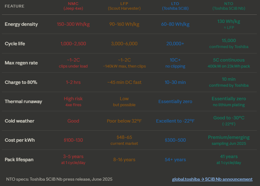

well now I've learned of an even better tweak of chemistry. they bridge the gap between LTO and LFP.
NTO with the SCIB Nb cells... the cells are larger then the 20ah ones I was calculating with before..
I've refined the math with the newest Niobium (NTO) specs. By using just 200 cells (23kWh), we shed 1,000+ lbs of dead weight. We get a 400V architecture that fits in a carry-on suitcase, captures 400kW of regen, and provides 60 miles of range that never degrades. It turns the Harvester from a heavy compliance-tank into a lightweight, indestructible 30-year truck."
But my personal recommendation still stands. using the 20ah packs for the most punch and using the smallest battery to still get the 7.5kWh federal tax credit.
164 cells of 20ah-hp cells - about 200lbs for entire battery enclosure.
400v.
but I get why 20Kwh would probably be the minimum people would want or easy to sell..
Comparison Summary
200-Cell NTO (50Ah)350-Cell LTO-HP (20Ah)
System Voltage~460V~800V
Total Weight~430 lbs~480 lbs (with enclosure)
Energy Capacity23 kWh16.1 kWh
Max Regen Power400 kW665 kW
  • Range: 46–58 miles. Range: 32–40 miles
