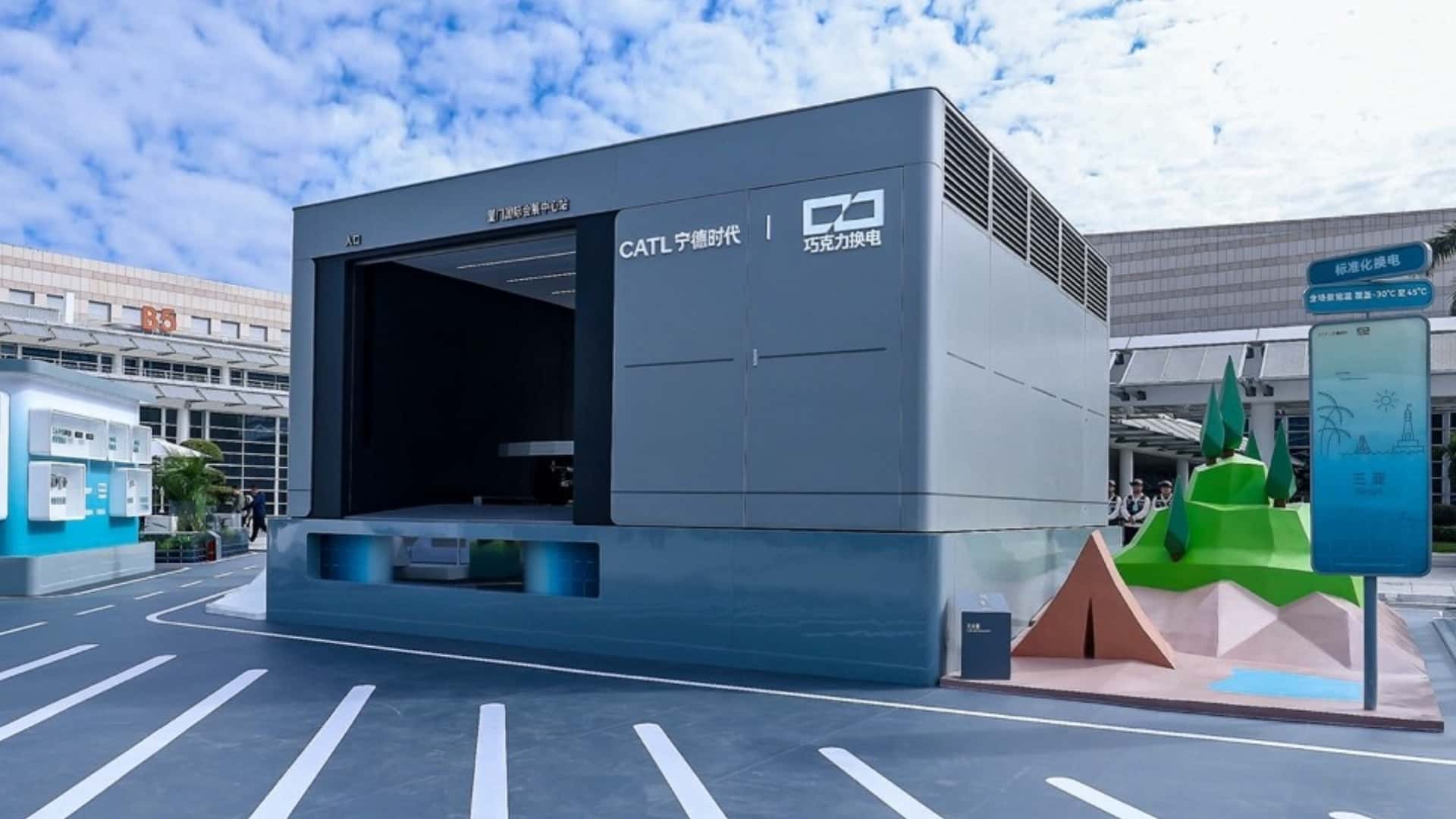

On another related towing/range note. Why do we not talk more about swapping batteries?
I can't imagine this is under consideration by ScoutMotors, but it seems like such a better way to solve range issues vs. ridiculously large and heavy battery packs. In my ideal world, I would maybe have a smaller battery in the car for everyday use that I can charge at home. Say around 50 to 100 kWh. And an slot for battery expansion that I could slot in a battery from a swap station for long-range towing trips.
I can't imagine this is under consideration by ScoutMotors, but it seems like such a better way to solve range issues vs. ridiculously large and heavy battery packs. In my ideal world, I would maybe have a smaller battery in the car for everyday use that I can charge at home. Say around 50 to 100 kWh. And a slot for battery expansion that I could slot in a battery from a swap station for long-range towing trips.
If you search those terms here on the forum you will see there was a lot of discussion some time ago. It’s an interesting read but ultimately it just isn’t practical yet. Check it out though so my thoughts don’t sway you one way or the other 😀

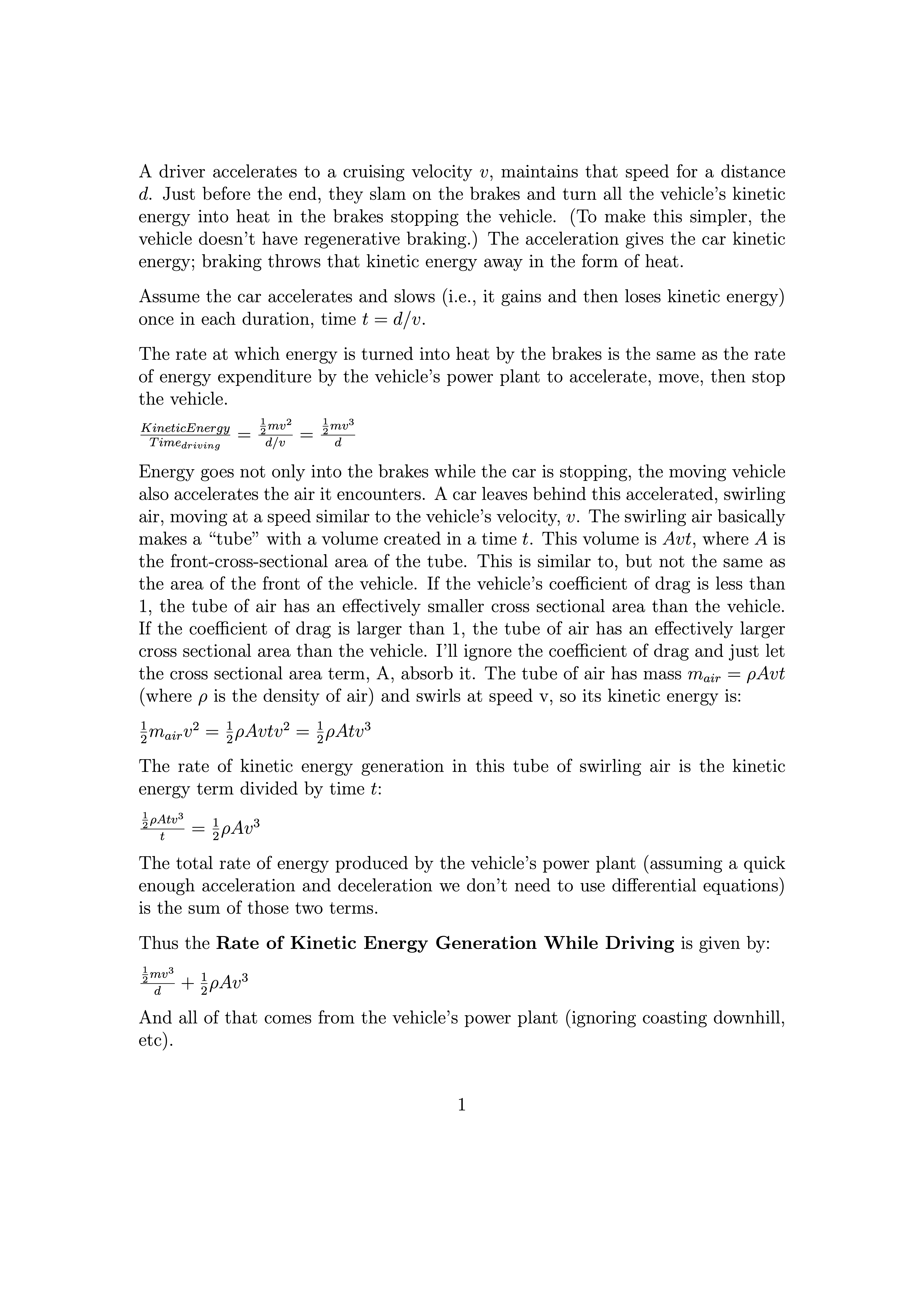

I was trying to consider total energy consumption over a significant drive, say at least 50 miles. The expenditure for drag is constant over the whole distance, linear with distance and squared with speed. The expenditure for K.E. is just to get up to speed, amortized over the whole distance would it not be negligible compared to that for drag? Am I missing something?
Warning: Maths!!! :geek:😱😵‍💫:geek:🤪😜
I thought about hiding everything behind a spoiler, but nah. All you mathophobes can just enjoy it. 😍🤩🥸
I also have to apologize. I was in the car and typing makes me carsick, so I did the bar minimum to give the math earlier and it was both not enough and not quite right.
I can’t get the formatting to work, so I dropped in some screenshots of the slightly-better-formatted text.
Assume a driver accelerates up to a cruising velocity v, and maintains that speed for a distance d, which is the distance between the start and stop locations. At this point, they slam on the brakes and turns all the vehicle’s kinetic energy into heat in the brakes stopping the vehicle. (To make this simpler, the vehicle doesn’t have regenerative braking.) The acceleration gives the car kinetic energy; braking throws that kinetic energy away in the form of heat.
Assume the car speeds up and slows (i.e., it gains and then loses kinetic energy) down once in each duration,
time t = d/v.
The rate at which energy is turned into heat by the brakes is the same as the rate of energy expenditure by the vehicle’s power plant to accelerate, move, then stop the vehicle.
Kinetic Energy 0.5*m*v^2 0.5*m*v^3
time between braking events d/v d
Energy goes not only into the brakes while the car is moving, the moving vehicle also makes air swirl around. A car leaves behind swirling air, moving at a speed similar to v.
The swirling air basically makes a “tube” with a volume create in a time t. This volume = A*v*t, where A is the front-cross-sectional area of the tube. This is similar to, but not the same as the area of the front of the vehicle. If the vehicle’s coefficient of drag is less than 1, the tube of air has an effectively smaller cross sectional area than the vehicle. If the coefficient of drag is larger than 1, the tube of air has an effectively larger cross sectional area than the vehicle. I’ll ignore the coefficient of drag and just let the cross sectional area term, A, absorb it. The tube of air has mass m_air = ρAvt (where ρ is the density of air) and swirls at speed v, so its kinetic energy is:
0.5 * m_air * v^2 = 0.5 * ρ * A * v * t * v^2 = 0.5 * ρ * A * t * v^3
The rate of kinetic energy generation in this tube of swirling air is the kinetic energy term divided by time t:
——————————————————— = 0.5 * ρ * A * v^3
t
The total rate of energy produced by the vehicle once it’s started moving, driven, and then stopped (assuming a quick enough acceleration and deceleration we don’t need to use differential equations) is the sum of those two terms.
0.5*m*v^3
Rate of Kinetic Energy Generation while driving = ————————— + 0.5 * ρ * A * v^3
d

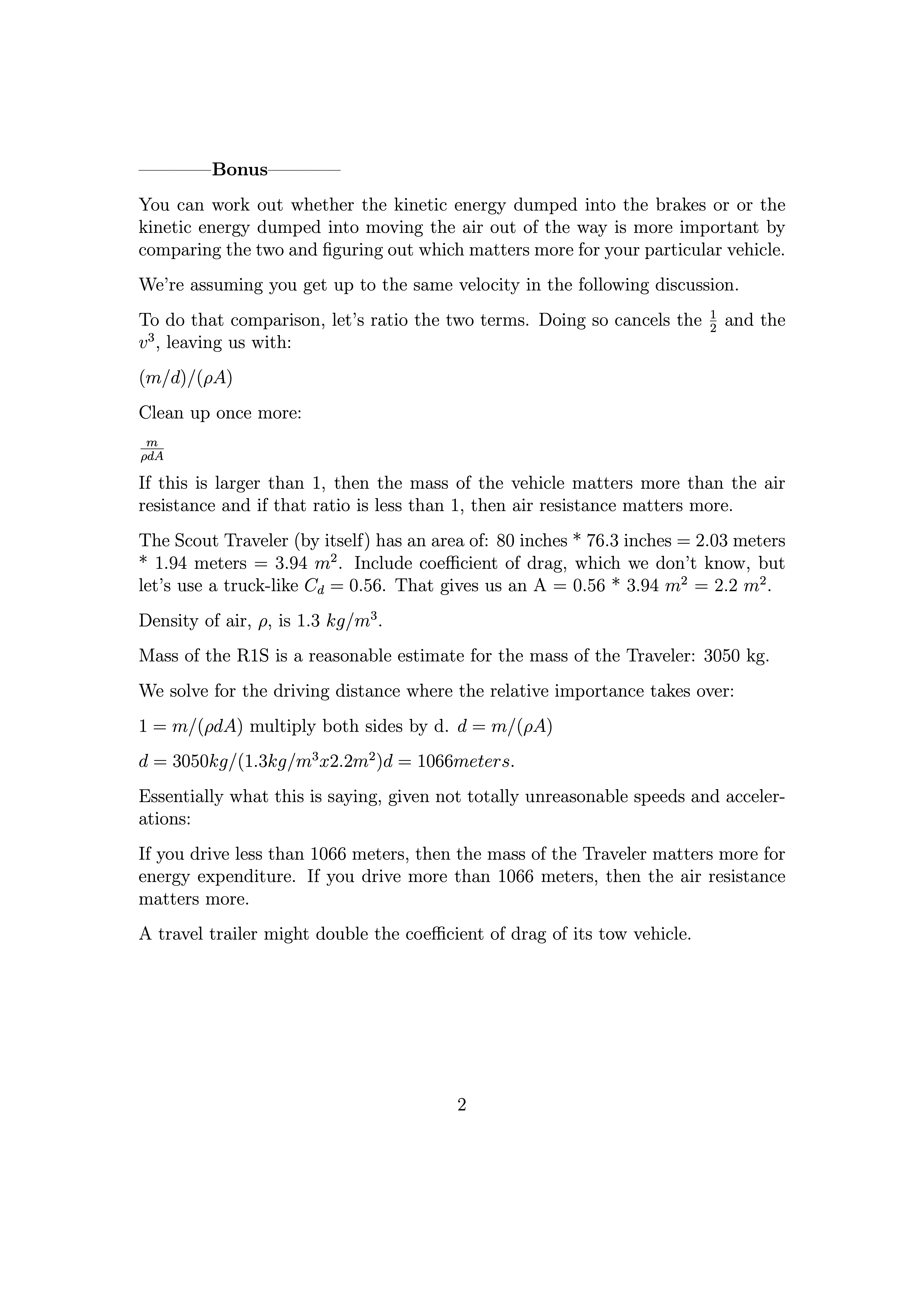

—Bonus—
You can work out whether the kinetic energy dumped into the brakes or or the kinetic energy dumped into moving the air out of the way is more important by comparing the two and figuring out which matters more for your particular vehicle.
We’re assuming you get up to the same velocity in the following discussion.
To do that comparison, let’s ratio the two terms. Doing so cancels the 0.5 and the v^3, leaving us with:
(m/d) / (ρA)
Clean up once more:
m / ρdA
If this is larger than one, then the mass of the vehicle matters more than the air resistance and if that ratio is less than 1, then air resistance matters more.
The Scout Traveler (by itself) has an area of: 80 inches * 76.3 inches = 2.03 meters * 1.94 meters = 3.94 m^2.
Include coefficient of drag, which we don’t know, but let’s use a truck-like Cd = 0.56. That gives us an A = 0.56 * 3.94 m^2 = 2.2 m^2.
Density of air, ρ, is 1.3 kg/m^3.
Mass of the R1S is a reasonable estimate for the mass of the Traveler: 3050 kg.
We solve for the driving distance where the relative importance takes over:
1 = m/(ρdA)
multiply both sides by d.
d = m / (ρA)
d = 3050 kg / (1.3 kg/m^3 * 2.2 m^2)
d = 1066 meters.
Essentially what this is saying, given not totally unreasonable speeds and accelerations:
If you drive less than 1066 meters, then the mass of the Traveler matters more for energy expenditure. If you drive more than 1066 meters, then the air resistance matters more.
A travel trailer might double the coefficient of drag of its tow vehicle.

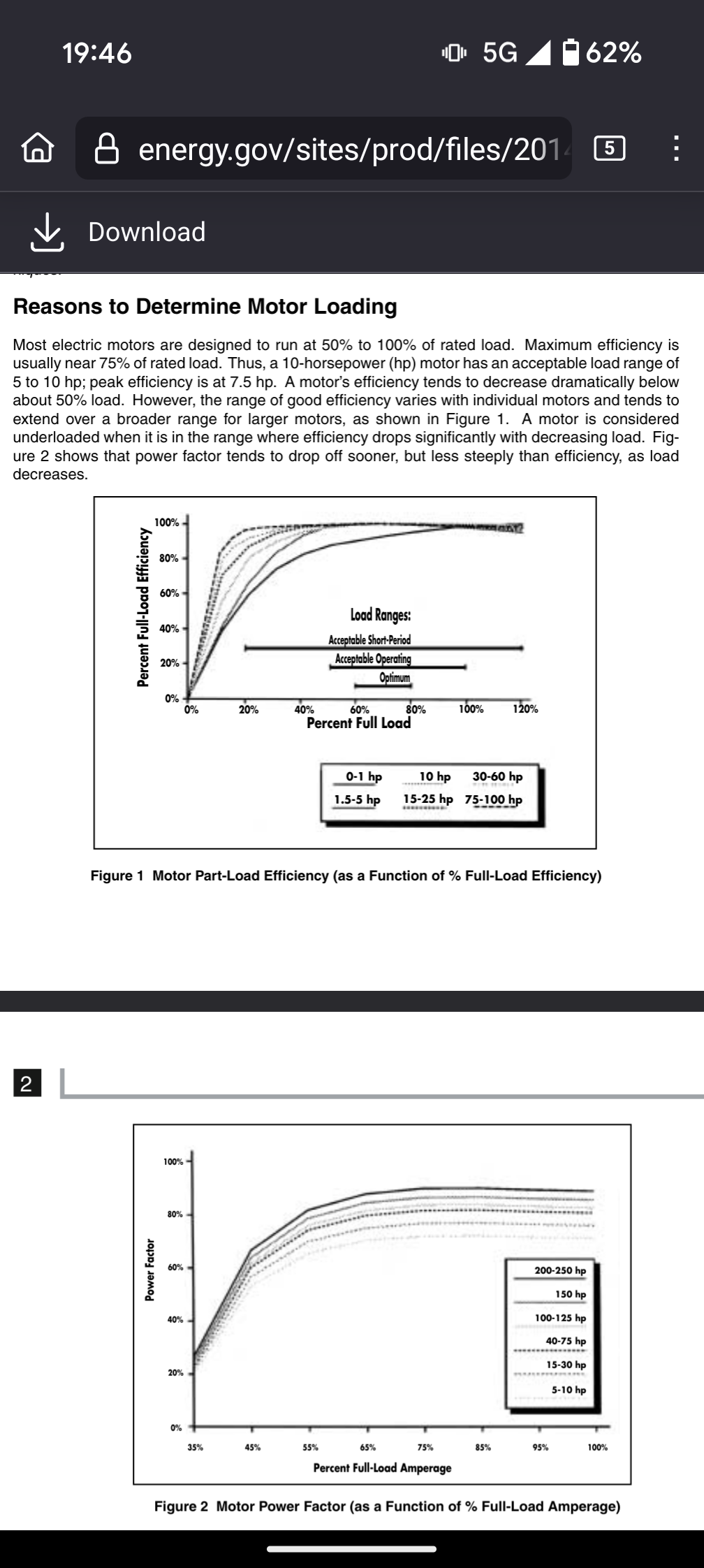

Dont electric motors also have a weird efficiency ratio?
When I was in the commercial HVAC world an engineer told me that a if an electric motor was running at 100% load and another was running at 80% load, the one running at 80% uses 50% less energy or something like that.
Okay, I did some reading and I think the guy misremembered, misstated, or maybe you misunderstood/misremembered.
An oversized motor can waste a lot of energy. An undersized motor can fail spectacularly.
What the tech was probably remembering was that oversizing the motor, for example for HVAC, can waste a lot more energy than it saves. But you would have to oversize it quite a lot. You want it to operate at 60-80% full load.
Reactions: AlanL
That sounds about right. That the 80% area was a sweet spot for efficiency and output.
