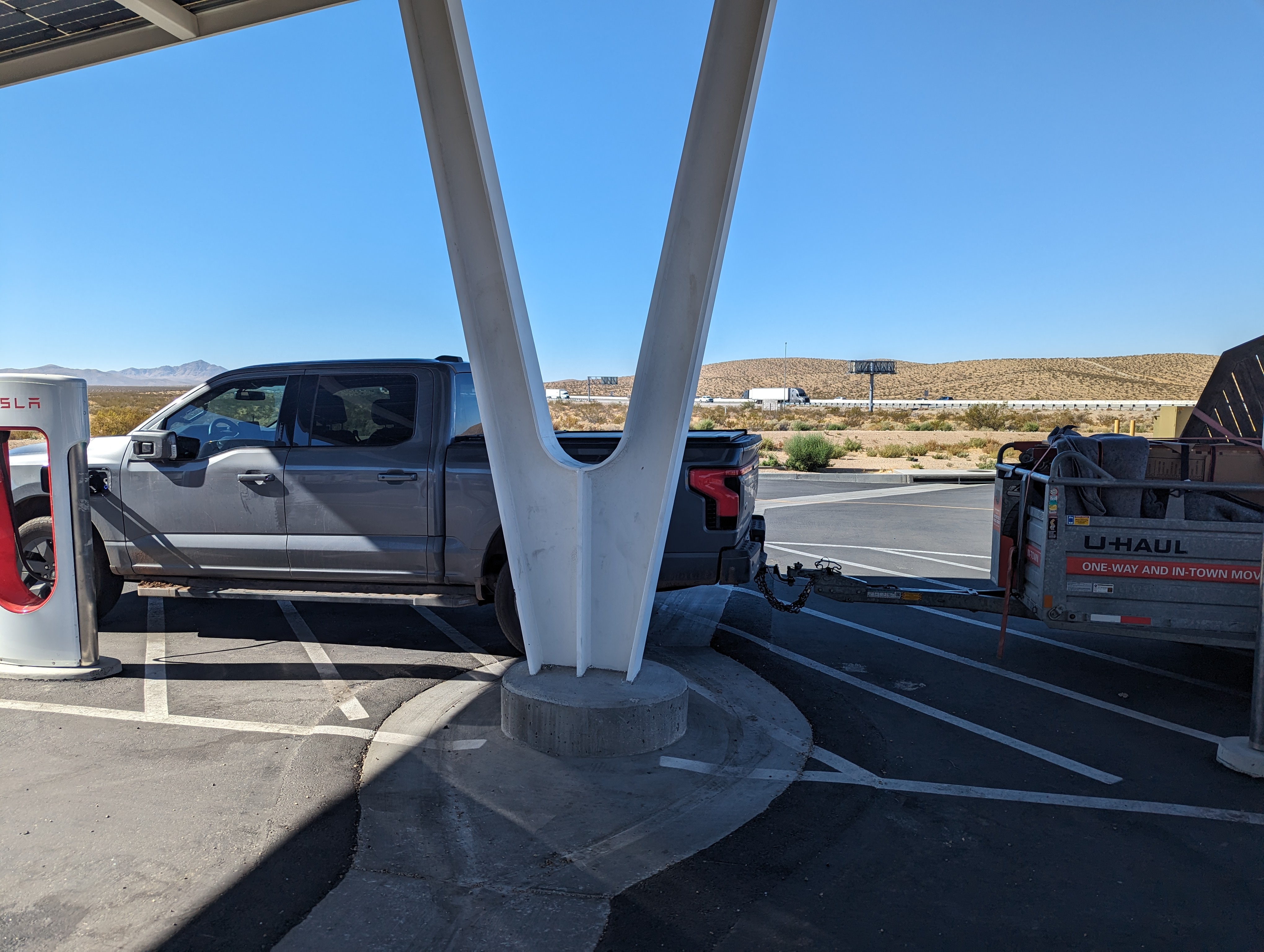

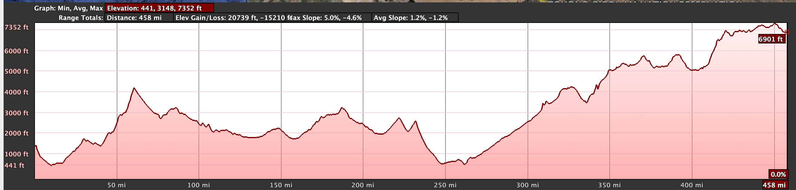

An example towing experience for me: Towing the U-Haul shown in the picture below from the Pasadena area to the Flagstaff area included 460 miles and 7400 feet end-to-end elevation gain with many climbs and descents in between.
I had four legs and made three stops before arriving home. It was an uneventful trip with one extra stop to charge. There was a vehicle fire that stopped traffic and I got stuck on the bridge crossing the Colorado River from CA into AZ on the hottest day of the year (120+ while sitting on the bridge for 60 minutes, AC blasting at full).
First leg was from Pasadena to Barstow: 1.9 miles/kWh
Second leg: Barstow to Needles: 1.9 miles/kWh

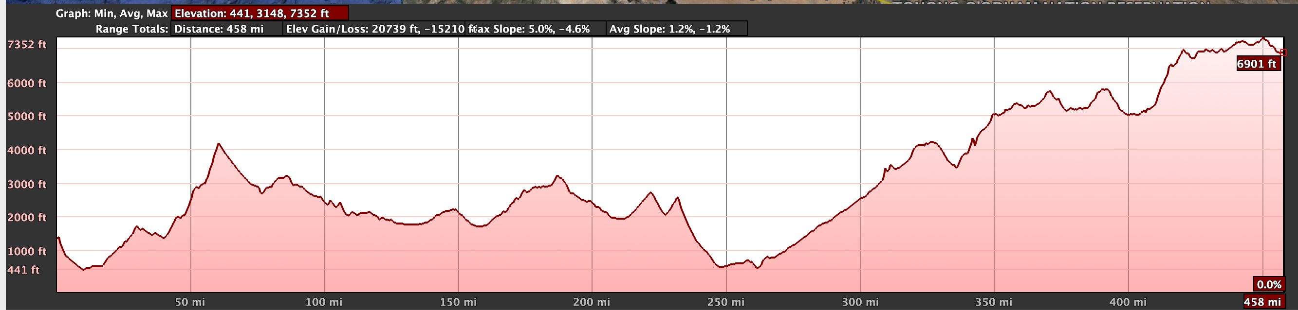

Third leg: Needles to Kingman, which included a large elevation gain (3000 feet), the 1-hour stop on the bridge with AC running, and then the “I don’t care about efficiency because I have to pee” attitude after traffic started moving again, I averaged 80 mph and 1.5 miles/kWh.
Fourth leg: Kingman to the Flagstaff area: climb from 3500 feet to 7350 feet; average speed was again close to 80 mph—I was tired and wanted to be home; 150 miles, 1.4 miles/kWh. I arrived home with 10% charge, which was too much for my general practices. I like to arrive home with 5% or less.
Efficiencies and calculated ranges for those legs:
1.9 miles/kWh * 100% * 131 kWh = 250 miles. 73 mph average.
1.9 miles/kWh * 90% * 131 kWh = 225 miles. 73 mph average.
1.5 miles/kWh * 90% * 131 kWh = 178 miles. 80 mph average.
1.4 miles/kWh * 90% * 131 kWh = 165 miles. 80 mph average.

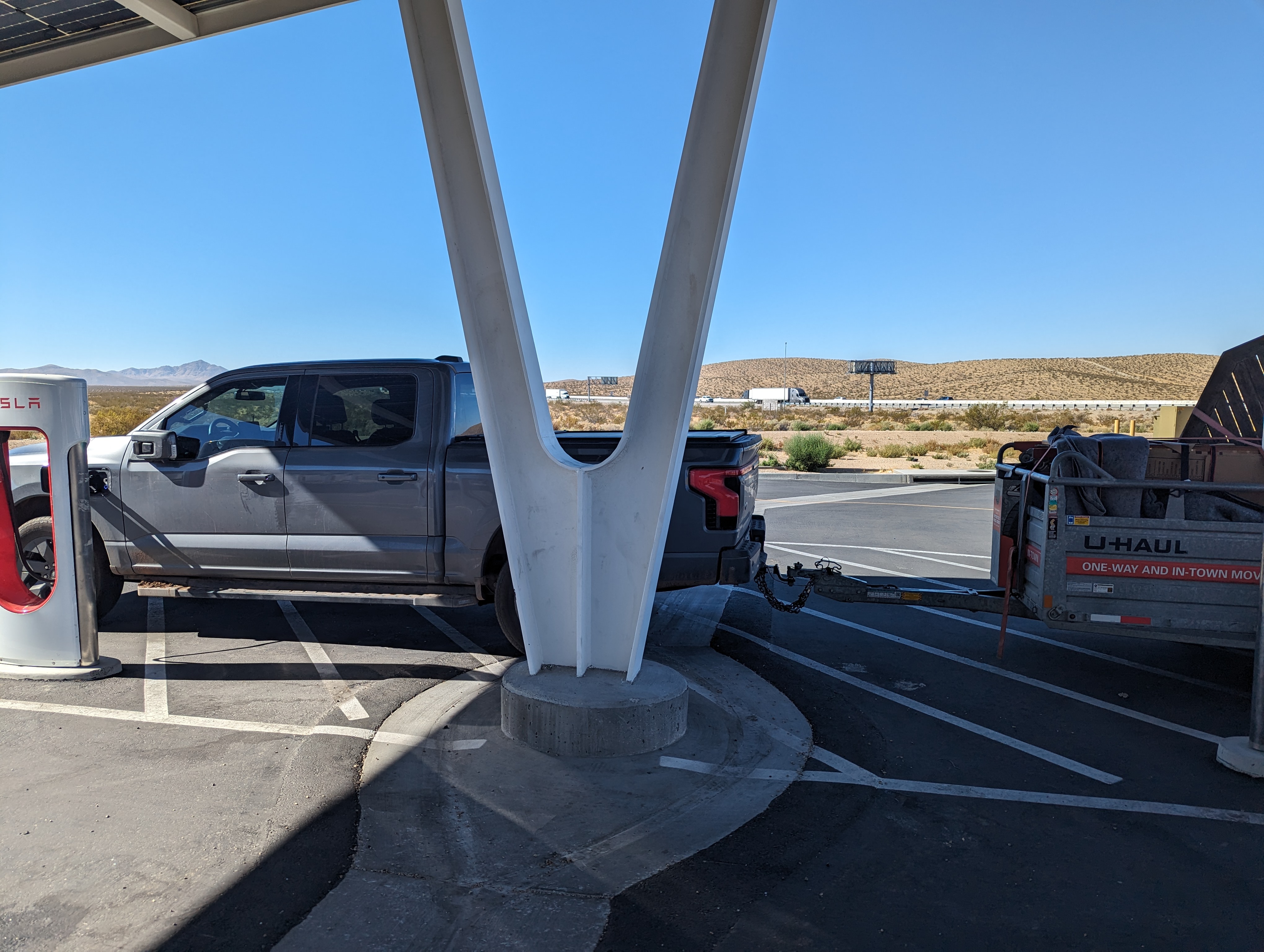

Stop in Barstow, CA at the brand-T Supercharger. No need to drop the trailer.

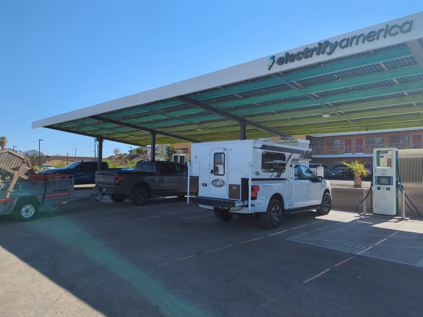

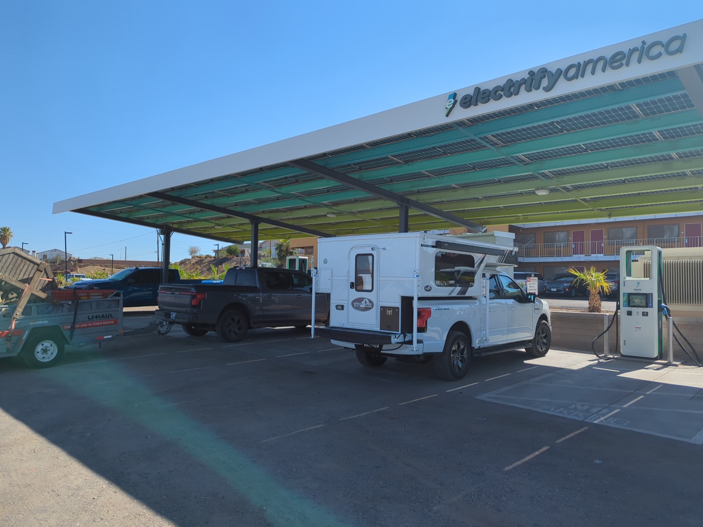

Stop in Needles, CA at the EA charging station. Also no need to drop the trailer—behind the trucks is a large dirt lot.

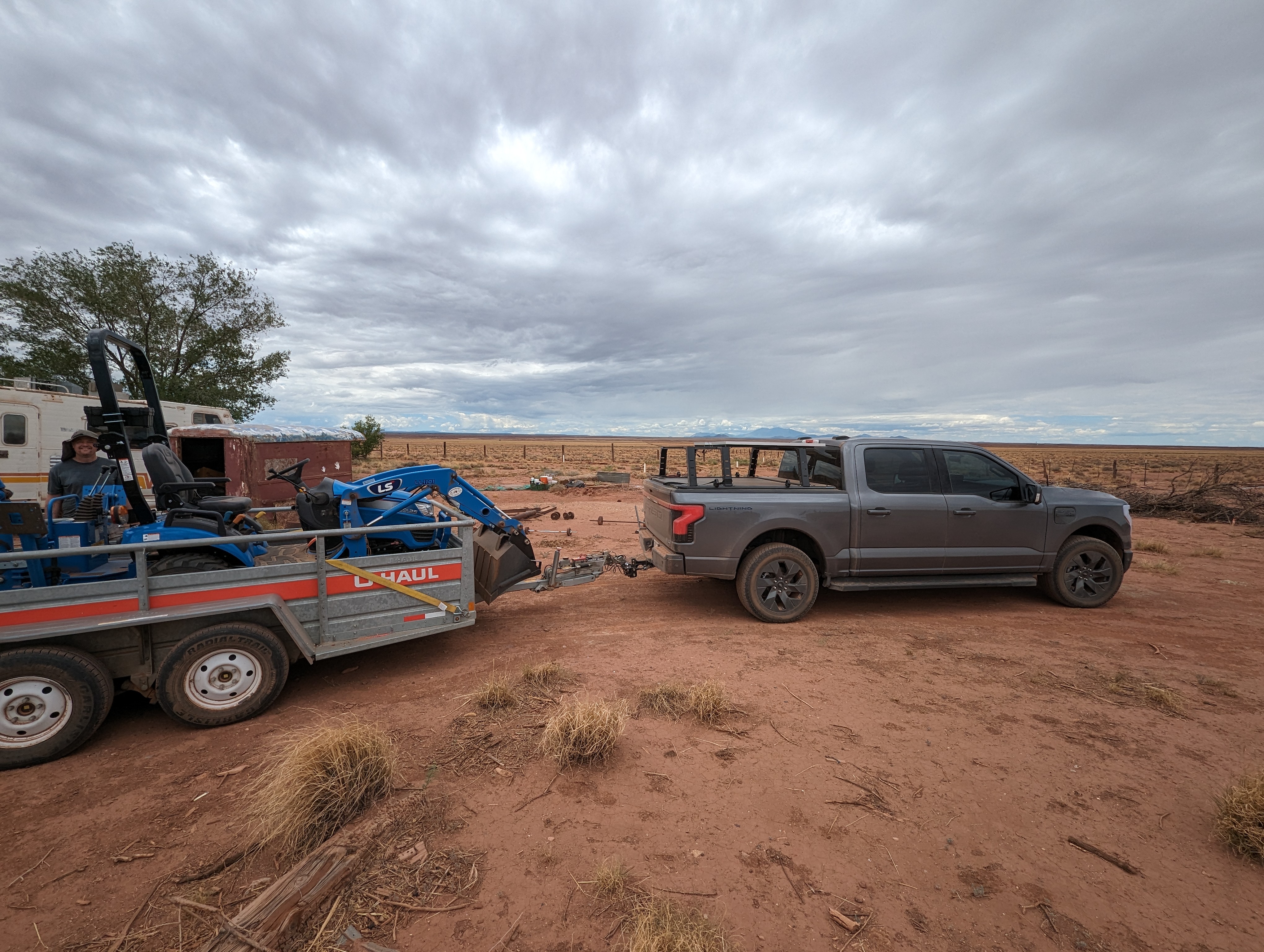

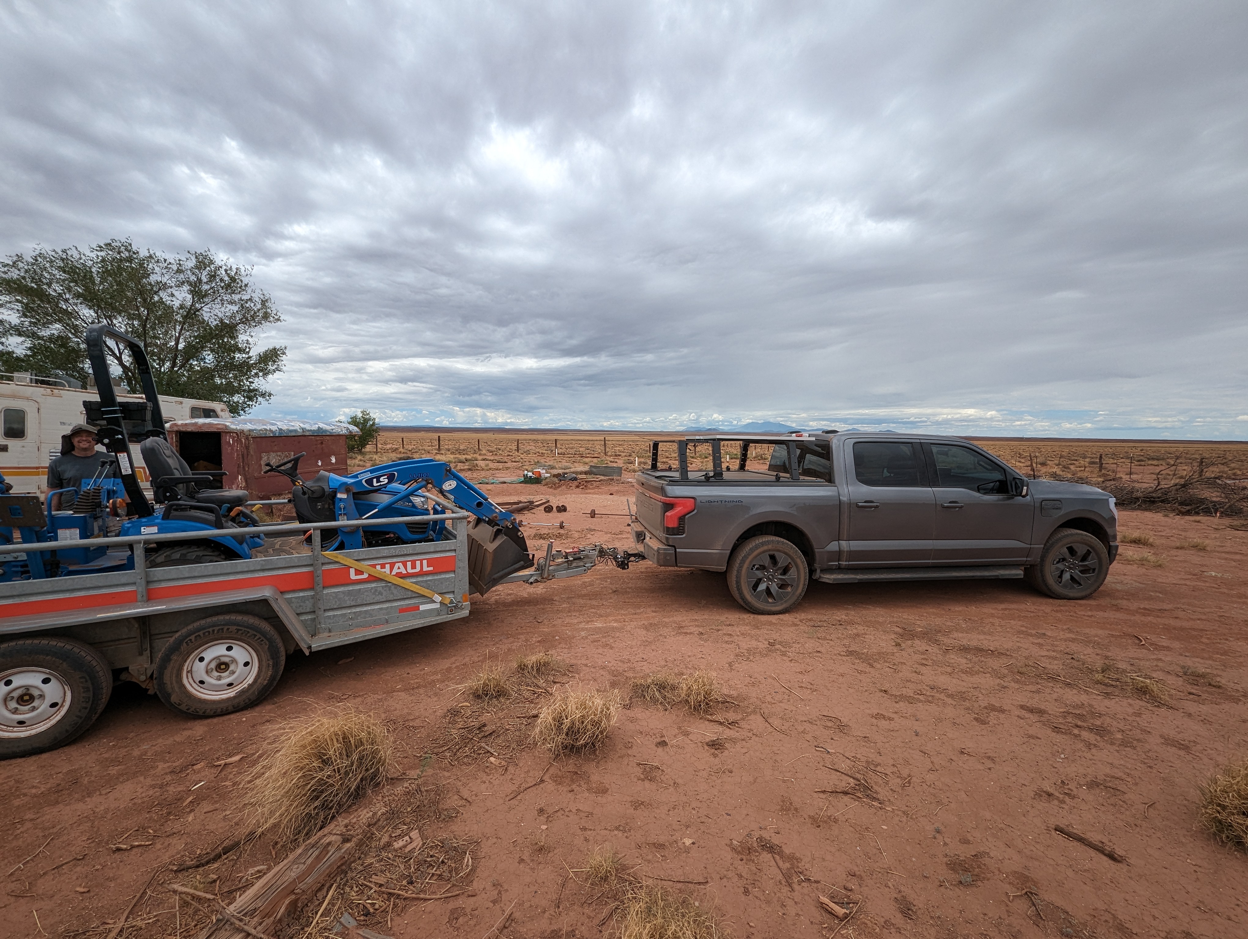

Bonus photo of me having towed the tractor to a work site in the Northern Arizona desert. This was a hot day (despite the cloud cover in the photo, which burned off quite rapidly). We used the truck to power all of the power tools, from jackhammers to drills to skillsaws, and ran a freezer with ice cream, popsicles, and other treats for the crew. I also took a couple of 2-hour work meetings while in the truck with the AC running.
