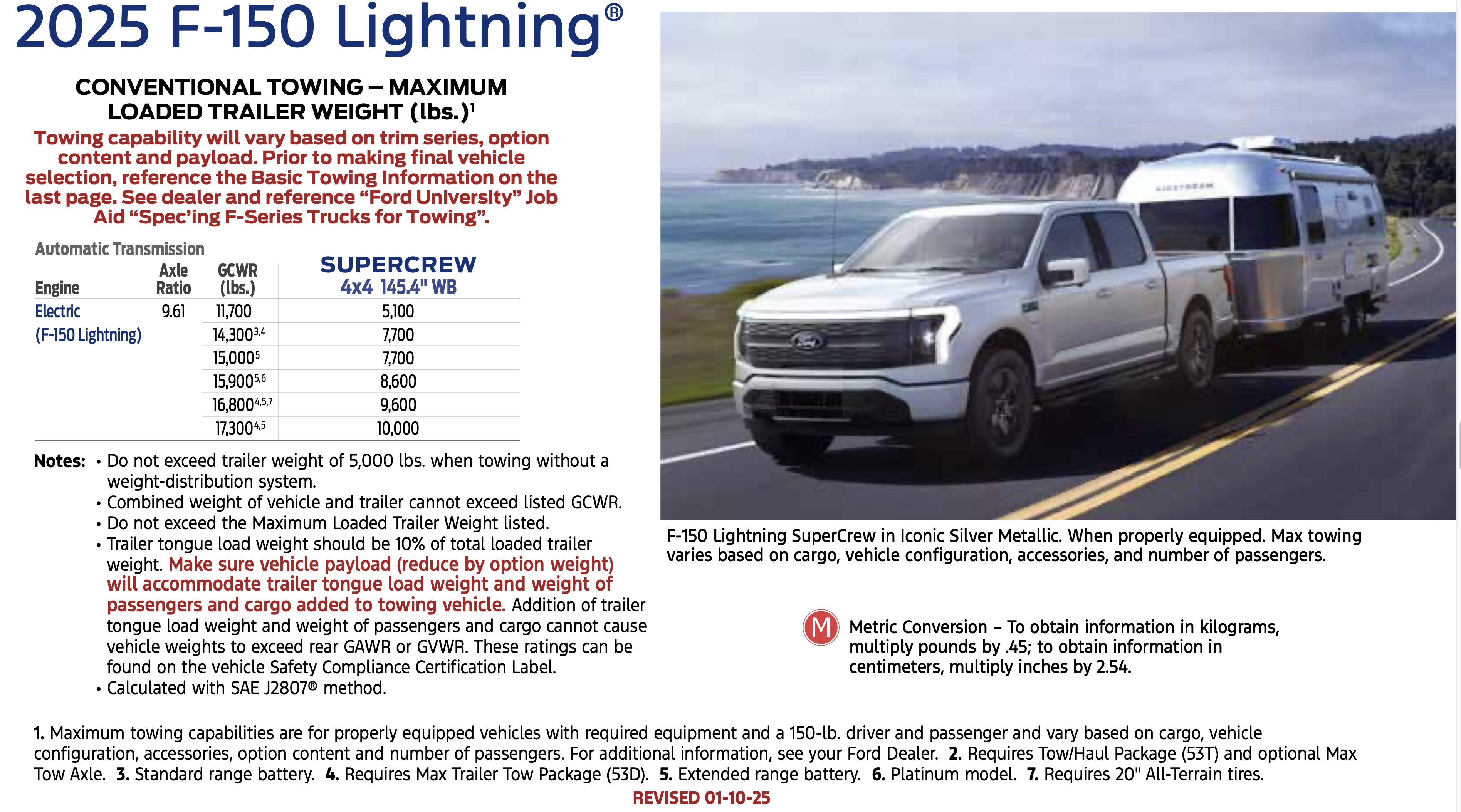

There’s been a similar discussion among some Lightning owners.
The maximum tow capacity of the Lightning is 10,000 pounds, but your trim and package selection can bring it down to 5100 pounds rated towing capacity. But even that cannot be achieved without a weight distributing hitch. All of the following assume a WDH is being used. The maximum for any bumper tow Lightning without a WDH is 5000 pounds, and I think that’s true for most non-HD vehicles with higher tow ratings.
See footnotes 3-7 in the attached image for the various options that impact the GCWR and tow capacity on the Lightning. The GVWR is either 8350 or 8550, depending on the battery option. There are two tow capacities with the GVWR of 8350 (standard range battery): 5100 or 7700 pounds. The lowest tow capacity for the extended range battery option is 7700 pounds. You can increase it to 8600 by getting the Platinum without the tow package. If you have a Lariat or Flash with the max tow package but not the right tires, you’re limited to 9600 pounds. You can finally gain the rating for those last 400 pounds by having the proper tires installed at the factory. The XLT, Flash, Lariat, and Platinum all have the same frame, axles, and suspension.
The specifics of why/how weight ratings are calculated are in the SAE J2807 standard. What will impact the Scout ratings will depend on weight distribution as much as things like axle strength, frame strength, brake size, etc. I’m sure I said it in this thread or one of the several other threads: the size of the smaller, LFP battery on the hybrid and where they put the bulk of the Harvester engine will determine the tow rating. My guess is there’s only so much NVH they’re willing to accept for tow rating. They’re not building HD tow monsters.
The specifics of why/how weight ratings are calculated are in the SAE J2807 standard. What will impact the Scout ratings will depend on weight distribution as much as things like axle strength, frame strength, brake size, etc. I’m sure I said it in this thread or one of the several other threads: the size of the smaller, LFP battery on the hybrid and where they put the bulk of the Harvester engine will determine the tow rating. My guess is there’s only so much NVH they’re willing to give up for tow rating. They’re not building HD tow monsters.
Great explanation Thanks.

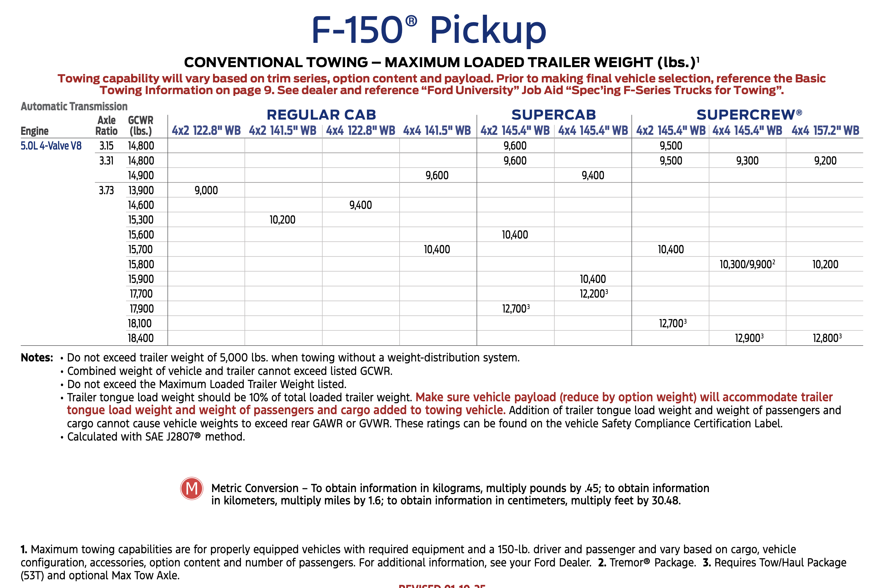

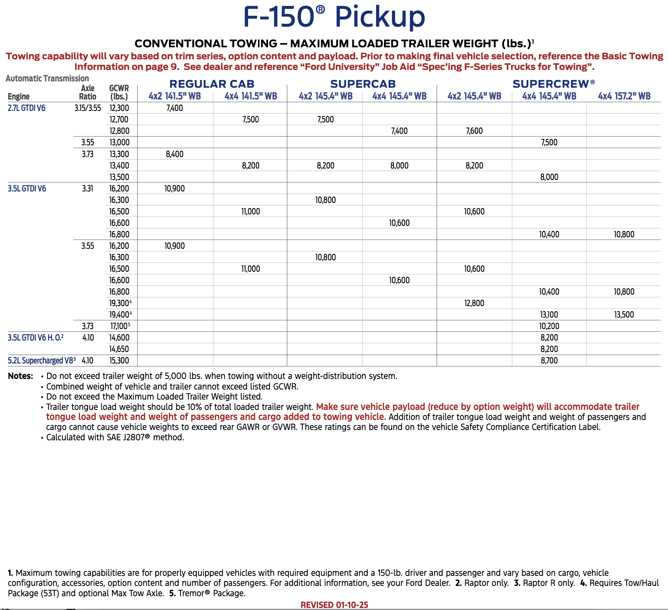

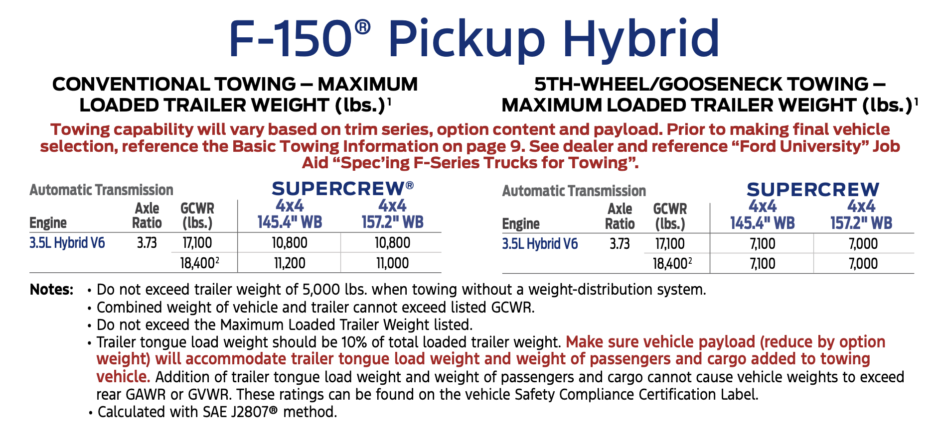

Great breakdown. Just for fun is there a similar one page document for the standard F150 to compare with the Lightning?
Yep!
Note that you can get different axles/suspension in the gassy truck, which means you can get another bump up in towing capability.
And, of course, you can order the tow/haul package, which provides the bigger alternator, bigger radiator, etc.
