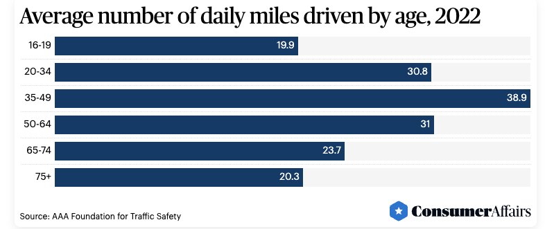

Regular travel is a great use case for any EV, based on average travel distance. Also, EV's make excellent off-road vehicles (and to be clear, never in my post did I say they were not ideal off-road).
It might be helpful to step-back, understand where sales will come from for Scout, who will be buying these vehicles, and how they will be used most of the time. Also consider the data for the most common driving patterns are (in the US). The NHTSA and other reliable sources publish travel survey results, like the results you see below.
With an understanding that the majority of vehicle owners drive relatively short distances on a daily basis (requiring less frequent charging), and that longer road trips over longer distances are far less frequent (which may require charging at DCFC stations), one may deduce that the amount of DCFC charging time for ANY EV will be far less frequent than home or work charging.

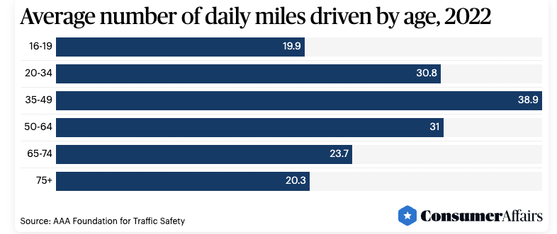

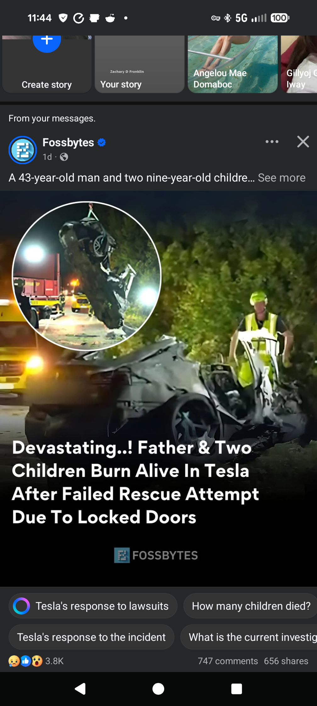

This isn't just a Tesla problem. It’s not even just an EV problem. The use of dual-pane tempered glass has been flagged in news reports and raised by first responders as a serious safety concern. These windows offer improved acoustics and better insulation from road noise, which is great—but that can't come at the expense of safety. There has to be a way to deal with it.
These windows are incredibly difficult to break with traditional tools—even a hammer might fail when seconds count. Now imagine you're wedged between vehicles or pinned by debris—doors won’t open, and time is critical. Escape through the windows becomes essential.
Take the Model Y, for example. There was no interior release for the rear hatch. In a water submersion scenario, vehicles often float trunk-up. If you can't break the rear glass, you're trapped. That’s unacceptable.
Yes, the Model Y had manual emergency releases on the rear doors, but they weren’t accessible—certainly not by hand. Fortunately, the rear passenger windows in my vehicle weren’t dual-pane, so a traditional breaker might work there. But that’s not good enough.
As an EV owner, I’m acutely aware of the risks. These vehicles burn hotter than gas-powered ones, and while both are dangerous, lithium-ion and lithium-phosphate batteries introduce unique hazards—thermal runaway, puncture, fire. If something goes wrong, you need a way out. Fast.
Scout has an opportunity to lead here. Whether it’s designing glass that can be shattered (pushed out?) in emergencies or integrating a reliable escape mechanism, this must be addressed. We cannot accept vehicles that trap occupants during critical failures. Safety is #1

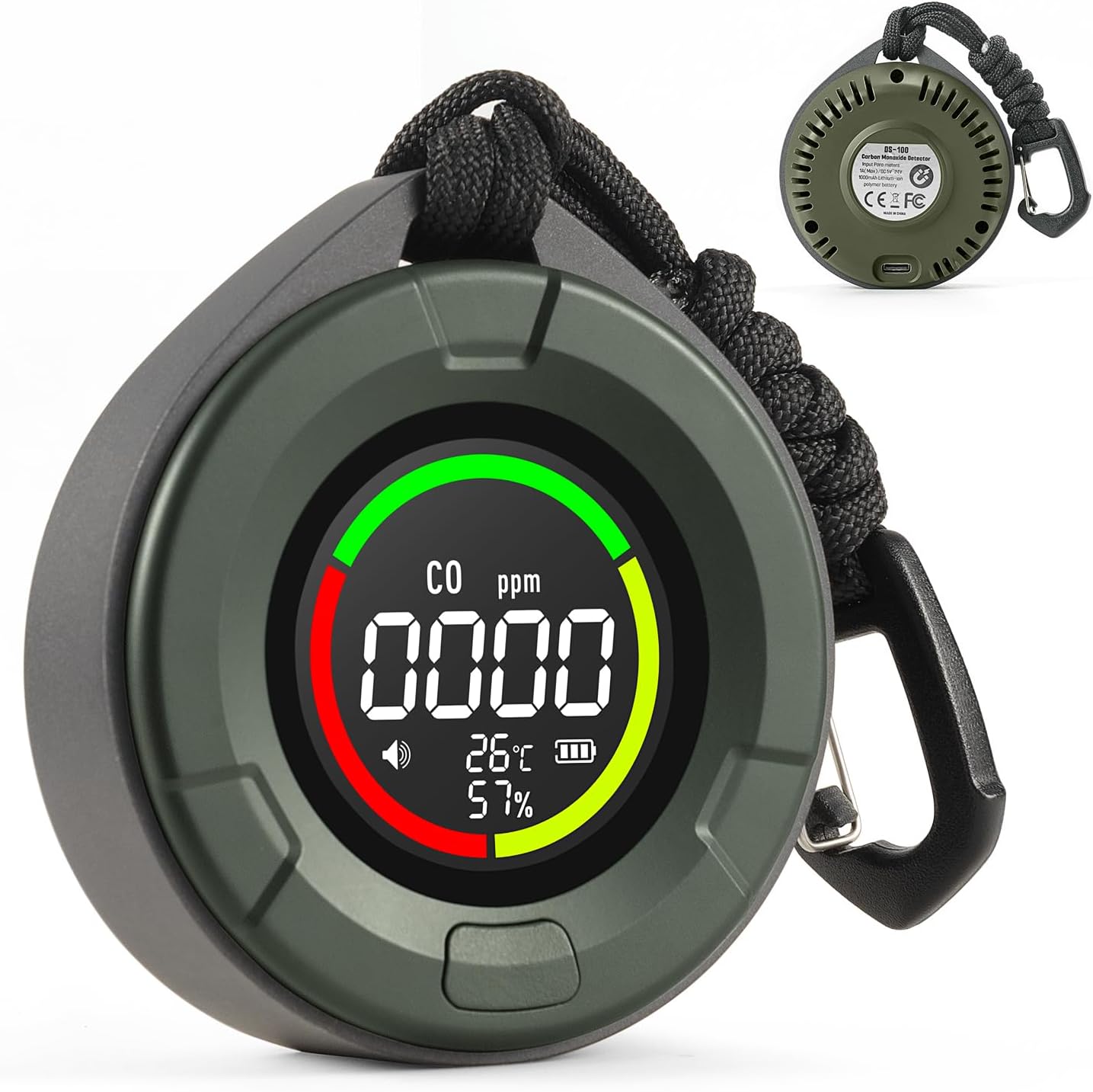

For the upcoming Traveler and Terra—please add built-in air quality sensors. People will no doubt camp and boondock in these.
  • Display real-time CO₂ levels on the dashboard or app.
  • Auto-adjust ventilation (e.g., temporarily switch to fresh air if levels rise too high).
  • Alert you during camping mode or long sits.
  • Add thoughtful safety for adventure use without relying on aftermarket add-ons.
  • With recirculation on, CO₂ often exceeds 1,000-1,500 ppm in 10-30 minutes with 1-2 people.
  • It can climb to 2,000-3,000+ ppm (or higher in extreme cases like overnight camping or long idling) within 30-60 minutes or more.
  • In camping/sleeping scenarios (e.g., using Camp Mode in Teslas or similar in other EVs), owners report spikes if auto-recirculate dominates, leading to stuffiness, drowsiness, headaches, or reduced cognitive function—even though it's not immediately life-threatening like CO poisoning.
  • Safe/comfort thresholds: Many sources suggest keeping below 1,000 ppm for optimal alertness (ASHRAE guidelines for indoor air), with 2,000-2,500 ppm linked to noticeable fatigue/drowsiness, and higher levels worsening effects.
