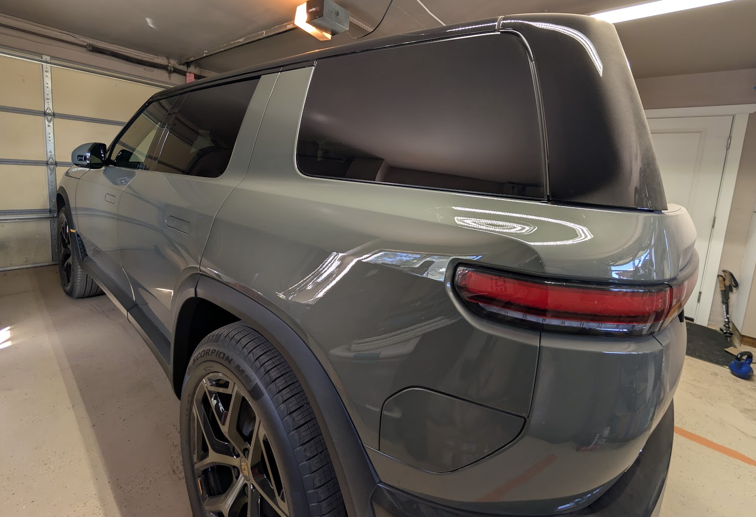

The R2 fits in our 1-car garage just fine. It must be backed in because the rear hatch will hit the garage door if it’s pulled in front-facing. This is fine for our setup since we have the charger on the driver side anyway.

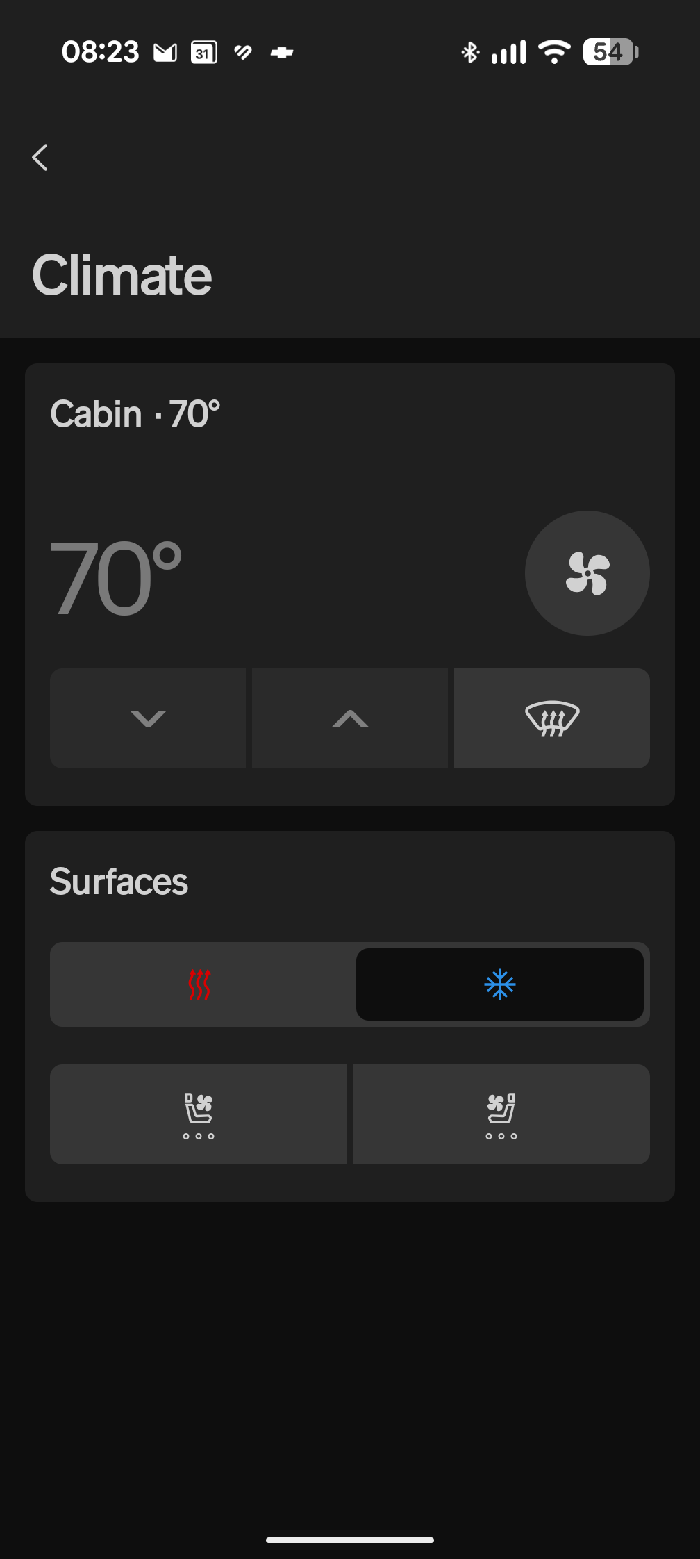

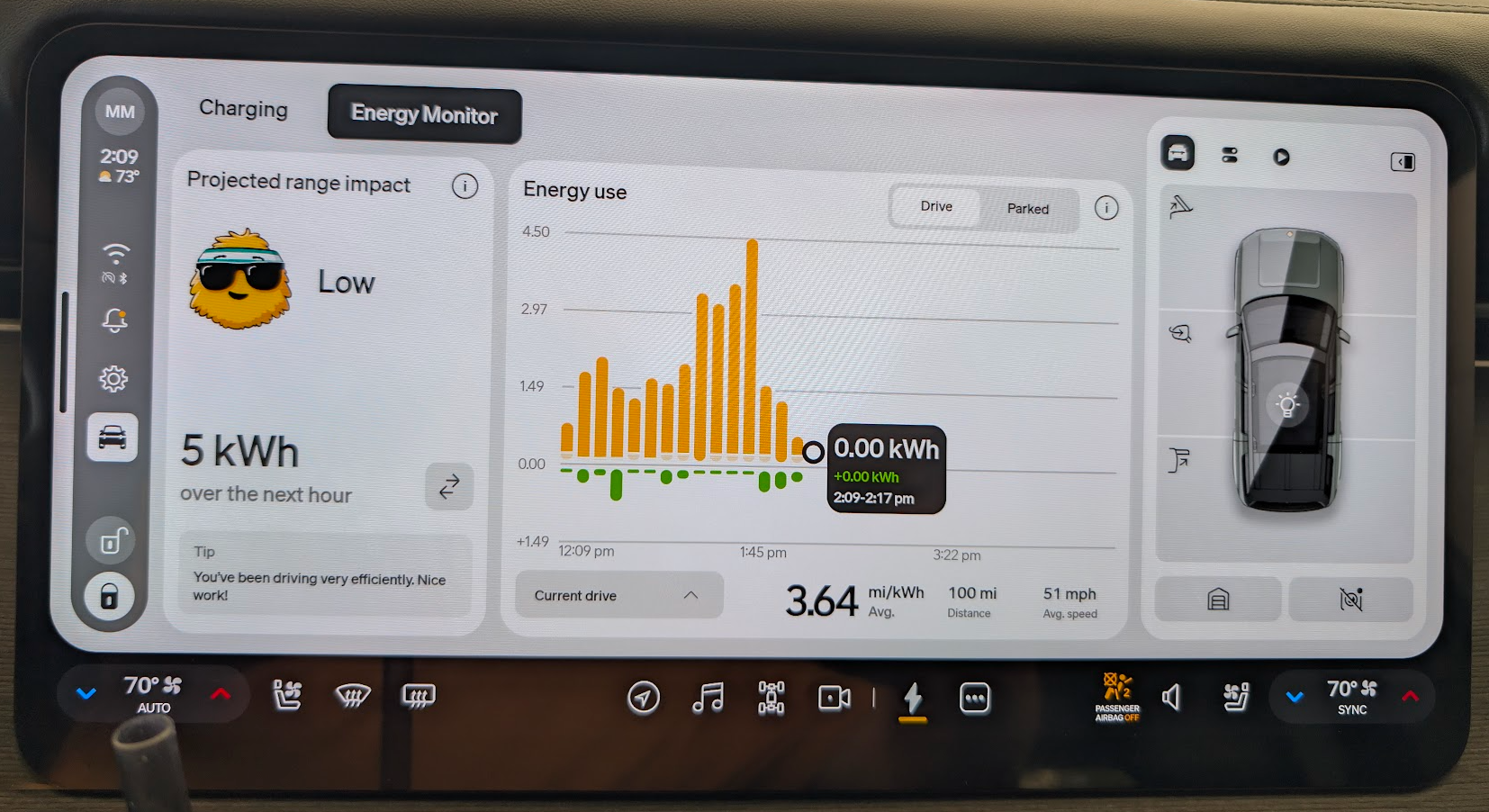

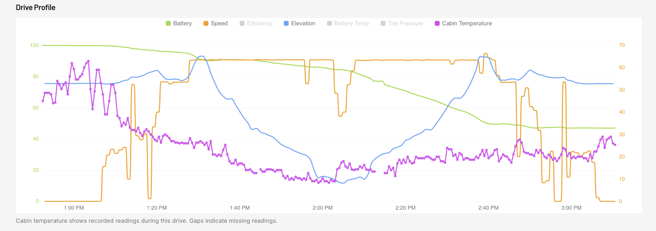

Today I took the R2 on a calibration drive to understand how its range is impacted by our typical trips and also to give myself a control for a test towing the popup trailer. It was just me in the vehicle and the exterior temperature ranged from about 75 degrees to 85 degrees F. There was a slight tail wind on the way out and a bit stronger headwind on the way back. I set the HVAC to 70 degrees, fan speed to low, and let it manage the rest. I usually run at 75 degrees F, but my partner prefers it a little cooler.
I chose a 100 mile round-trip drive that takes me down off the mountain quite a bit and then back up it. I did not stop on this drive. The speed limit is generally 65 mph and I stuck to the speed limit. The average speed was 52 mph.

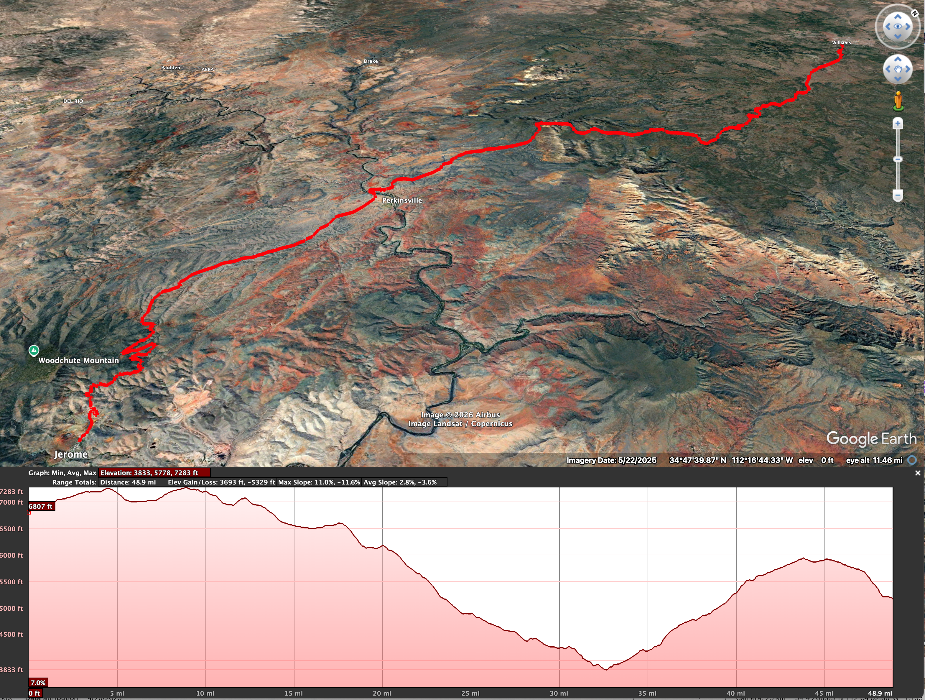

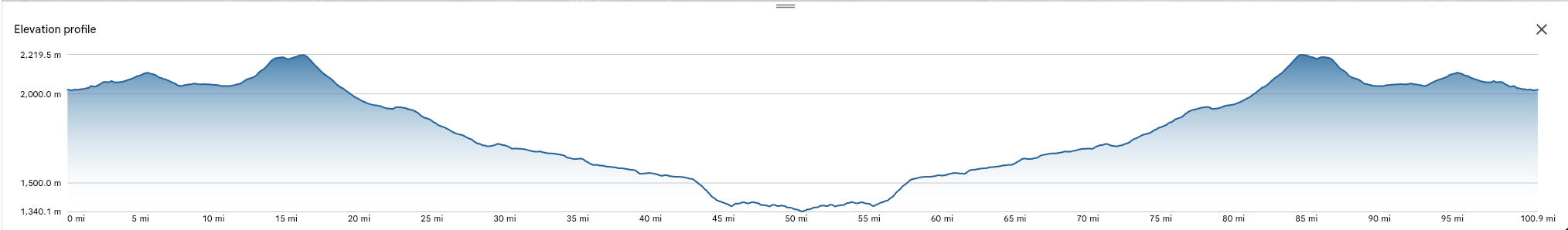

The elevation profile of this short trip is below. There’s a bit of a climb, then a long drop. Then coming back up the mountain is a long climb with a short drop back down in elevation. The maximum elevation was about 7,282 feet. The minimum was about 4,397 feet.

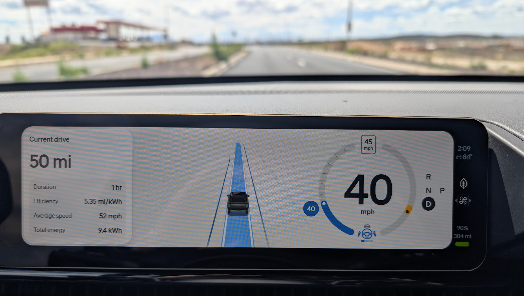

At the start of the drive, the R2 was at 100% state of charge with 330 miles of estimated range. I put it in conserve mode and that bumped the estimated range up to 334. Not much of an improvement, but I left it in Conserve mode.
On the way out, the R2 hit a peak of 5.4 miles/kWh right at the 50 mile mark. If our only driving was downhill, this would be fantastic for a 91.6 kWh battery. But, of course, that’s not realistic.

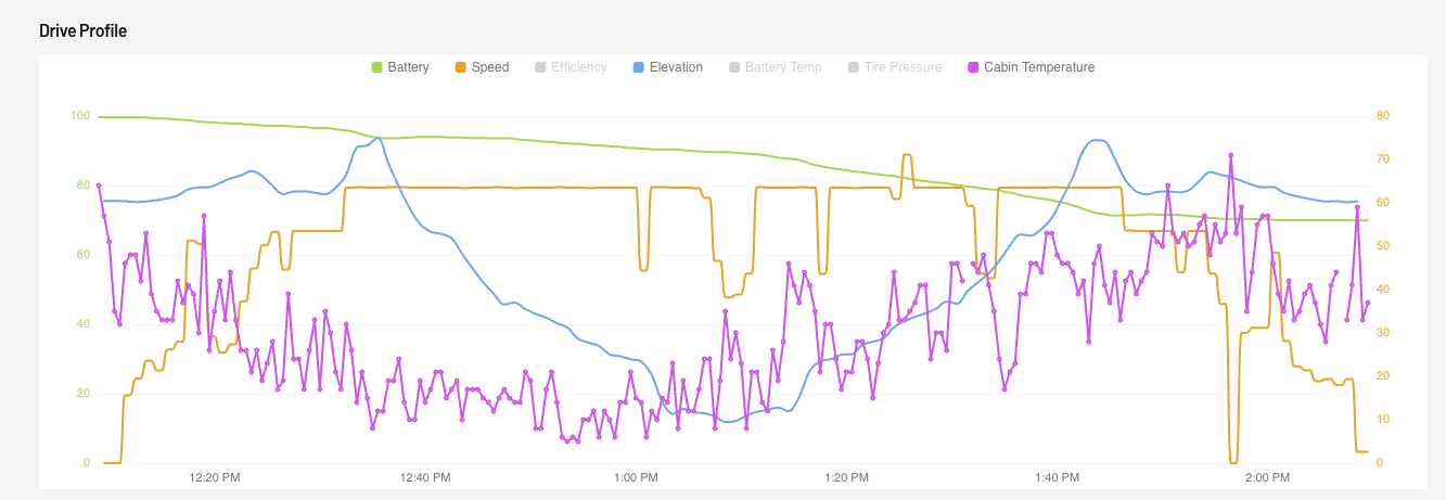

This is a graph of some data provided by the Rivian Roamer site. I think similar data could be pulled from the truck somehow, but I’m not sure how, and I decided just to pay someone else who already knows how to get those data.
The climb back up greatly reduced the efficiency, as is to be expected.
The final result was that the 100 mile drive required 30% of the battery and the end efficiency was 3.66 miles/kWh. That efficiency is pretty much spot-on exactly the EPA estimated efficiency/range. With 3.66 miles/kWh, we could reasonably expect about 330-335 miles of range. The EPA estimate is 330 miles and the Conserve setting suggested 334 miles of range.

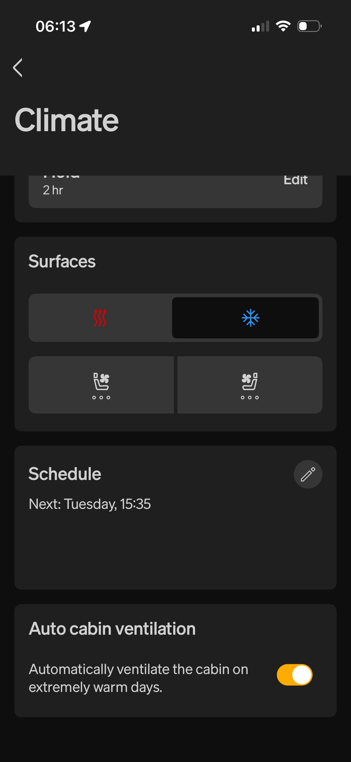

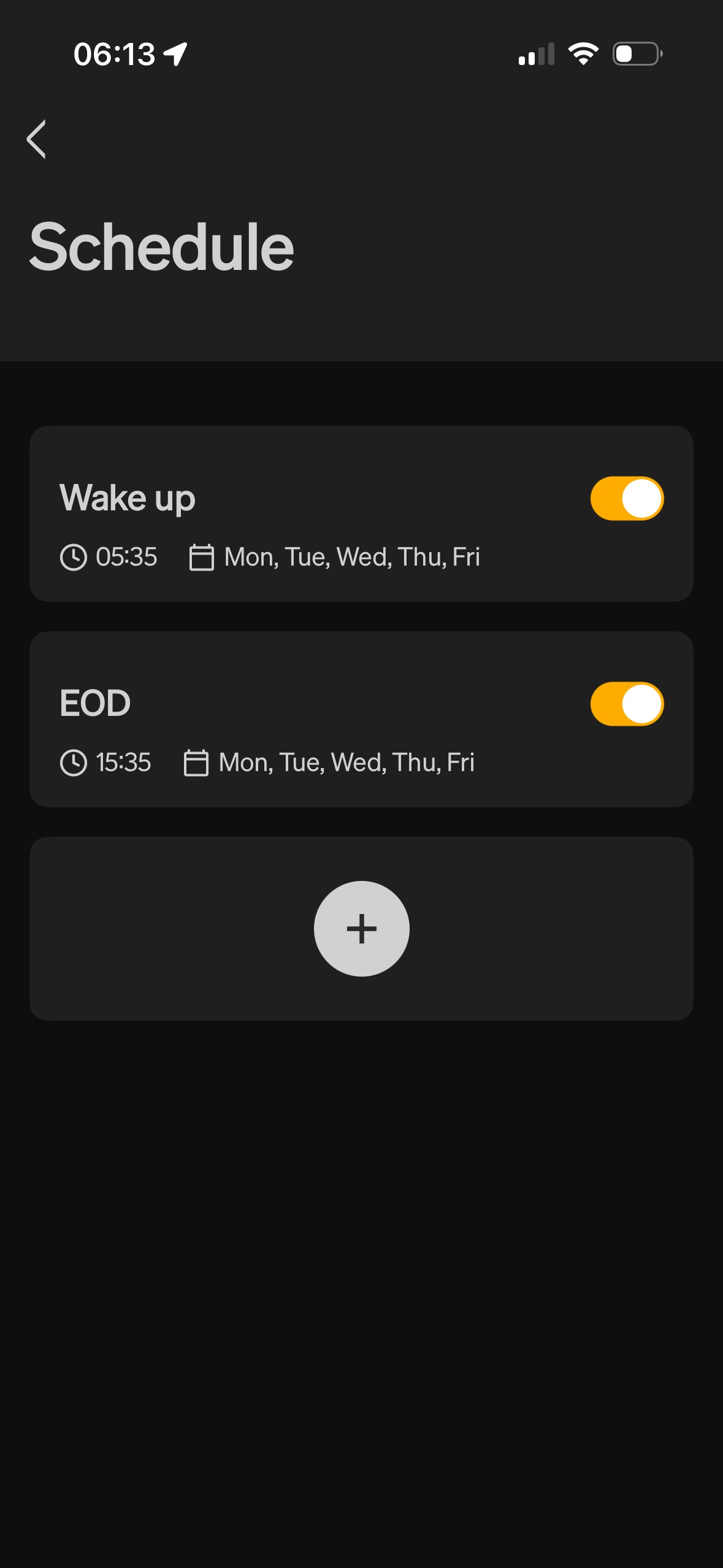

I’d really like to be able to set departure times on the vehicle so it can schedule cabin warm-up/cool-down before we leave on a regular schedule. The Mustang, Lightning, and Silverado have this capability and it’s rather sad that Rivian hasn’t made this an option.
