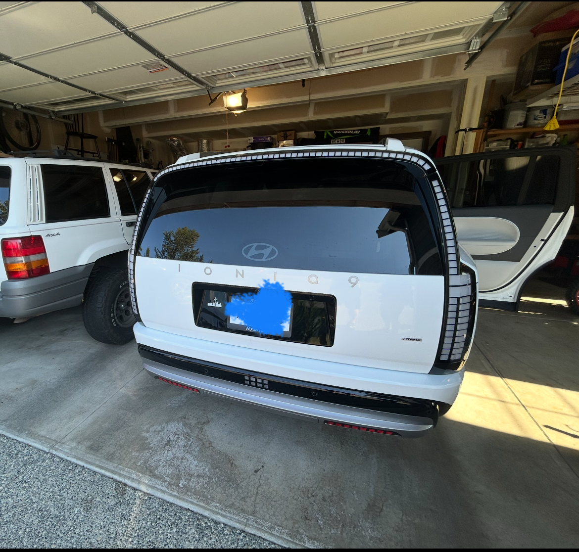

My family just jumped aboard the EV train earlier than expected. With the federal tax credit going away, and some seriously massive incentives by manufacturers to move product before then, combined with the likelihood of tariffs and inflation driving up vehicle prices more over the next few years, we took the plunge.

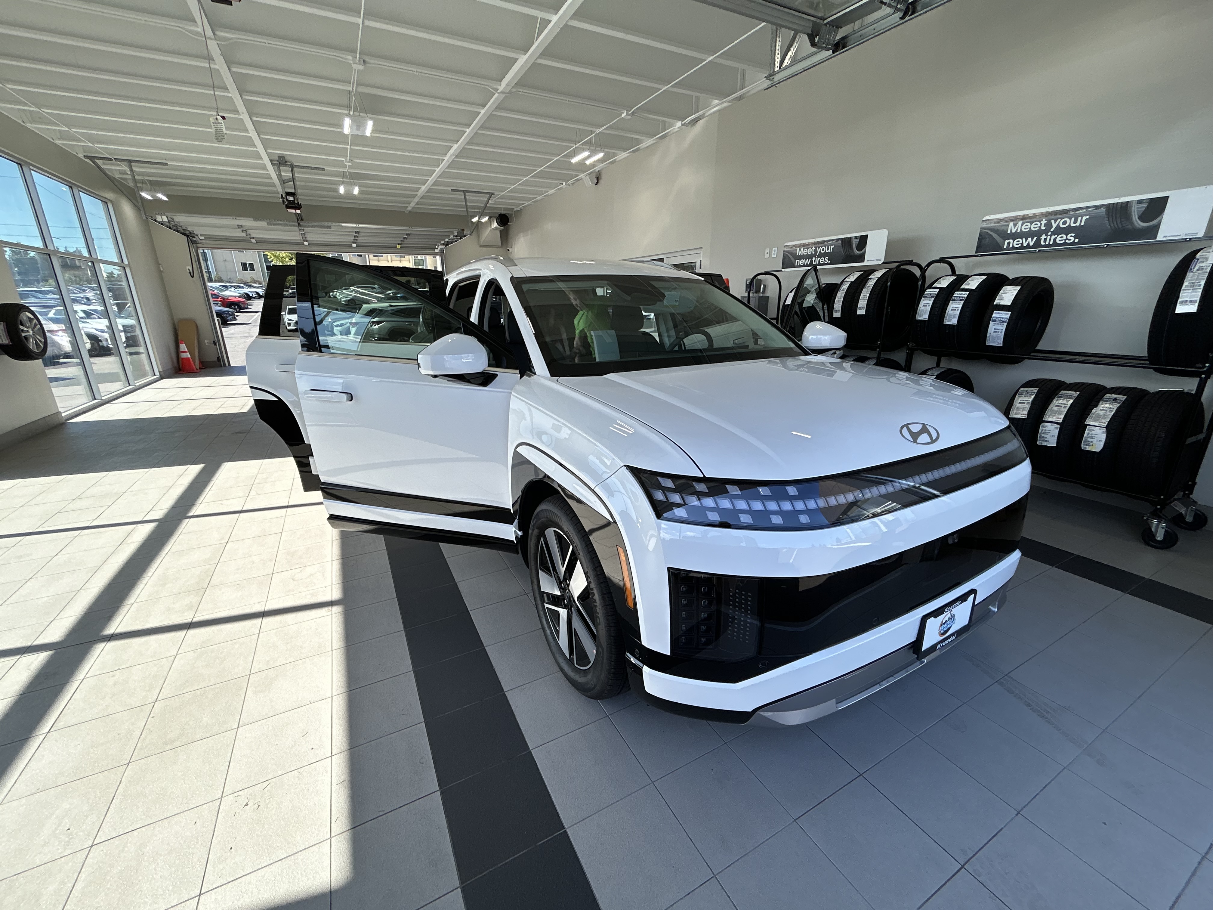

We picked up our 2026 Hyundai Ioniq 9 yesterday. We got it for almost 25% off of MSRP. Enough of a discount that instead of paying a premium for an EV, it was actually a few thousand less than a similarly equipped Toyota Sienna/grand highlander.
Still pricy for my blood, but I’ve done the math 6 ways through Sunday, and even compared to used 3 row vehicle pricing, it’s not bad. We paid a few thousand more than the avg used 3 row vehicle with <60k miles on it. And the math shows that over 5 years, the “fueling” costs for the Ioniq 9 is between $6000 -$14000 cheaper if charging at home.
Anyway, we are still learning. But our PHEV experience was good enough we wanted a 3 row family vehicle. Although we did keep the PHEV for road trips for now. Maybe the scout will be a harvester for that purpose when it arrives. Or maybe we will be comfortable enough with EV’s by the time the scout comes out to get the BeV version. We will see.

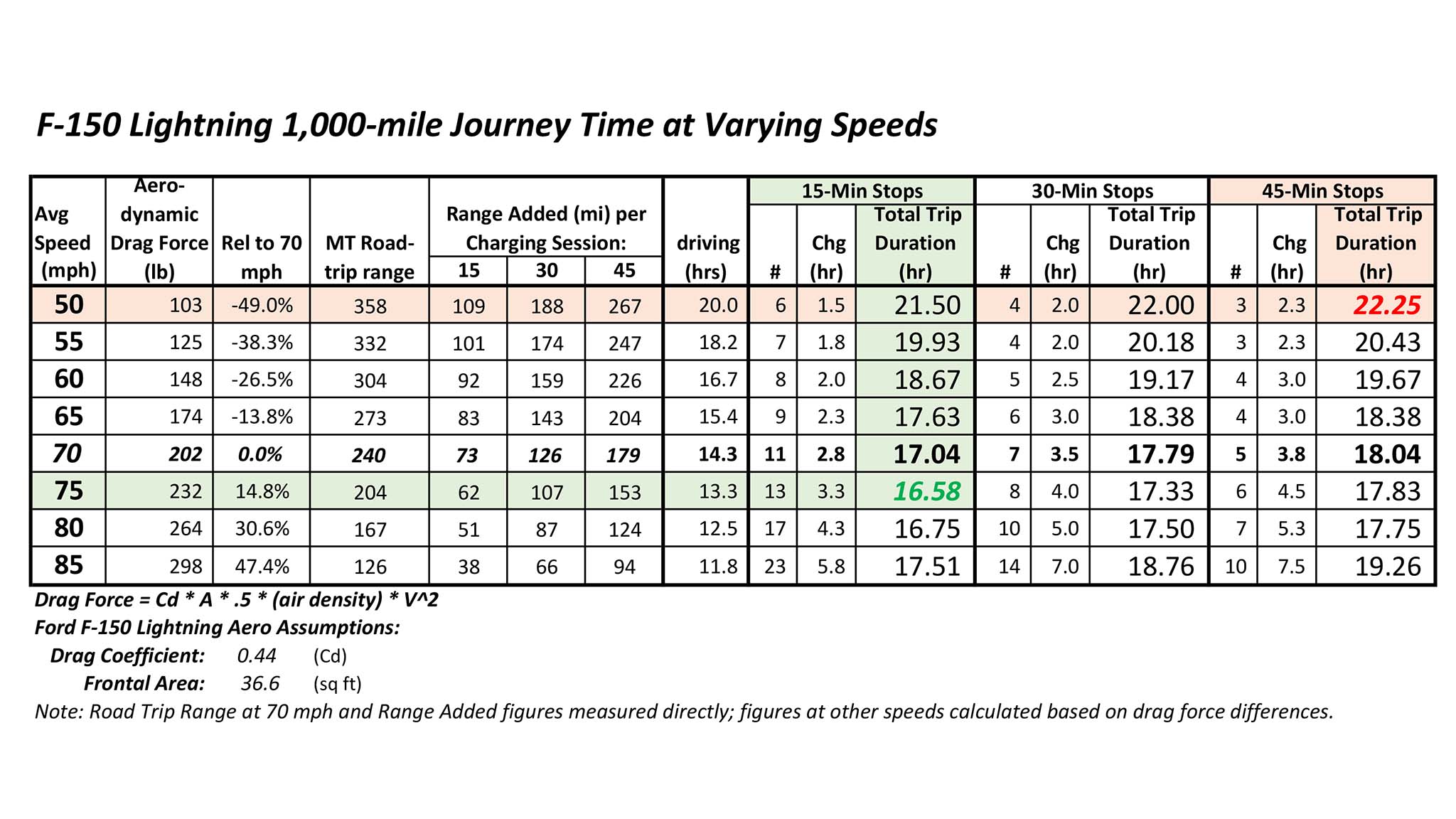

I’ve noticed that units have been a source of confusion for a lot of people, even well-seasoned EV drivers. Eventually everyone seems to find a way to make it make sense to them. I created a spreadsheet for my partner so she could better understand the various numbers she’s seeing in both the Mustang and the Lightning. Because who can easily divide/multiply by 90 or 130 in their heads? Not many of us.
Here’s a sample for the Lightning. The numbers across the top row are battery state of charge in %. The numbers down the first column are the reported efficiency in miles/kWh. The numbers in the interior of the table are estimated remaining range (in miles), if the efficiency stays the same. Our table goes from 1.0 to 3.5 miles/kWh and includes every 5% instead of 10% battery state of charge.
