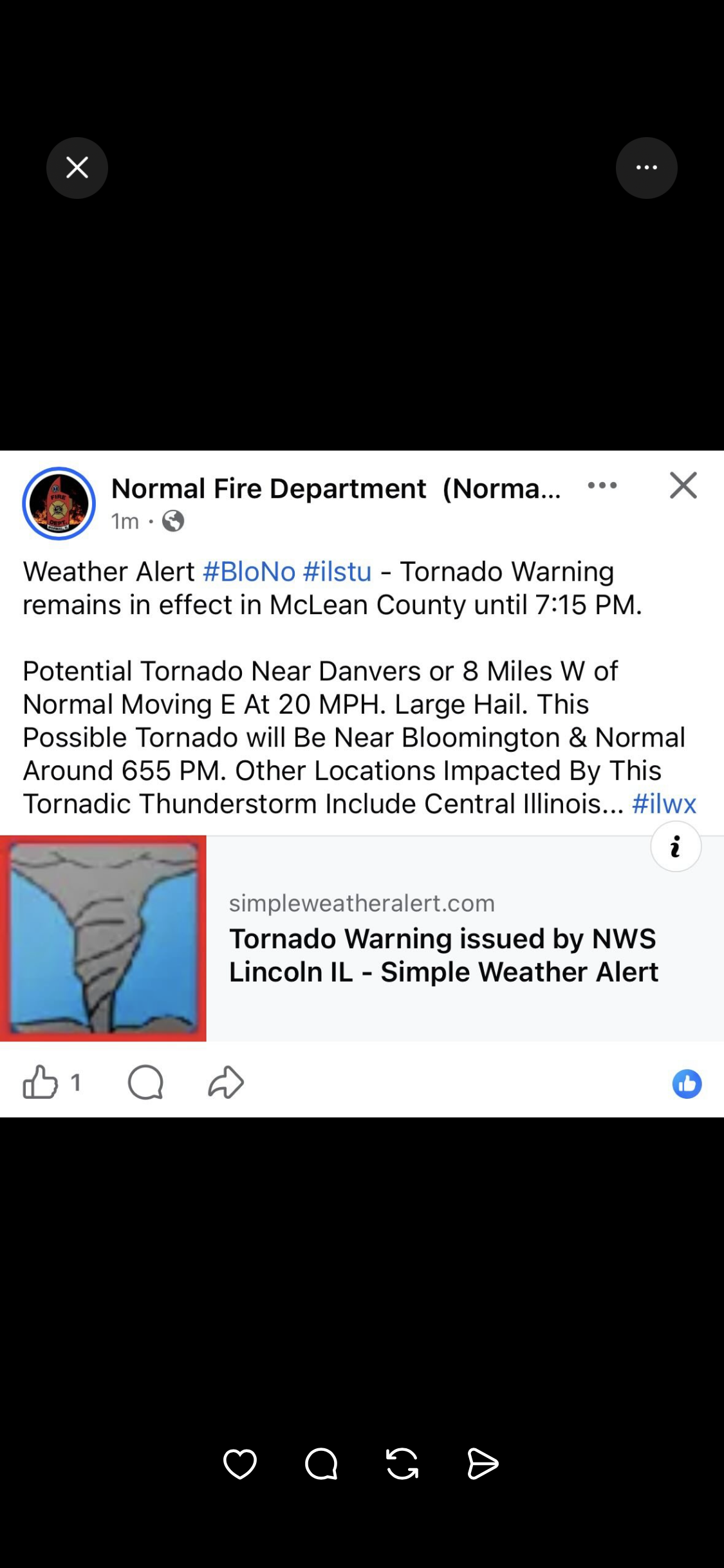

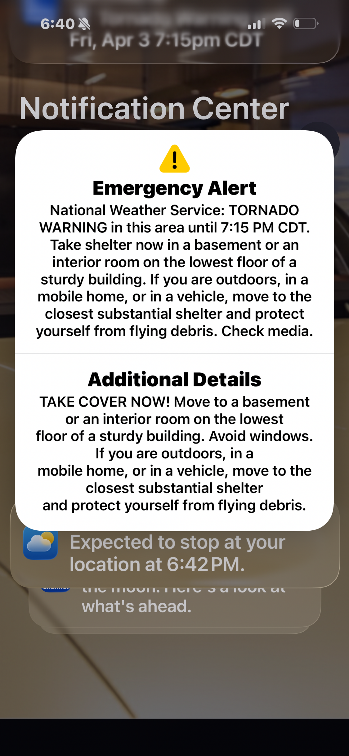

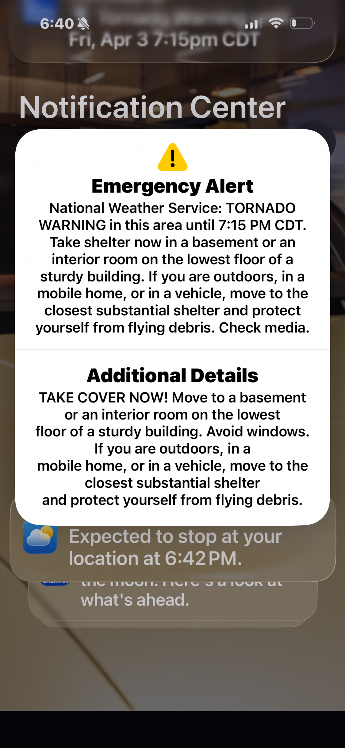

And we are back upstairs. Back to tornado warning. Goodness. I hate when those sirens go off.
I lived 6 years in Ohio, and even did a summer camp in Bloomington one year. I know what you mean. Being woken up, and carried/herded downstairs into the basement. It’s not fun, but you do sort of get used to it.
We did have a tornado take the roof off the house next to us when I was about 5yrs old. They do make a sound.
I still have memories of my mom screaming at my dad “get away from the window!!!” (The basement ones that are at like head height).
I’ve also tried to describe to my wife/kids how the whole sky would turn green at times too. And before cell phones, we knew that was a time to start thinking about playing closer to home in case a tornado warning went off.

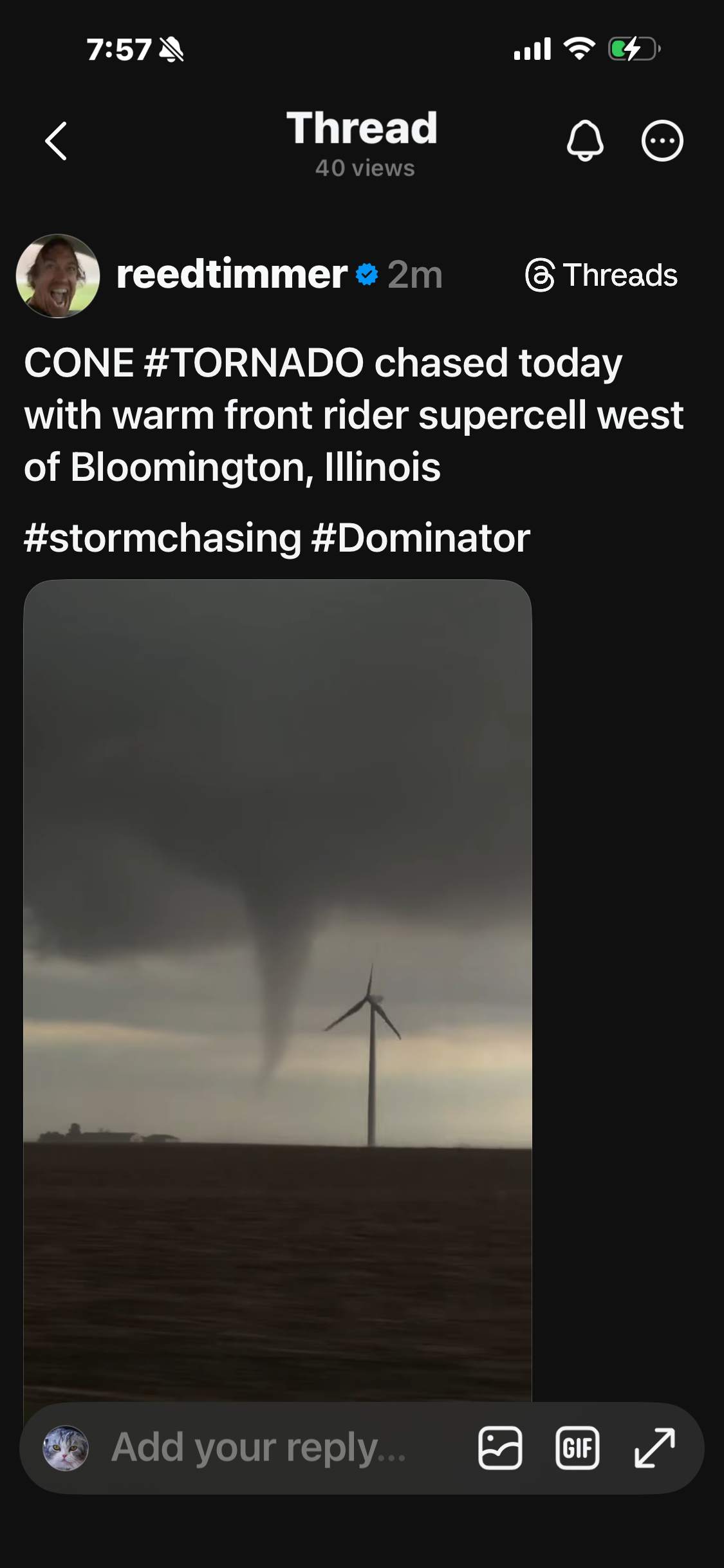

There was one west of us! One of the storm chasers just posed a picture.
