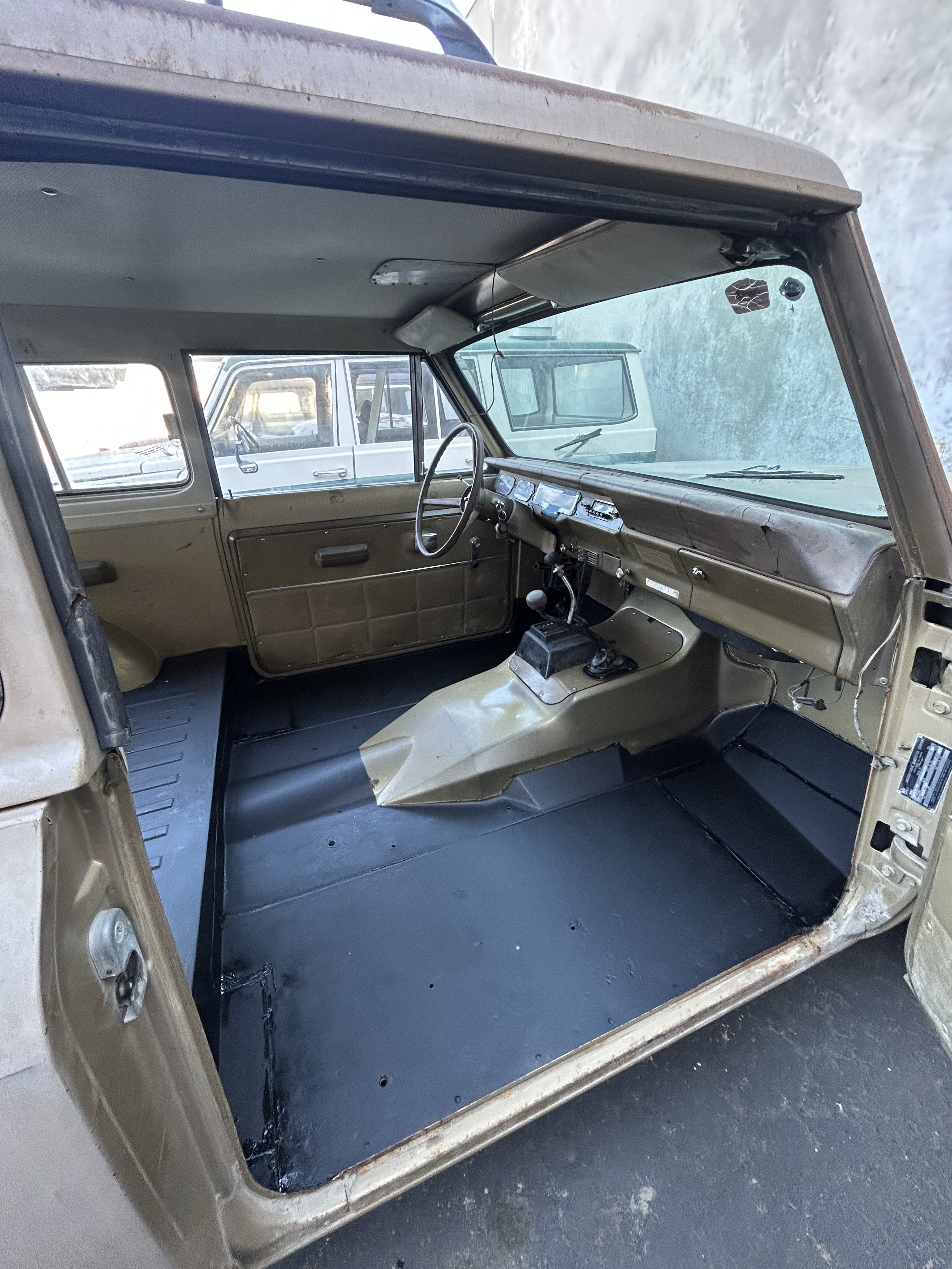

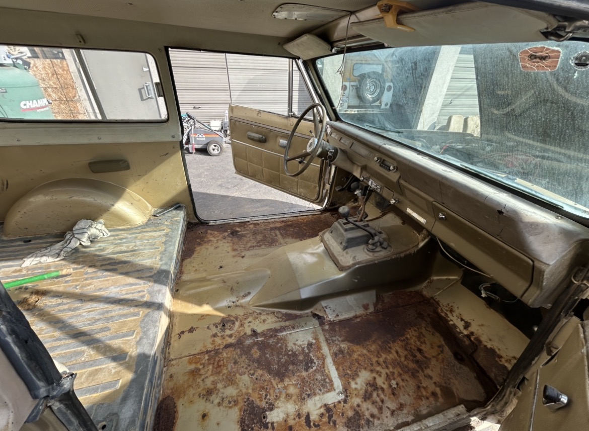

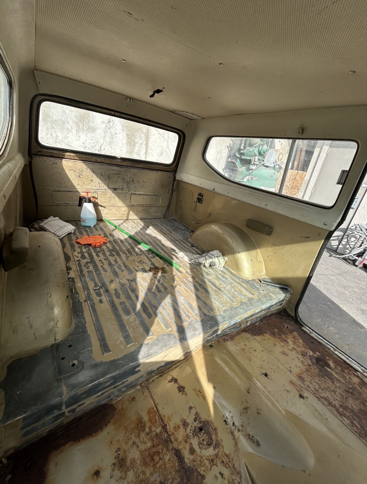

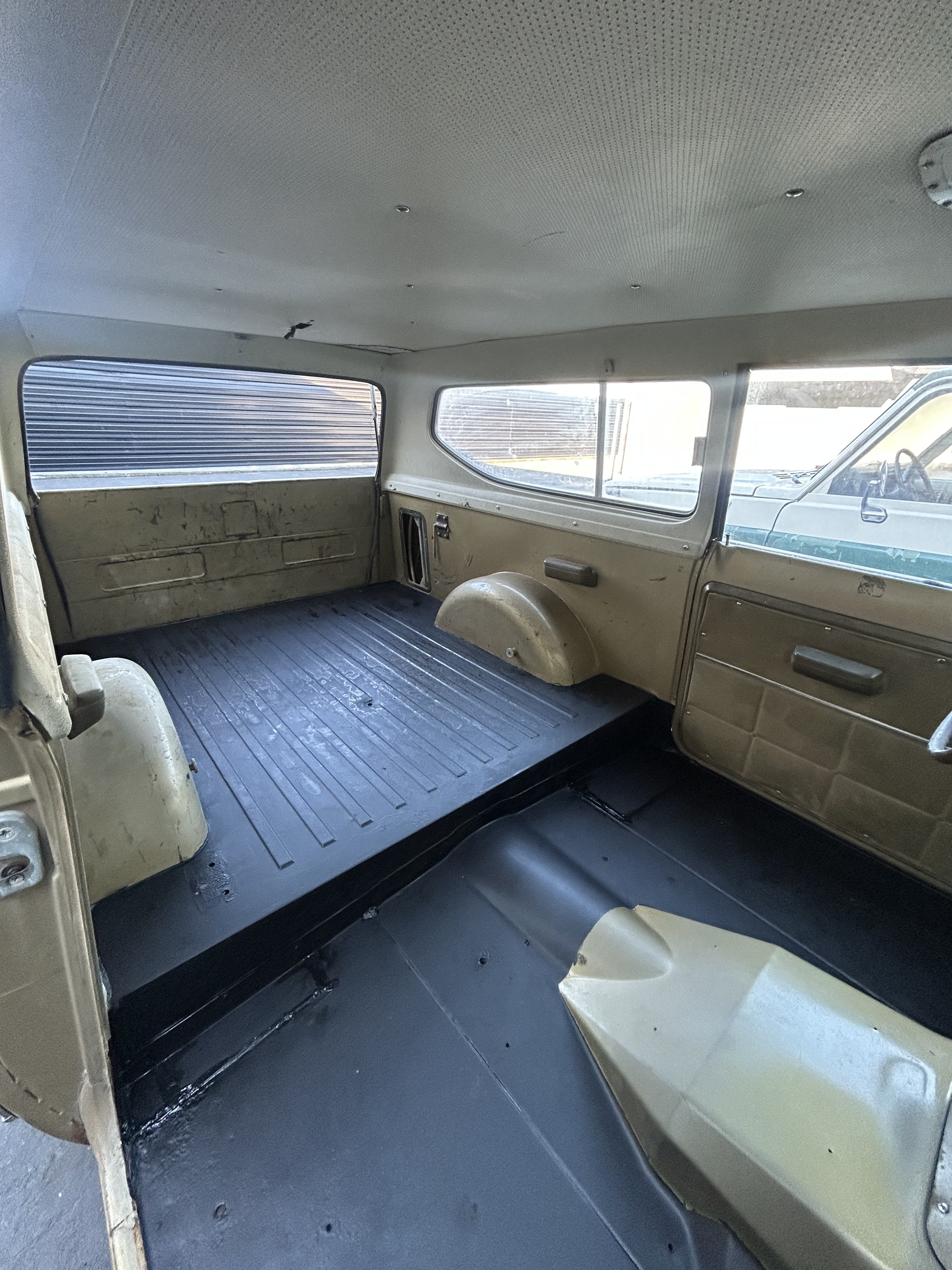

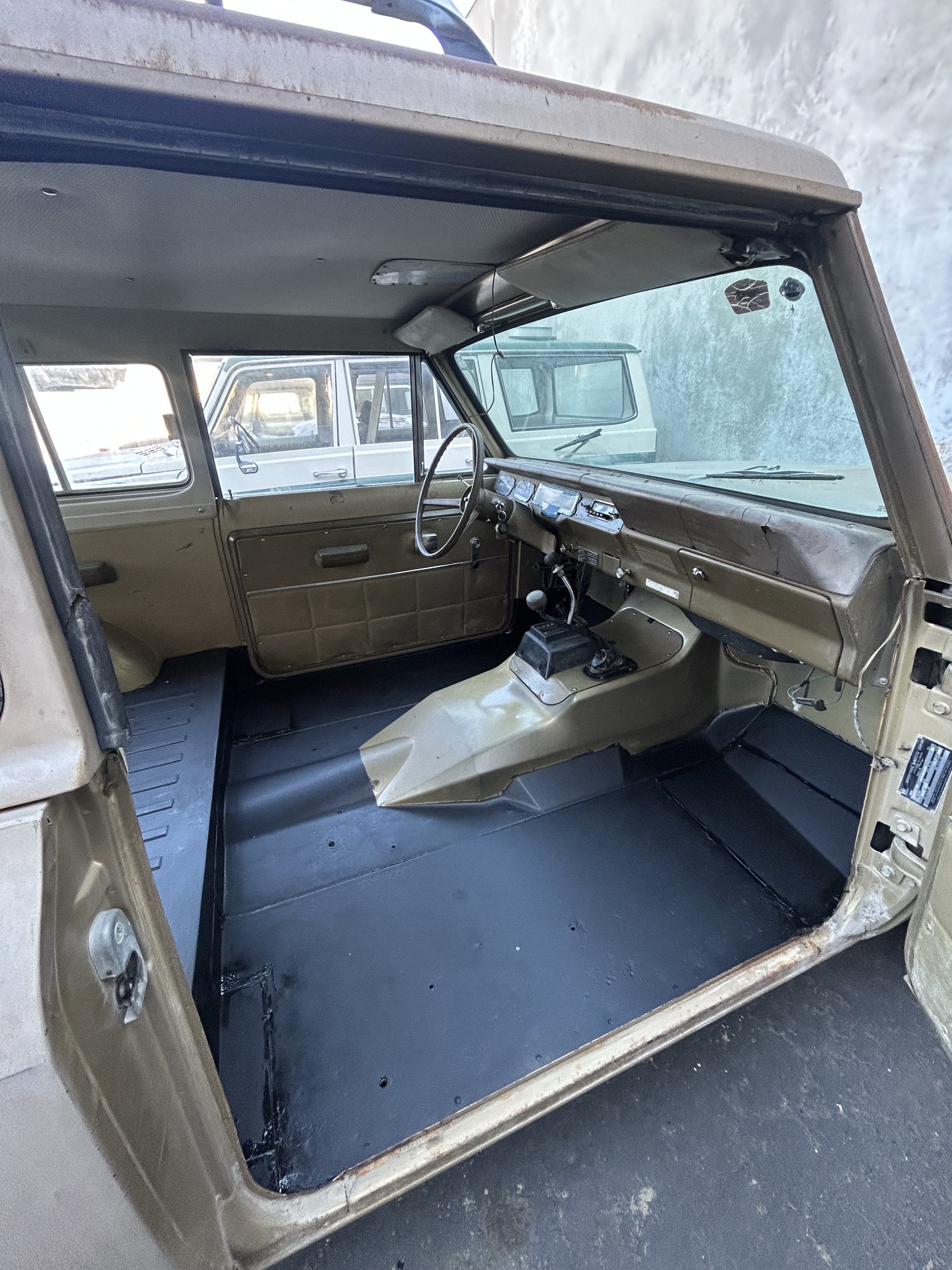

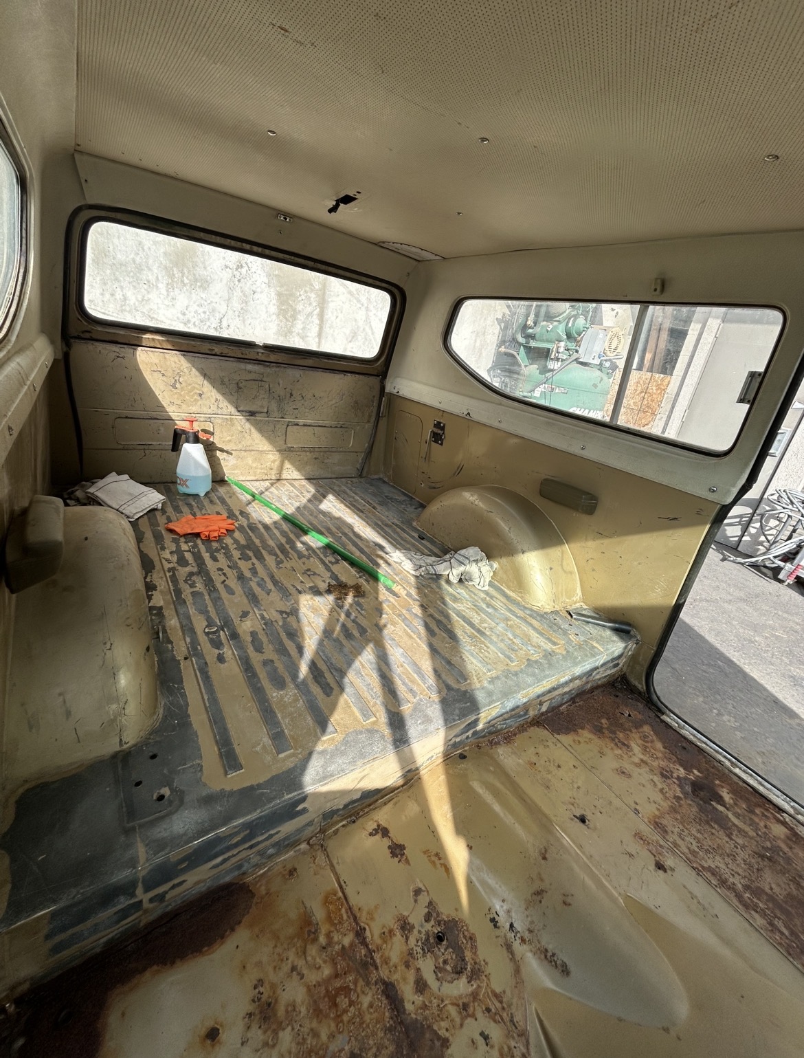

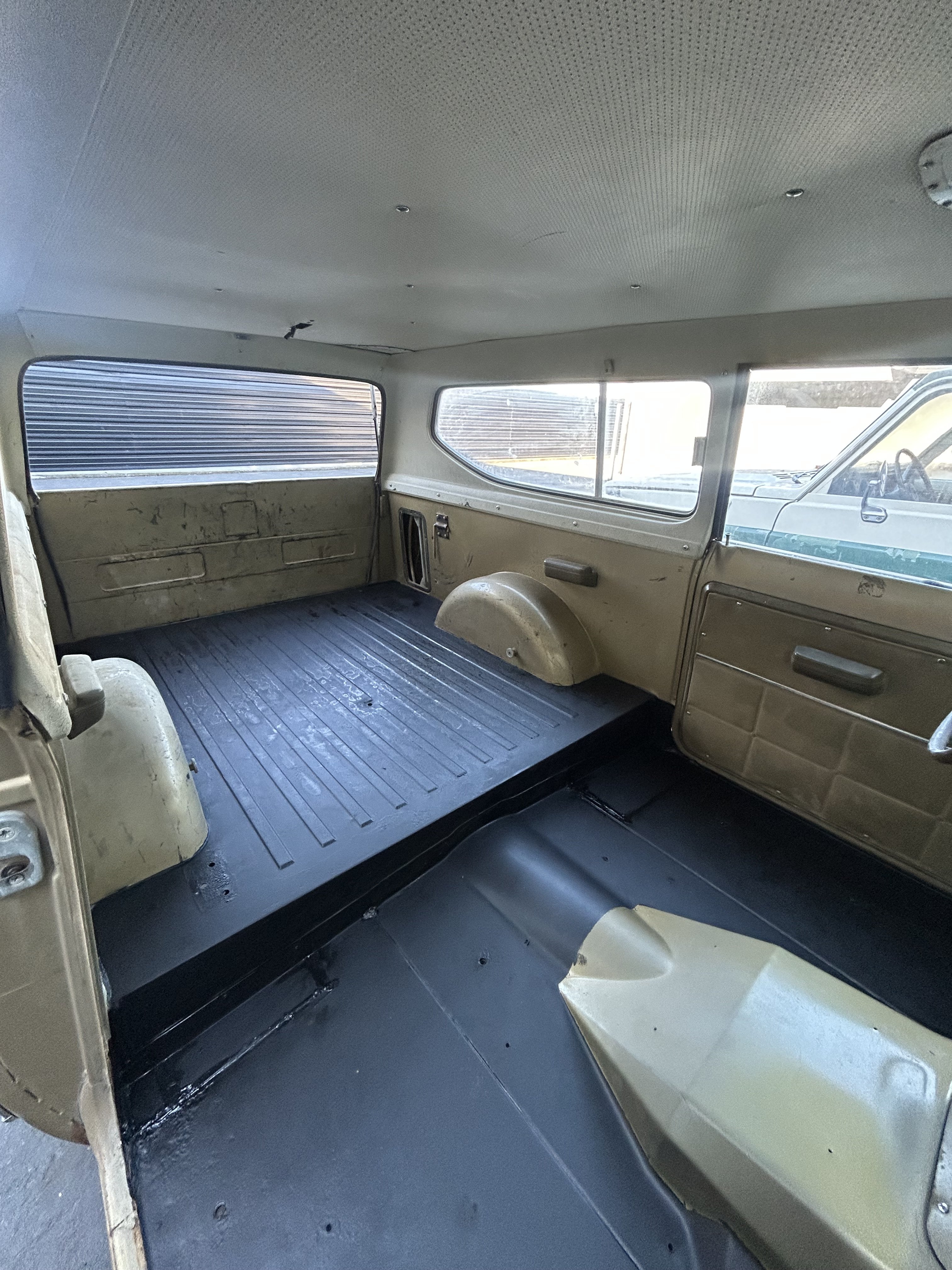

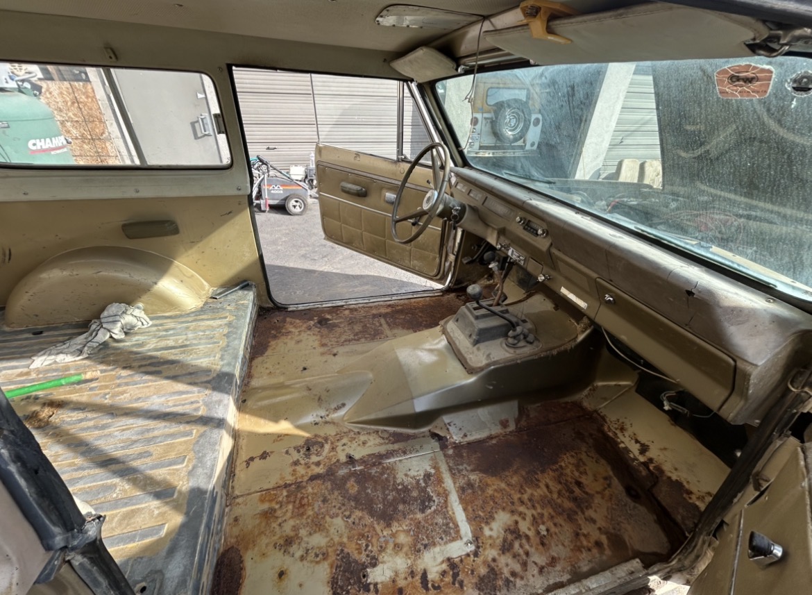

I still need to do another coat but here is a before and after!
What product did you use, also adding sound deadening?
I used POR15. I’ll eventually spray a bed liner, but it probably won’t be for a while, so I did this in the meantime. No sound deadening. I’m not planning on putting in carpet or the vinyl rubber floor. Maybe one day. This is my work Scout lol.

I used my grinder with a wire blade to prep the surface. Looking back, there are definitely certain areas I should have gone over more, but hopefully the second coat will hide it. It’s a beater Scout, so I’m not too worried about it. Everyone always tells me prep is everything. POR15 is pretty thin, so I would just recommend checking for runs. Have fun on the 800!
