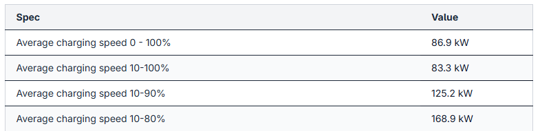

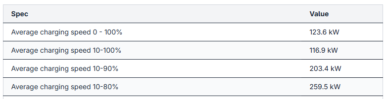

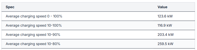

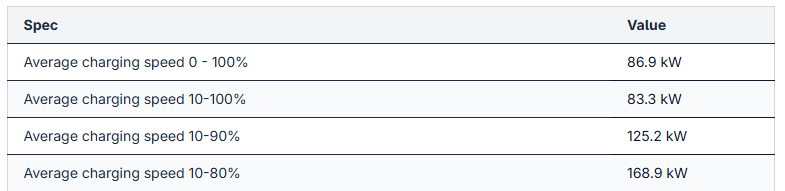

That was my assumption (having not actually DCFC'd yet). That is why I included the avg charge rate from 10-80% for mine, as thats likely the most relevant.
But even then, I hope that the Scout more closely follows the new Audi's avg charging rates than the Ioniqs (despite both being 800v architectures, the Audi almost 100KW higher in its avg rate from 10-80%).
Audi:
Hyundai Ioniq9
Reactions: SpaceEVDriver
Audi:
Hyundai Ioniq9

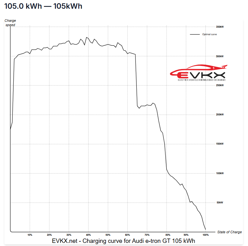

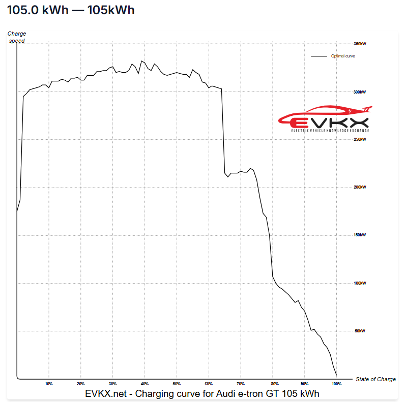

Check out this charging curve from Audis latest. It holds over 300kw from ~3% - 65%. As a result, it charges over 10 minutes faster to 80% than my Ioniq 9 (which is also 800v, and a decent charger). Thats a huge improvement.
More of this please.
It’d be interesting to see a 0-100% charging curve with time in the x axis.

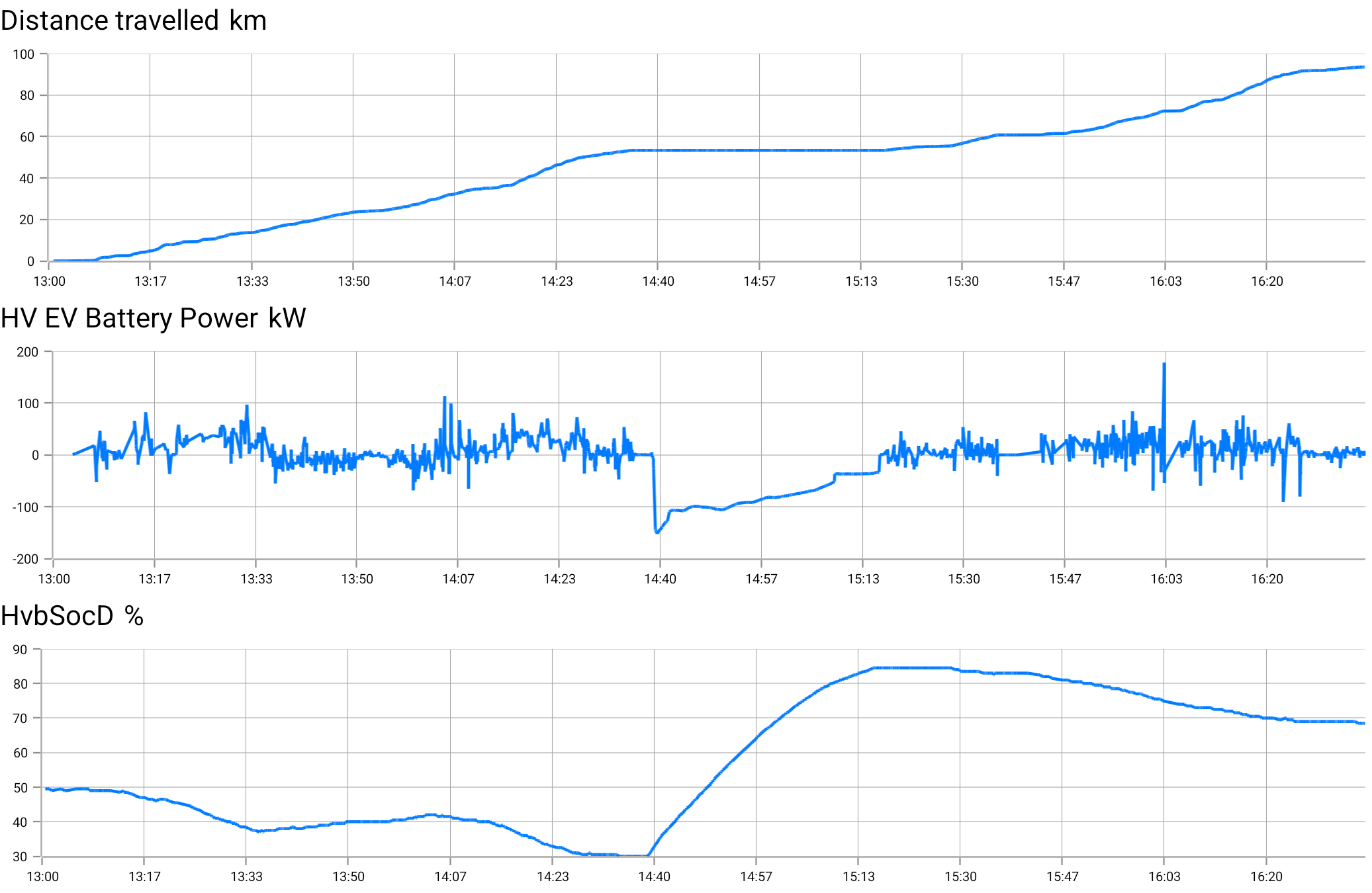

I don’t have one on a DCFC charging to 100% (because I never do that), but here’s a trip I took a few years ago coming back up the mountain after we went shopping in the valley. We drove the Mustang. We stopped to go for a hike and there happened to be a DCFC charger there, so we figured we’d charge up while hiking.
The top graph is distance. You can see the time was just about 2:30 PM when we stopped for our hike. We left the charger at around 3:15 PM.
The middle graph is the power from (positive) and to (negative) the battery. Lots of spikes when driving because we’re passing, slowing down with traffic, etc. Then at just before 2:40 PM, we plugged in to the DCFC. Looking at the curve, you can see a peak for a few minutes, then a flattening out, then another drop, etc. Because it’s energy going into the battery, everything is “upside down” in this graph.
The bottom graph is the state of charge vs time. We were driving up over a small mountain, then down it to get to our trailhead, so you can see before we stop that the state of charge is steadily decreasing (going up the mountain), then it starts to increase (going down the mountain), then we speed up (straight road) and the state of charge decreases down to about 30%. Then we stop and plug in just before 2:40 PM. The state of charge climbs steadily until about 3:13 PM, at which time it kind of flattens out because the charge rate has decreased quite a bit above 85%.
