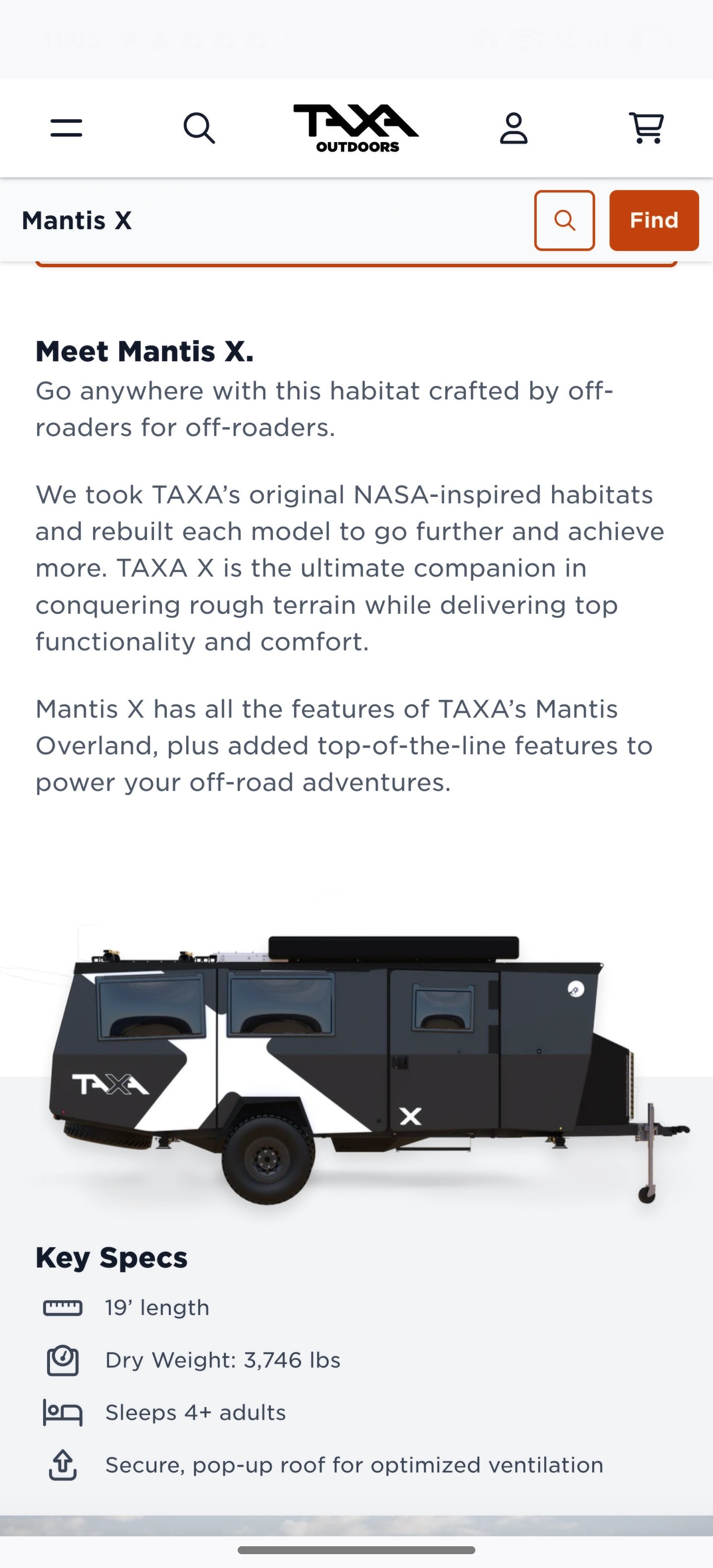

The Taxa Mantis X is also pretty cool but it has an inefficient window unit for AC and standing room is quite limited.
