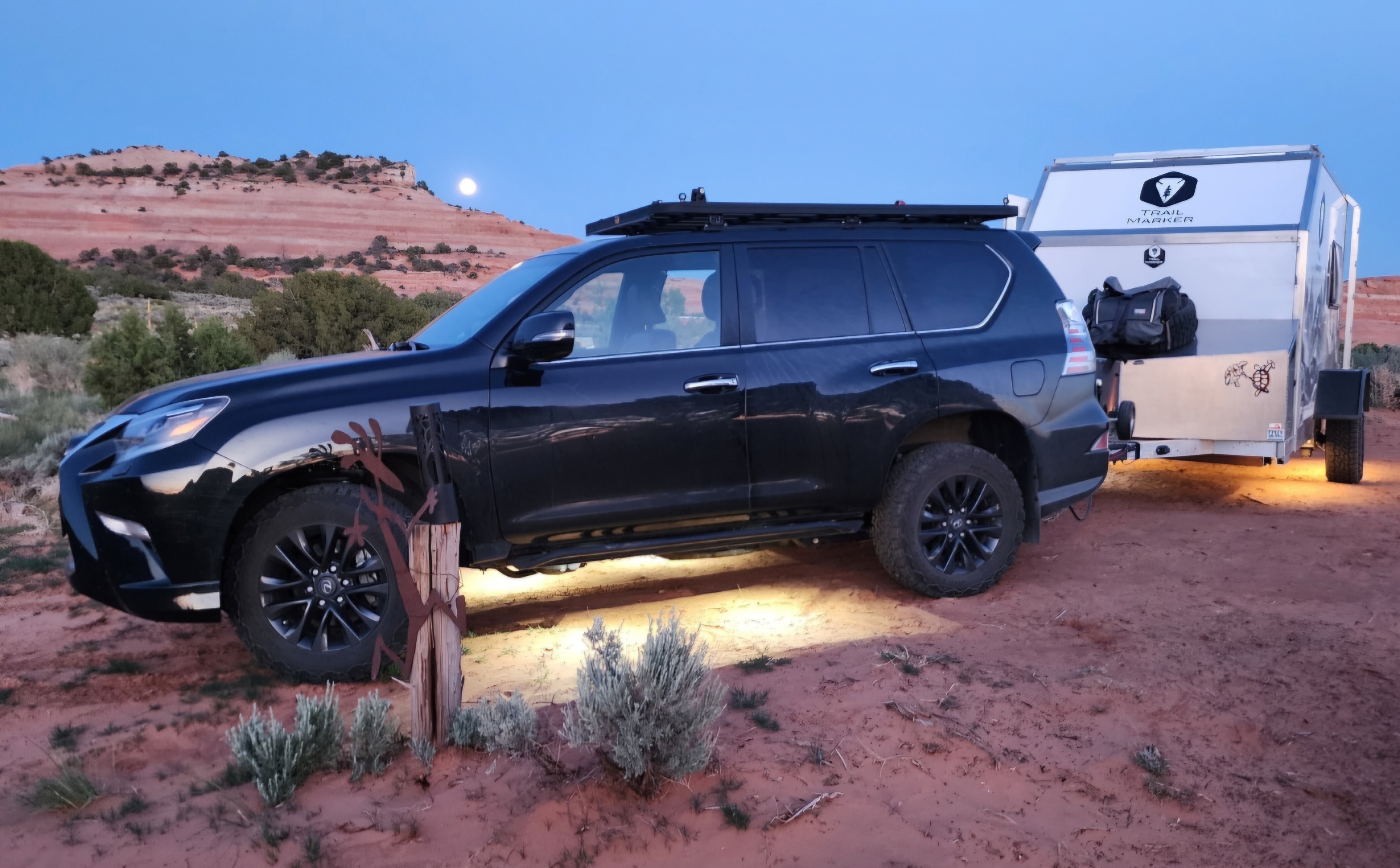

Hey Chavannigans I know this is off topic but wanted to show my GX to you going to miss her when my Terra BEV arrives.

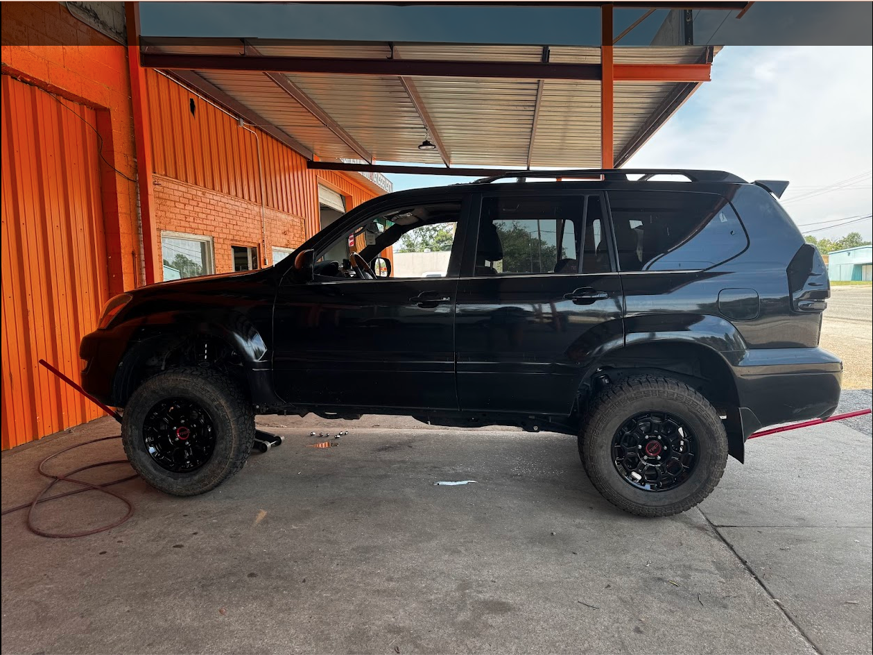

Shes a beaut Clark!
Great to meet another GX owner here. Wish you could keep both lol.
What year is yours?
We had two of them for a while, but the wife got pregnant with kiddo #4 and she wanted something easier to get them in and out of so she traded the 2012 in on a Honda Odyssey. She wasnt a fan of the rooftop tent either. I still havent emotionally recovered from the ordeal. Had it pretty well sorted on 34"s and planned to add portals down the road.
Now its down to just my 2004 and my motorcycle for adventures :(

Assuming this was meant for me and not Clark 😉 or maybe it was a superman Clark Kent reference.
My GX is a 2023 Luxury wth off road package the last of its breed. I mean it came stock with a Carl Levinson single disc CD player in 2023...crazy
Stock suspension with Ko2s 10 ply, rocky road super sliders, front trim cut and a 4x4 Big Country rack. Love the sheet out of this rig but 9 mpg while towing trailer keeps me up at night. Not that any other ICE vehicle could tow my trailer with any significant improvement on MPG. Which is why I choose the Terra BEV.
