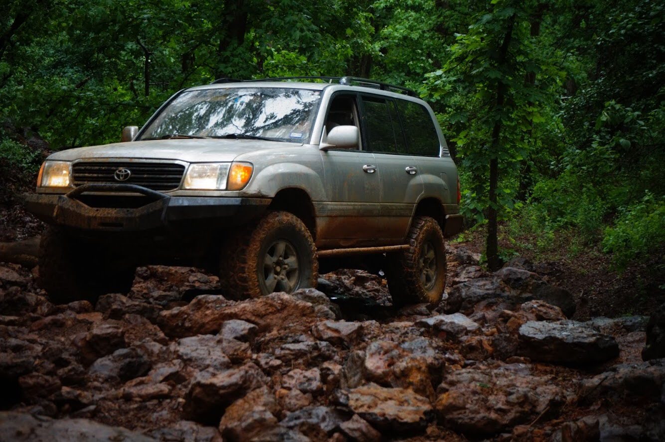

Lets have a discussion about gear ratios.
I come from the rock crawling/overland world.
Gearing is a make or break for slow speed control, as well as efficiency.
I had a 100 Series Land Cruiser that I could get up just about anything I pointed it at.
When I installed 35"s I wanted as much gear reduction as I could get, so I installed 3:11:1 low range transfer case gears, and found a way to get 5.29 gears to work with the factory e-locker rear diff using a hybrid carrier from an 80 series with the side gears of the 100 series. It was a goat. My fuel range per tank also INCREASED going from factory 4.30 gears to 5.29s. While the tire size ratio is roughly 14% larger, they also weighed more so the engine wasnt working as hard to spin those big meats. The gearing difference was approximately 23%, which is a lot more than the 14% difference in tire size but it felt right, if that makes any sense.
