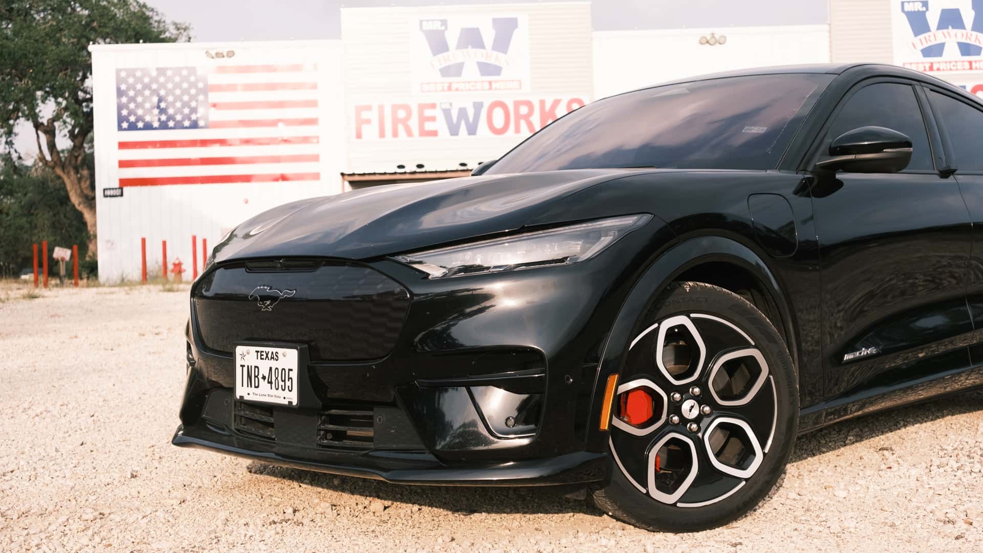

But the Mustang Mach-E relies on electrical power to activate the door plunger to open the door from outside. There’s a software error where if the low-voltage battery is low/dead, and if the door is opened by the interior mechanical handle, the car doesn’t change the door lock setting.
An example of how this can be problematic: A care-giver driving the Mustang has a child in the rear seat. They stop the car, exit, close their door, and go to open the rear door. If the low-voltage battery is low or dead, the car could remain locked after the driver exits the vehicle and closes their door. Then because the battery is low, the rear door will not open (because it uses 12V electrical power to engage the door plunger). The child is locked in the car with no way to get in without breaking a window (unless someone carries an emergency battery on the exterior of the vehicle somewhere, which nobody realistically does).
