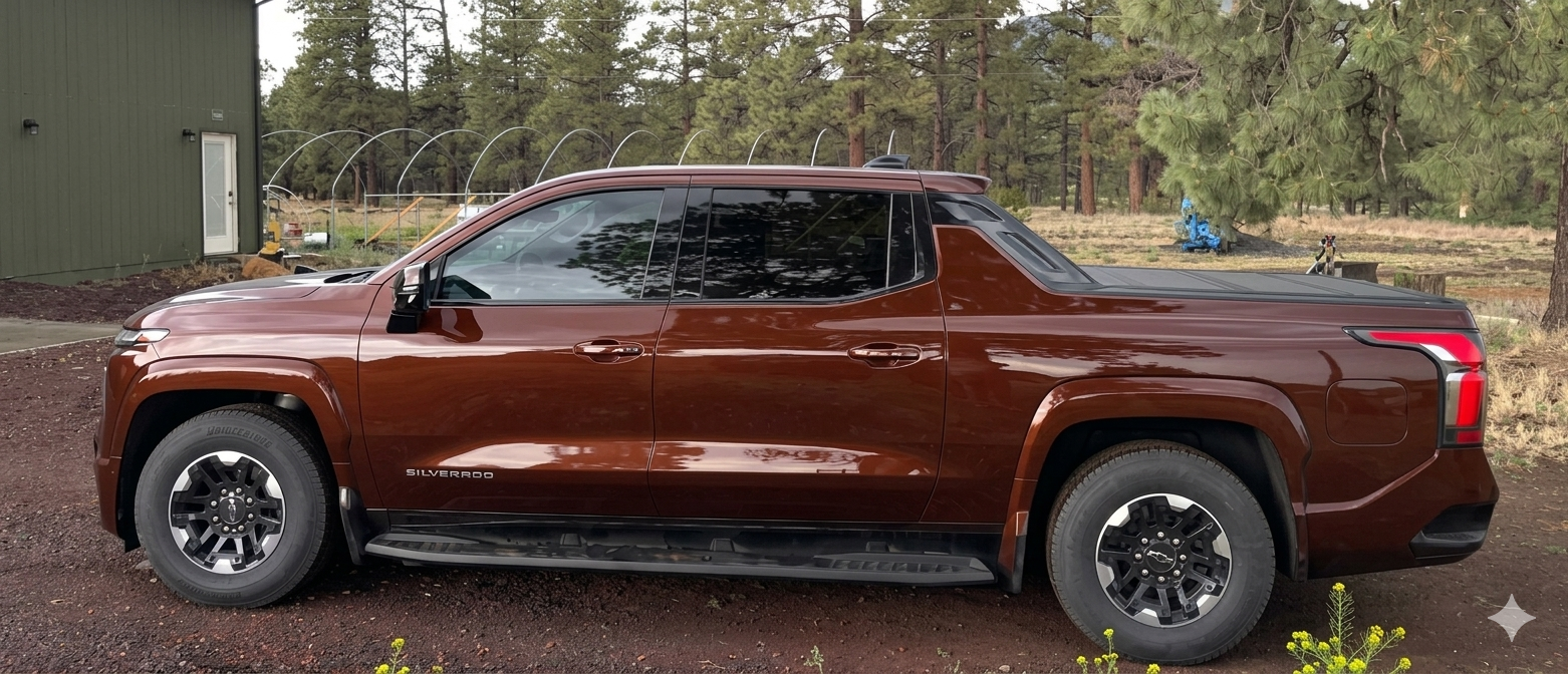

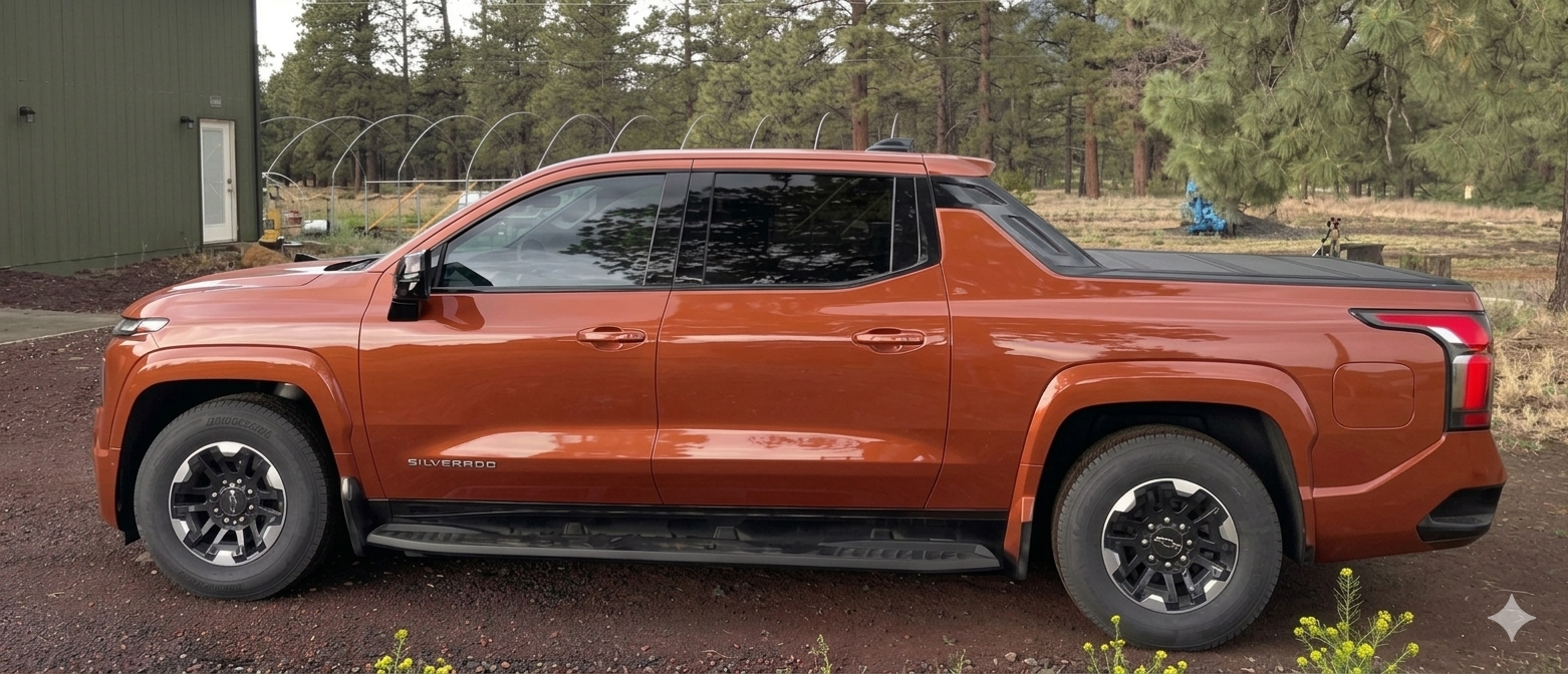

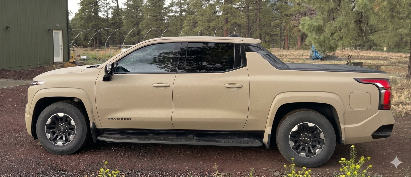

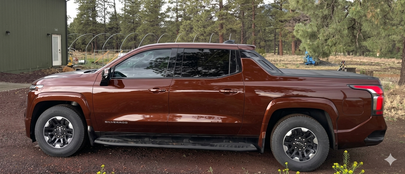

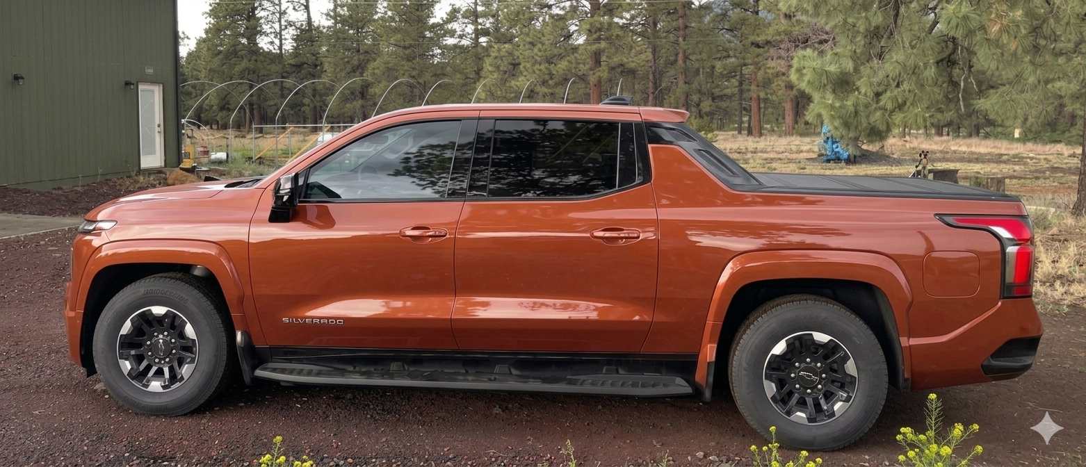

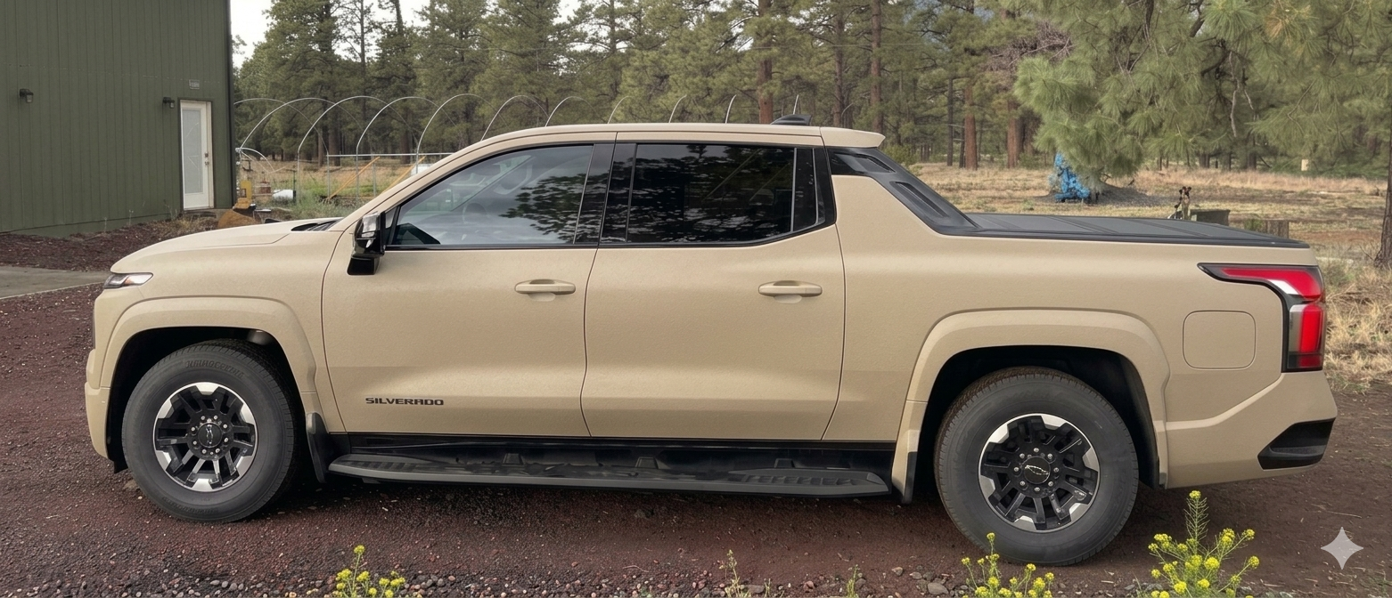

I’m about 50% leaning toward a terra cotta / sandstone / burnt umber wrap for the truck. The heat this thing collects is too much.

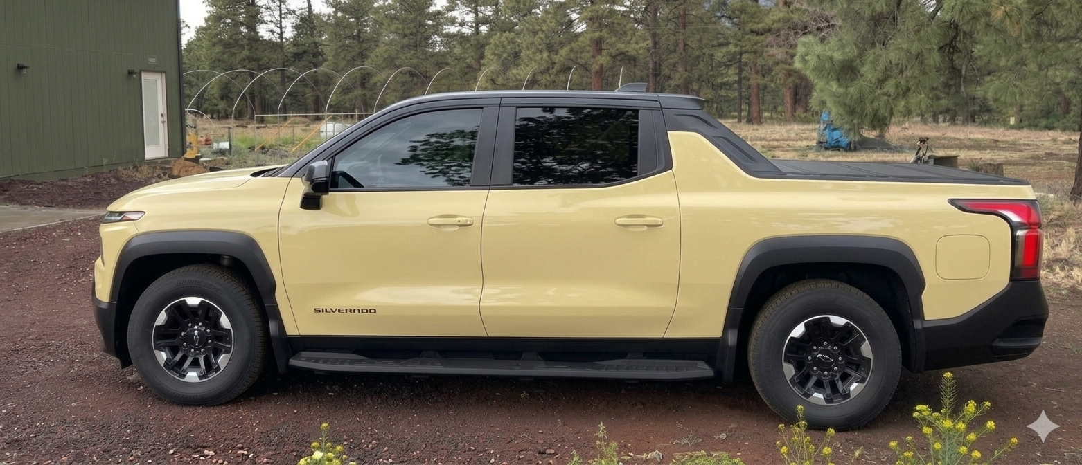

I just replaced the 24” wheels and 35” tires with 18” wheels and 33” tires.
Specifically, I got a set of four Bridgestone Alenza A/S 02 LT265/70R18 on closeout for $129 each. These are AS tires, not AT tires. I don’t usually run AT tires unless I am planning a long trip offroad.
These tires have a load range of E, 3525 pounds maximum load, a Service Description of 124/121S, compared with the OEM tires Service Description of 121/118S and max load of 3195 pounds.
I also found a set of 18” Hummer EV takeoffs for a decent price.
Going from the 275/50R24 to 265/70R18 means a decrease in diameter from 34.8” to 32.6”, so a reduction of 2.2 inches in diameter.
The weight per corner for the OEMs was about 120 pounds, for a total of 480 pounds for all four.
The weight per corner for the Hummer wheels are 39 pounds, the tires were 44 pounds, for a total of 83 pounds per corner, or 332 pounds for all four. That’s a savings of around 150 pounds of unsprung weight, and a significant savings of rotational energy spent on spinning up the tires.
I can lower the air pressure a bit and still have OEM-like load capacity. I’ll probably run it with just a few PSI lower than the door jamb recommends. The recommended pressure is 61 PSI front, 68 PSI rear. I’ll probably run it at 58 PSI front and 65 PSI rear, but I need to sit down and do the calculation.
I took it for a 21 mile round trip test ride before and after, but a rain storm blew in before I could finish swapping, so the after test was in the wind/rain. I need a longer drive than this to really understand the impact. Note that the smaller diameter tire has a 6.3% smaller circumference, which means the odometer gives me a 6.3% longer distance measured than actually driven and a 6.3% slower speed than reality. I still need to learn how to reprogram the odometer and speedometer. A 6.3% smaller tire should give a 6.3% better efficiency reading when just doing distance driven divided by energy used. But a smaller, lighter tire/wheel combination will give a better real efficiency. I didn’t do a great job of measuring the energy used before and after, and the weather changed dramatically between the two test drives. I may swap again to do a longer, better test.

Amazed how low it appears to sit. Looks almost low-rider like due to the length
Ha, when it comes to color we all have such different likes. I can’t imagine being on the SM color team.
Now PBY, I think we can all agree is the best color.
I think those of us wanting PBY are possibly going to be disappointed but I’ll keep hoping. Been starting to think what color direction I’ll go. With daughter wanting a terra (if she lives at home a bit after graduating this comes ng year, it may afford us two color opportunities so that will be fun
What color does she want. Does she have any idea?
And I’m not giving up my PBY hopes yet.
We're looking to the Traveler or a used Gravity (assuming they have dramatic depreciation) to replace the Mustang. I like the terra cotta / Tahitian Red, but would probably go with a sandy color for practical reasons.

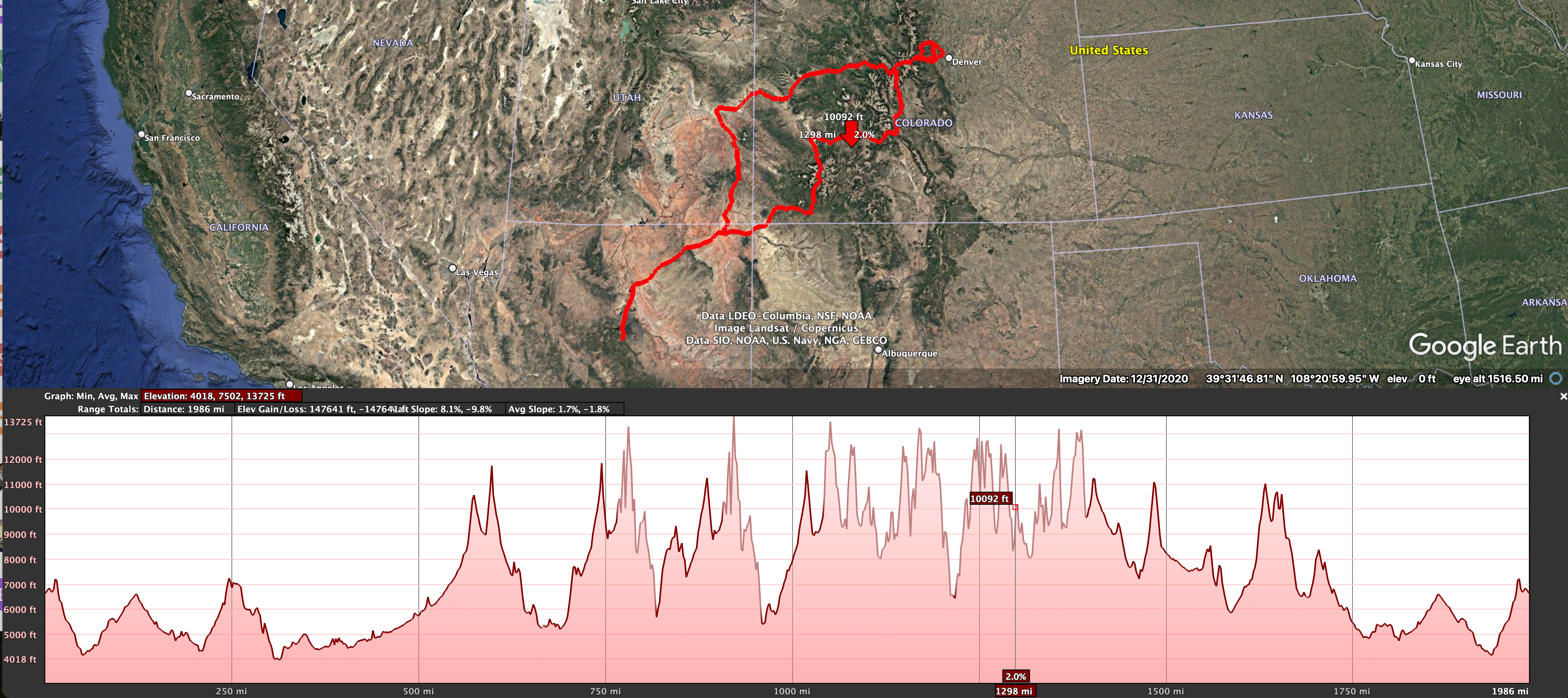

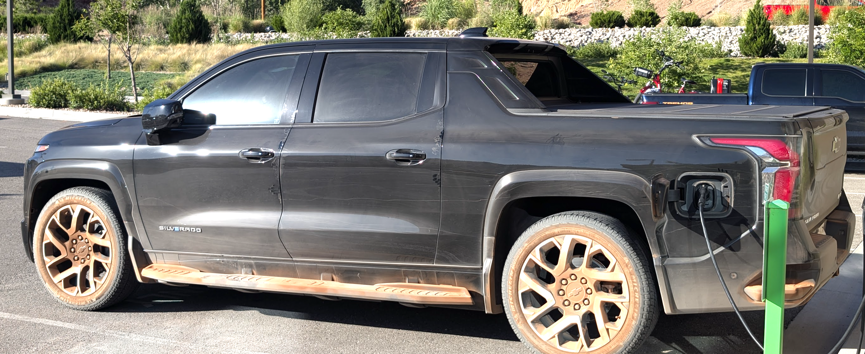

Well, I just added up the cost of charging for our ~1600 mile road trip from northern AZ, through northeastern AZ, southern and eastern Utah, through the Rockies to Boulder, CO, and then through the Rockies and back to southwestern CO and across the northeastern AZ desert back home.
For about 1600 miles, most of it up and down the Rockies, we paid just under $160.
We were able to do that because we could skip quite a few DCFC chargers and go on to Level 2 charging overnight (or over several days). If we had been even more picky, we could have saved another $50 or so.
I could get used to this.
