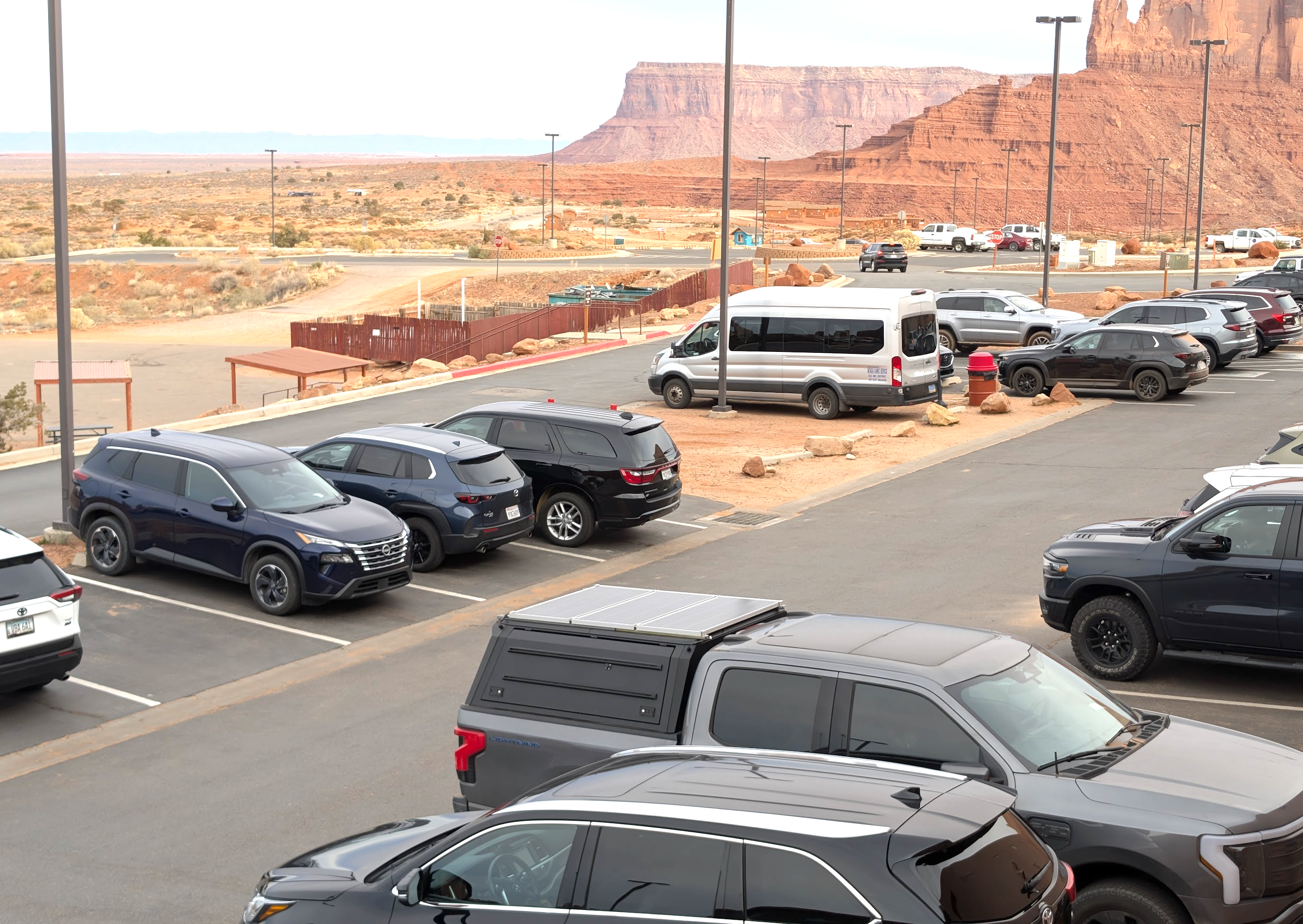

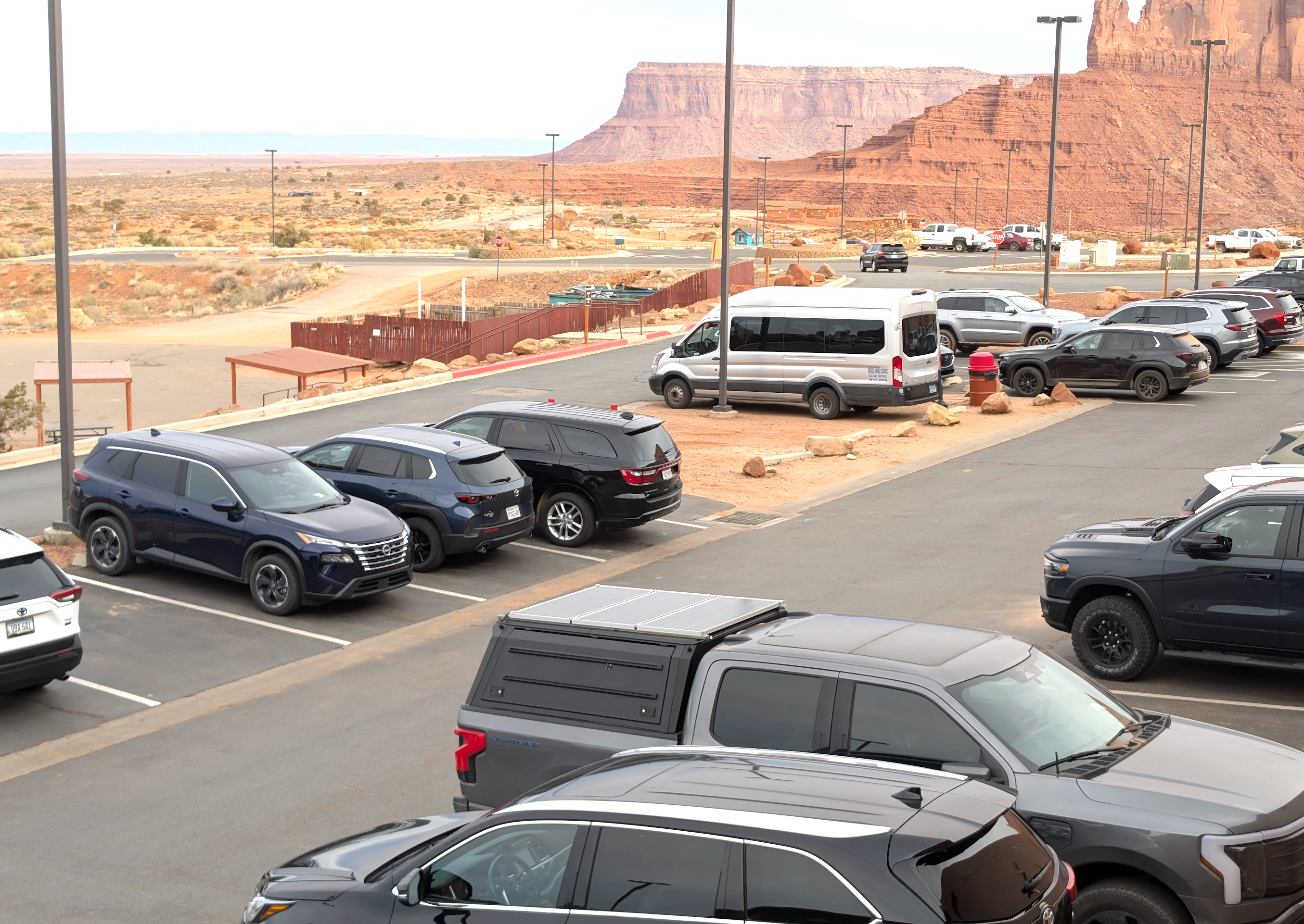

Here’s another cellphone pic taken from above to show the 300 Watts of solar that was used to run the fridge in the bed of the truck. Totally not necessary on this trip since we had L2 charging at the first hotel and the townhome we rented in Moab. But it’s necessary to do shake-down runs when setting up a new configuration. I’ll probably add a 100 Watt panel on the side doors of the cap too.
I was able to charge the truck for about an hour using the L1 charger drawing from the power station. It worked exactly as it should have. But there were some issues with the panels recharging that power station due to some kind of internal issues on the cheap power station. I will do some diagnostics over the next week. I may end up using just bare batteries and an inverter instead of the power station.
