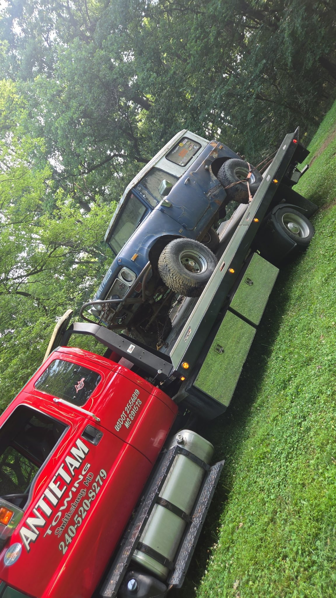

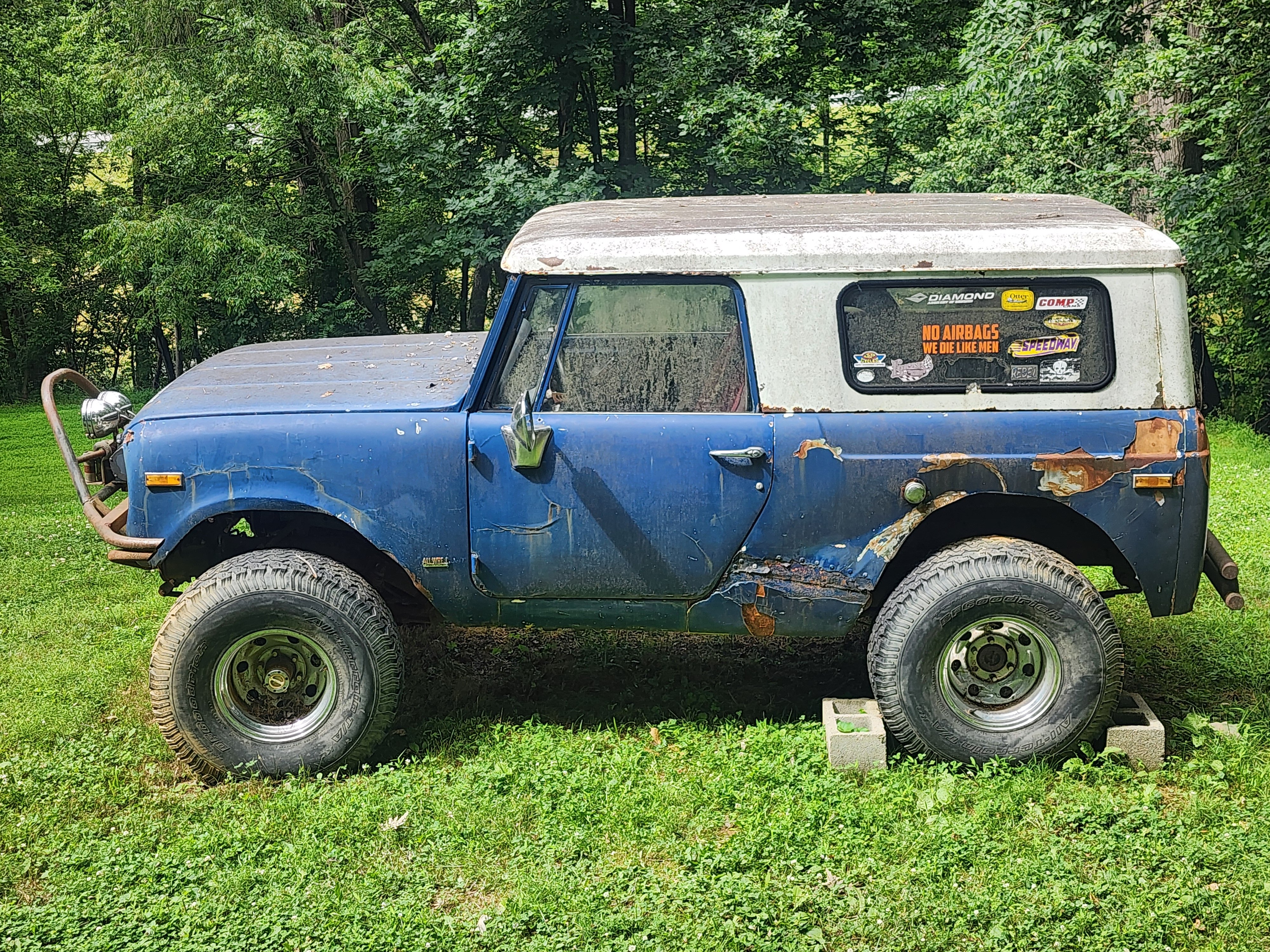

After a strong storm that resulted in many trees down in the area persuaded me to stop neglecting this project. Having it taken to a local shop today for engine work, replace the gas tank, and brakes to let the tear down of the cab begin. Plan is to just get it running and enjoy it for its purpose.
Then she's off...

I asked to have back by October just so I can use to plow. When it returns I plan to strip the interior and add sound deadening with carpeting and add a bench seat with a pendelton style design and replace all the window seals and do a wiring harness.
Keep us all posted if you have time. Gotta show up those young Colton-like guys 😀
We did, crews are still out removing trees. It looked like a tornado came through although nothing confirmed. I had this 800 sitting at my relatives house and was a bit nervous to give him a call as it's surround by trees, luckily it dodge it and persuaded me to stop neglecting this rig. We have another one coming through tonight with flood warnings.

She is beautiful just as she is!
Thanks. I agree, it tells a story of the vehicle which I plan to preserve so if future dents and dings occur it just adds another chapter. Its a chevy 350 under the hood, that may change at somepoint,if it does, then I would have the engine bay cleaned up, actually thinking of doing a cummins r2.8. Looking forward to getting this underway and using it for trail running,grabbing coffee around town and pushing snow.
