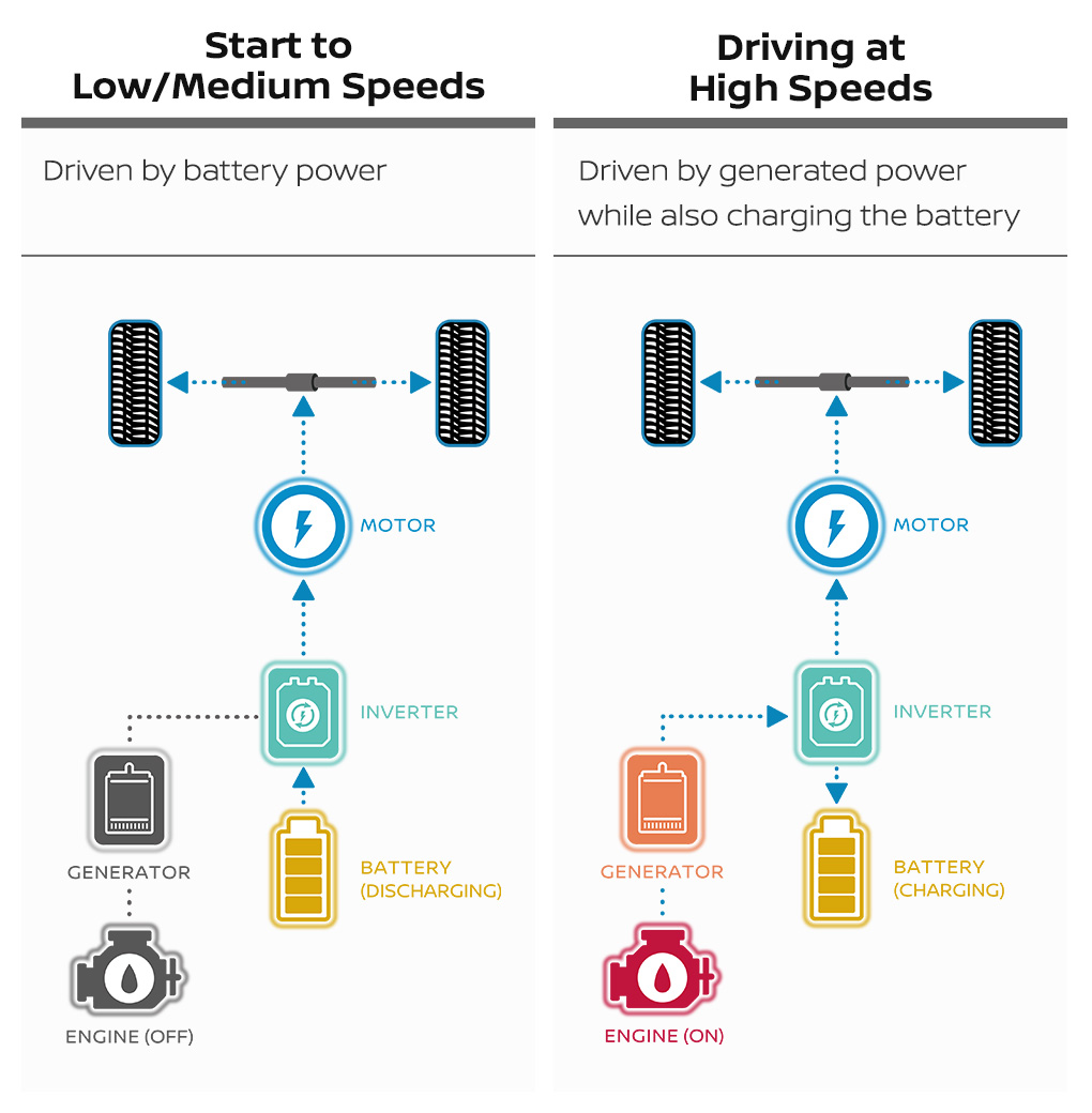

Tough crowd.I'd suggest paying attention to this previous post:
It contains this handy reference image. It's from Nissan, but all Series Hybrids work like this, but the post also has a nice explanation by a lead engineer:

And also, to create a constant 35kw (without towing), you'll want bigger engine so it doesn't rev to 5-6k RPM to give you that 35kw. You'd want something capable of 90kw then run it at 1500-2000rpm to generate 35kw, for the NVH experience of the passengerI've had to work my way up to it. And ask around, I still screw up the units.
So, here is how it maths. Sorry, words alert.
If we know that its 2 miles per KWh, then to go 500 miles, we need 250KWh of energy. And with the Harvester, we know we start with ~75KHw in the battery. That means we need to generate the other 175KWh of energy with the Harvester generator. But its how we do that that matters.
If we do the "start the generator the moment we leave, and let it slow down our battery drain", we don't need a huge generator.
500 miles at 70mph, is a smidge over 7 hours (70mph x 7hrs = 490 miles). Which means in theory we only need a generator to provide 25KW per hour, to keep up with that (7hrs x 25KW = 175KWh). That is a pretty small generator. Like the BMW i3 REX used a 0.6L motorcycle engine, that produced that much.
Alternatively, if we know that we have the "2 miles per KW" efficiency at 70mph (estimate, but makes for easier math), that means in an hour, we've gone 70 miles, but also used 35KWh of energy (70 miles/2 miles per KW == 35KWh). So on flat ground, we'd need a generator that can produce at least 35KW of output to keep up with 70mph cruising.
That said, the 35KW is the NET amount of power we need from the generator, not the gross. This is because there are electrical inefficiencies (converting the power). And obviously if you want to go up a hill, or tow, that number is going to increase. But the math says that in theory, in perfect conditions, you don't need a "huge" generator to slow down the drain.
Now, I think they're not going to design for flat ground, and I think they're "more likely" going to be doing something closer to the "gas and go" approach for the harvester. Which means I'm personally thinking the Traveler will be getting something more in the ~80-100KW output range myself, but thats totally speculation.
The Ramcharger is using a 130-190KW V6 as its generator. They're clearly getting it set to tow.
