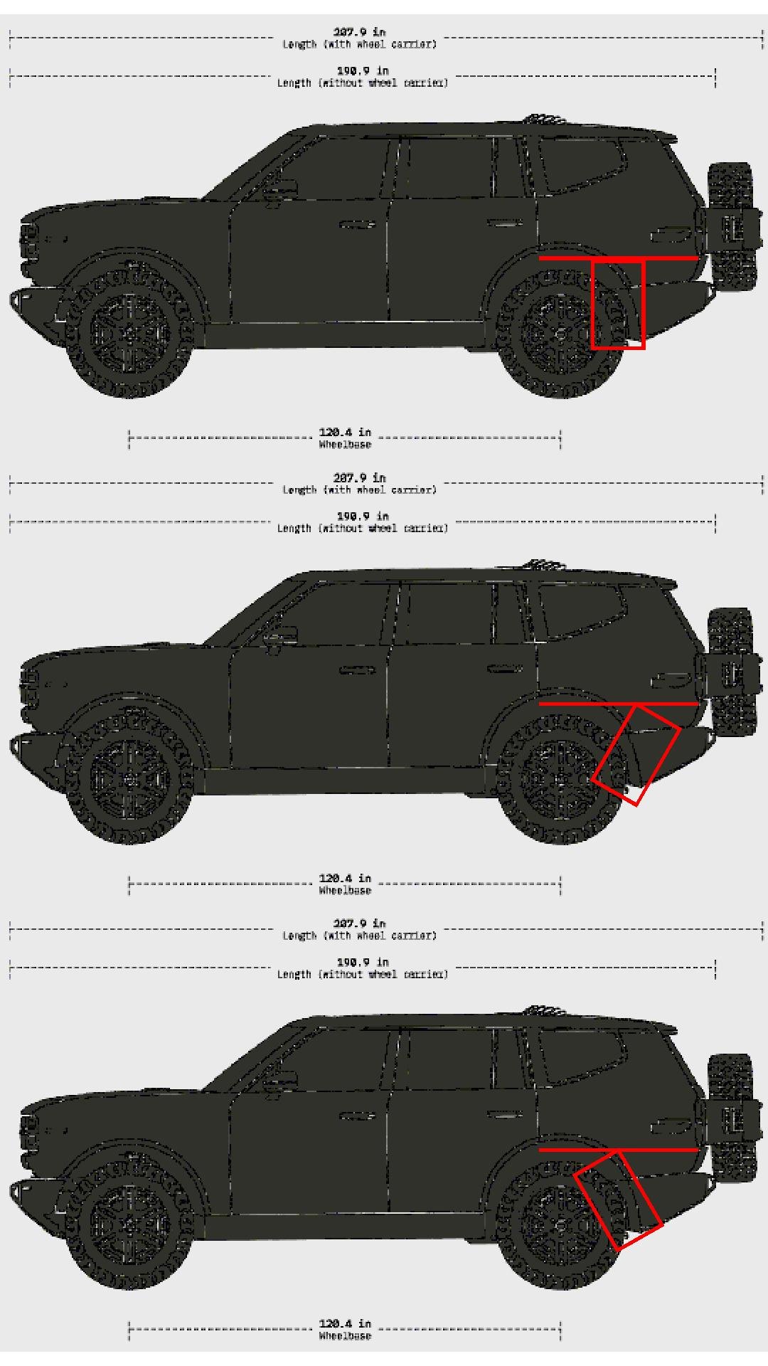

You know what happens when you take a 2' tall engine and cant it 25 or 45 degrees? It gets even taller, so then you're looking at something 26"-27" tall to fit into a space that already doesn't have room for it unless they put a huge lump in the cargo floor. Sure, you can lose most of the oil pan off the bottom and reduce that by a few inches, but that's a huge lump of aluminum to squeeze into a part of the truck that doesn't have much room.
Quick picture, to scale. Red line is the cargo load floor while the rectangle is an EA888 (with oil pan for now).
let the engineers deal with. I've worked with highly strange engine and mounted engine. And I don't know where you're getting that the engine grows in height. it's on a slant. also, nice diagrams. only thing, is that its mounted above the axle not behind. that's why it's going to be mounted completely flat. Its more likely to be a EA211
But this is the speculation thread, haha. I agree, it'd have to be on its side. The original renderings show the engine behind the axle and I think it'll have to be there to allow the solid rear axle some room for uptravel. There's not enough space directly above for an EA or a flat-4. Too bad though, as having it directly above the axle would probably allow for the higher tow ratings of the full EV version.
