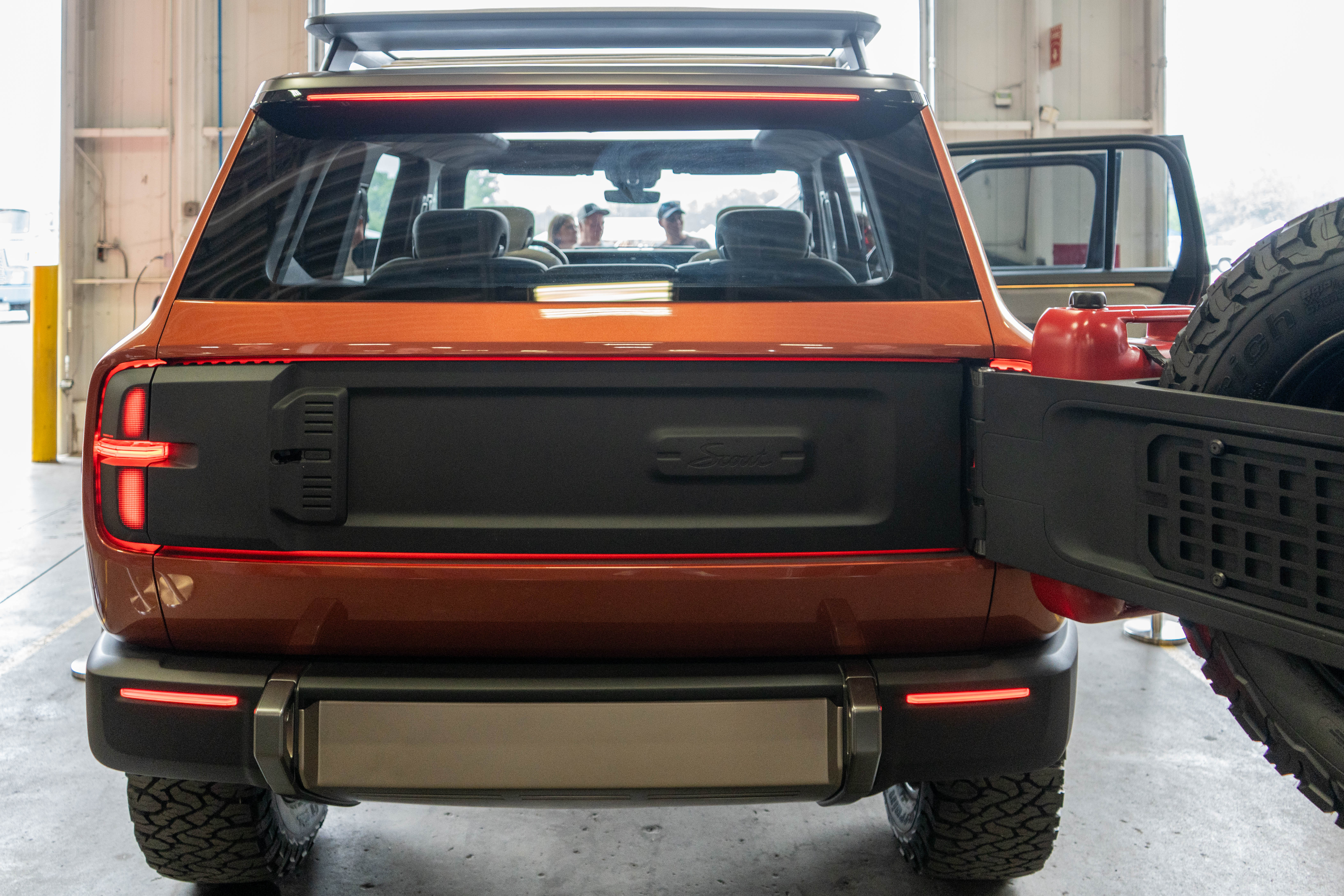

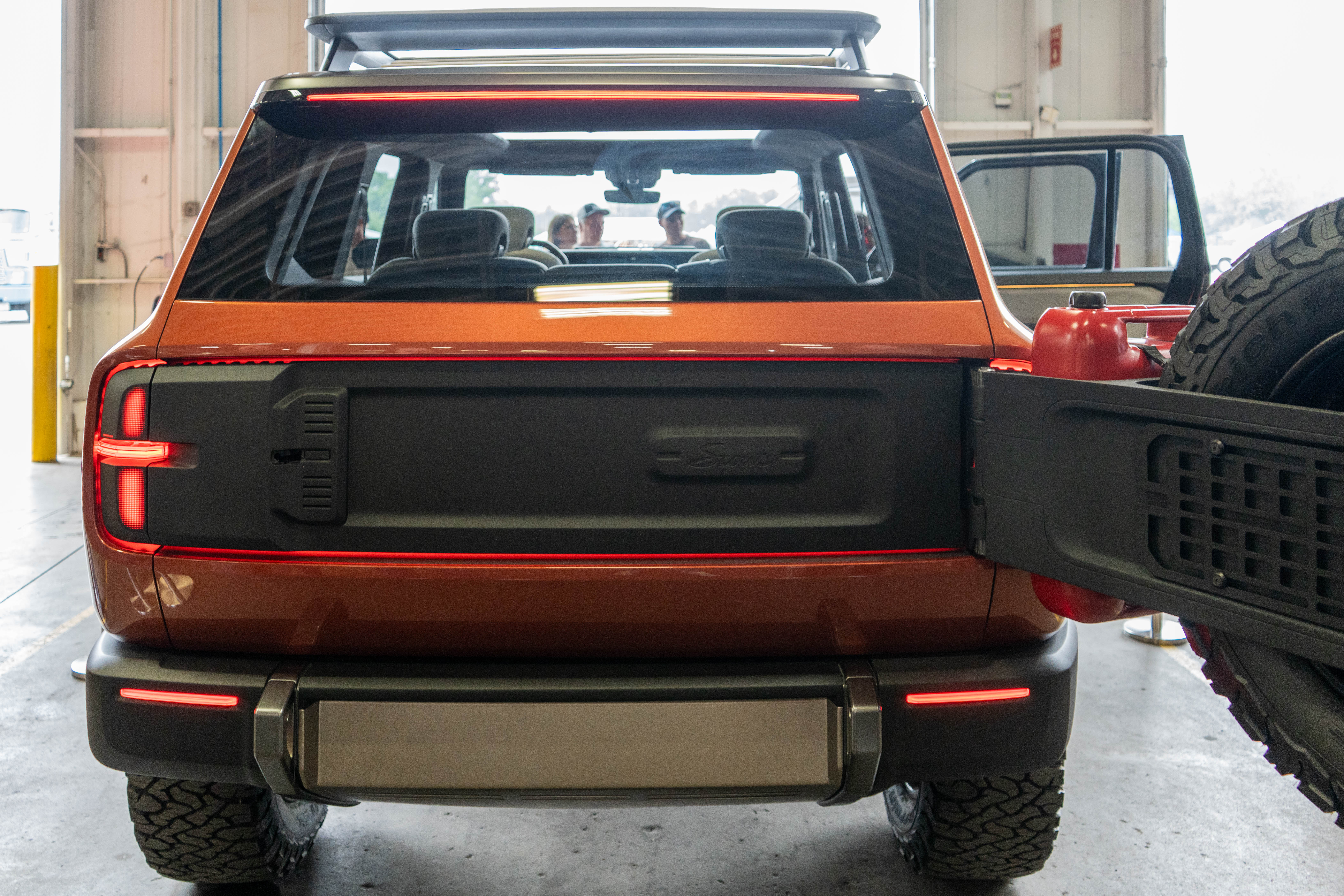

I have a question. The Traveler tire carrier is attached and has a latch when you close it. If it’s optional and you remove it you are still going to have the hinge and then the hole where it latches. Occasionally I will see a Wrangler with the rear tire removed and the bracket is on the back just with no tire.
So what’s everyone expecting it to look like without the tire carrier on the back of the Traveler?
Here is a picture I took at Nats where the tailgate was closed but the tire carrier hadn’t been closed yet. You can see the hole the latch will go in on the left.

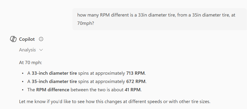

We are both thinking about old ICE drivetrains, but it still isnt know if running mismatched tires with 2"+ od diameter difference will cause traction control issues on an EV.
it might think the smaller tire is "slipping" since it is spinning faster and cut power to that axle, or even apply the brakes to that hub.
Maybe @SpaceEVDriver or @R1TVT can experiment for us. Ha

There is a filler panel that contains the license plate on the left side. Hopefully we have something to show you all soon on that front. :D
Well now I have another question. If you don’t want to remove the tire carrier is the license plate going to still be on the left?
Oh, good point.
I'm especially curious about the hinge on the right.

And, using AI to do some math I wouldn't really want to do myself, I see that a 33in tire spins 41rpm faster than a 35in tire at 70mph.
Which is different, don't get me wrong. But, its also not a huuuuge difference either. Not enough to kick in many mechanical LSD type differentials (which, I know is sort of irrelevant, but its also the only data point I have, so I'm using it).
