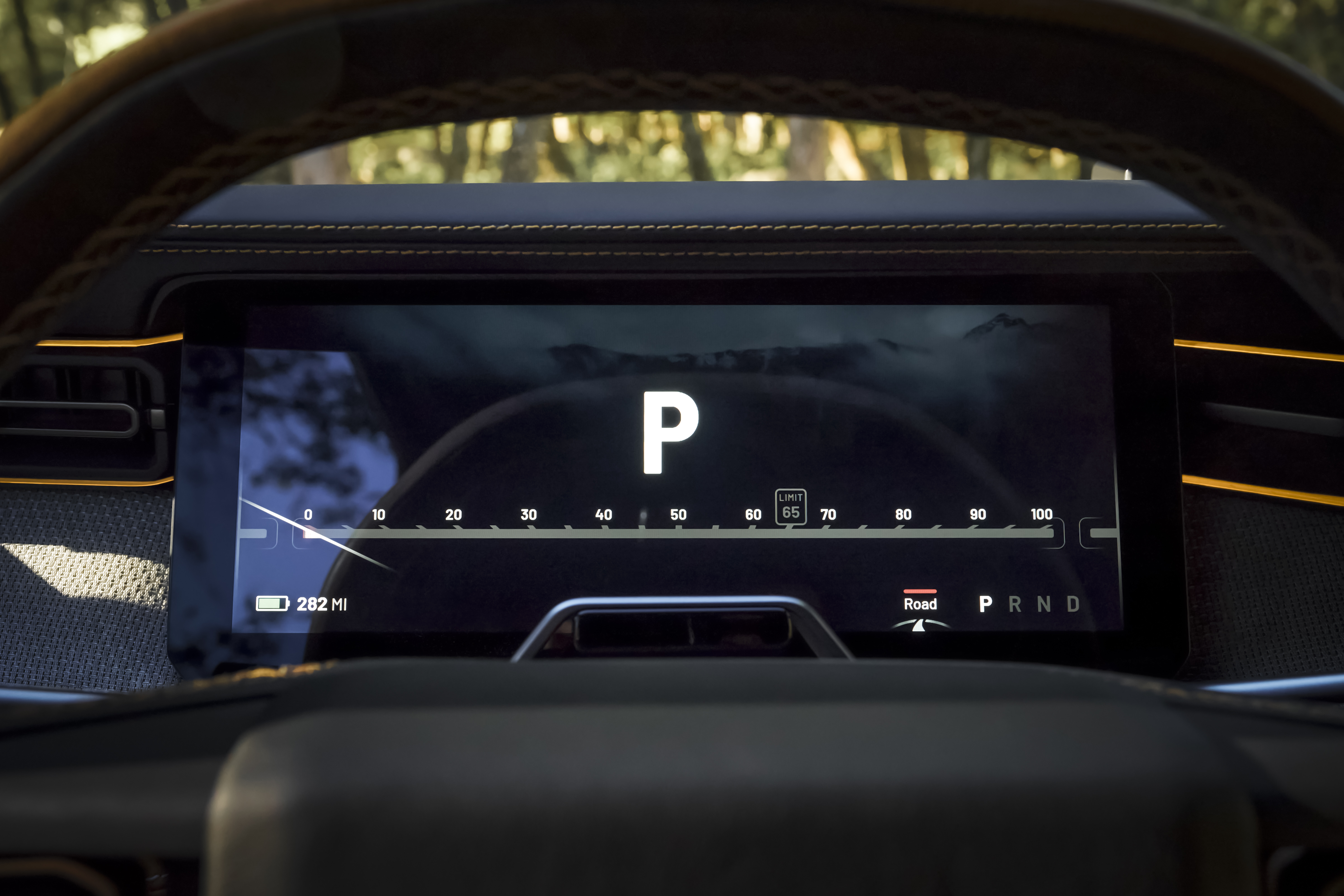

What does everyone think about the instrument cluster shown in the reveal vehicles?
What do you like about it? What don’t you like about it? What’s missing? How could it be improved?

I like the idea of the retro needle gauge but I think the particular design shown is a bit weak. One obvious problem is the fact that the gauge only goes up to 100 mph when even the old gauges on the classic Scouts went up to 120. But there are more subtle problems here as well, especially with the typography. I also think Scout could do much better with the battery gauge/range indicator. I also think the retro gauge will feel cool for a few weeks and then seem like it was a bit too literal, recreating the past more than being inspired by it. So I’m glad there will be options to choose something different.

In a classic gauge the numbers are much larger and have a narrow width. This is far more readable at a glance.
With the new design the “needle” passes through the gauge, and I’m not sure if we saw this in a video but it looks like the needle passes over the numbers. If so, they will become illegible because the numbers are too small relative to the thickness of the needle and they are the same color. If the needle does pass over the numbers, the numbers should be much larger so they are not obscured and the needle should have a contrasting color. Or else, the needle should be below the numbers but even then the numbers should be larger to be easier to read and have narrow width for a more retro feel.
Some other typography problems in the new design include: 1) the number 100 is offset to the left of the tick whereas all the other numbers are centered to the tick. 2) The glyphs are far to close together for their weight 3) the glyph weight subtracts too much negative space, decreasing legibility. This problem shows up in the bottom of the nine and the top of the ‘a’ in “road”. This is just bad typeface design, even a non-expert like me can tell it was never designed to be used at this weight 3) The glyphs in “road” are crammed too tightly together 4) the kerning or spacing is unnecessarily inconsistent elsewhere. Compare for example the spacing between the ‘M’ and ‘I” in “LIMIT” with the spacing in “282 MI”.
In terms of typography and functionality, I think the old gauge is superior to the new design.

I love it, modern design with a nod to the Scout II, now @Jamie@ScoutMotors , does the blinker signal display with vertical bars like the orginal Scout II?

its simple, which some folks will like. i always assumed it was a demo view and likely not set in stone. im sure it will evolve by the time its production ready. itd be cool if they allowed for several options. the one shown would obviously be the retro-throwback and we'd have more modern views with different info to choose from maybe based on style and/or drive mode. almost like the faces on Apple Watch.
I think electric provides an opportunity to add new kinds of gauges.
For example, I'd like to see a small needle gauge for each motor that shows a measurement of the electric current in amps, either being drawn or regenerated. So the needle straight up would mean no current is flowing. It moves to the right when current is drawn and to the left when it is regenerated. I would geek out over this. It could be insightful, for example in knowing when both motors are driving and when just one is. But even if it's not very useful it would just be very cool to see needles moving back and forth, letting the driver know the state of the machine. Many cars have tachometers and the information they provide is of little practical value to most people most of the time but everyone loves to see them because they make you feel connected to the machine. Electric needs an equivalent of the tachometer.
I also think combining the battery icon with miles of estimated range conflates two very different things.
A battery gauge should be a needle gauge with estimated usable charge in coulombs. The numbers on the gauge don't need to mean much to the average driver, they'll just see the needle drop like a fuel gauge does. The rest of us can geek out. Estimated range in miles could be accompanied by a graphic that changes as range drops, there's plenty of opportunity to get creative with this.

I’d love to have the exact same instrument panel as m’Scout, which was a little easier to read than this. I appreciated the taller letters for readability, same with the bolder lines. As a person of middle age, there gets to be that dance with the ravages of time on the ol’ eyeballs.
I kind of like that the gauge stops at 100 for the sake of East coast driving where people are maniacs and the highway gets really curvy (93/95 are pure treachery in MA). I don’t know if that’s the fastest speed you should ever wisely try to drive at or that’s expected top speed. I’m fine with either because I am absolutely not an exciting person on the highway (unless I’m not the one doing the driving and it’s happy hour because I am definitely not afraid of the police then🍸).
