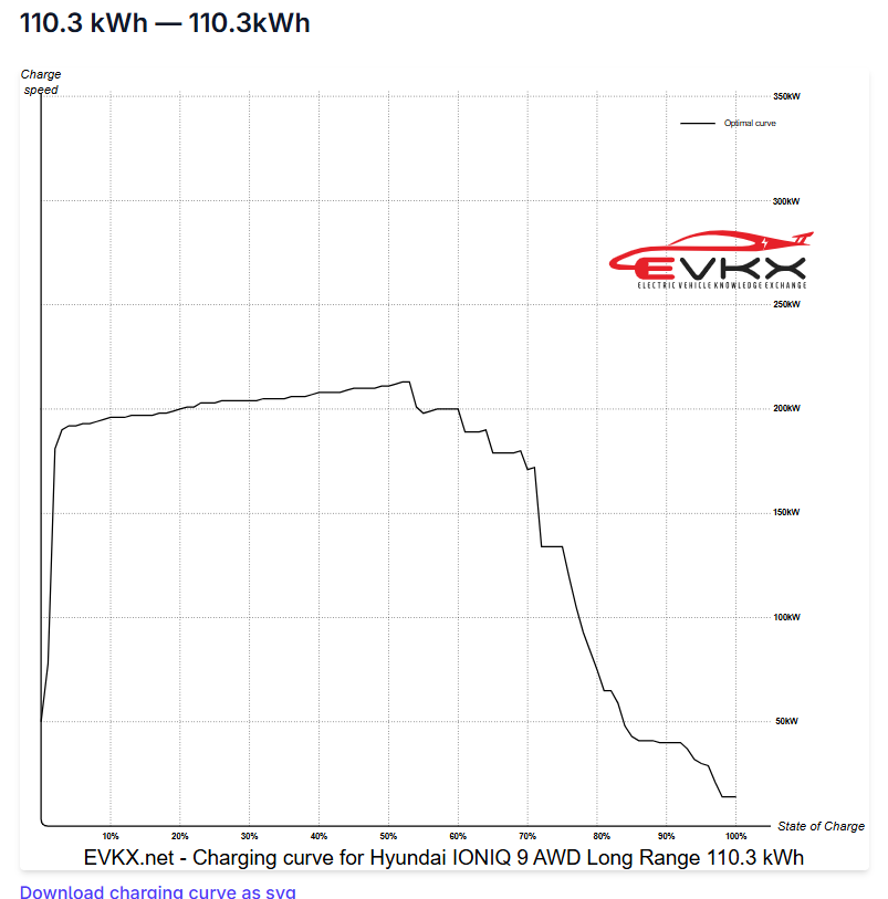

The problem is what they call a "charging curve". And simply put, a battery cannot be charged at the same rate from 0%, up to 100%, because of physics and how the battery soaks up electricity. Its always faster to charge in the lower stages of charge. This is why no one really charges past 80% on a road trip, as the rate of charging goes way down as you get closer and closer to 100%.
This is also why most Electric Vehicles advertise their 10-80% charge time, as thats usually the most impressive.

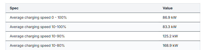

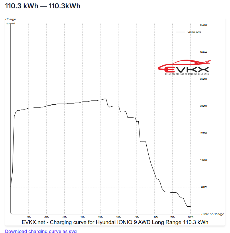

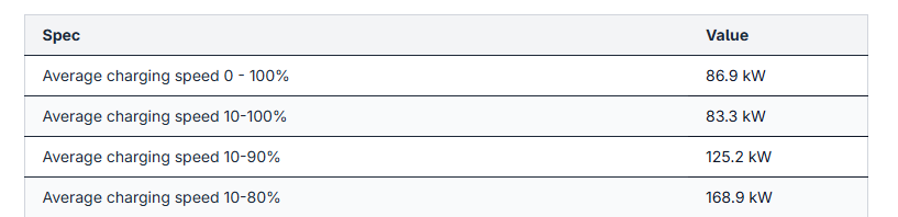

Here is the charging curve for my Ioniq 9. Vertical axis is power the battery is accepting, and horizontal is state of charge for the battery. You can see that the charge rate of the battery is ~200KW from like 5% - 55%, then it slowly drops. At 99% its at something like 15kw.
And you can see the averages here.

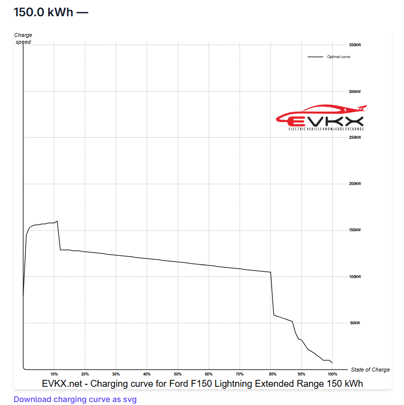

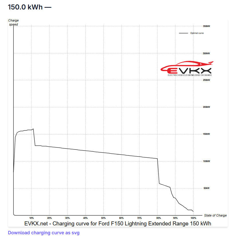

Oh, and for context, I went and dug up the F150's charging curve.
You can see the shape of the graph here is different than the Ioniq. Thats what we're talking about. It holds its peak charge rate for a very short time (~2-12%???). The Ioniq does it from ~2-55%.

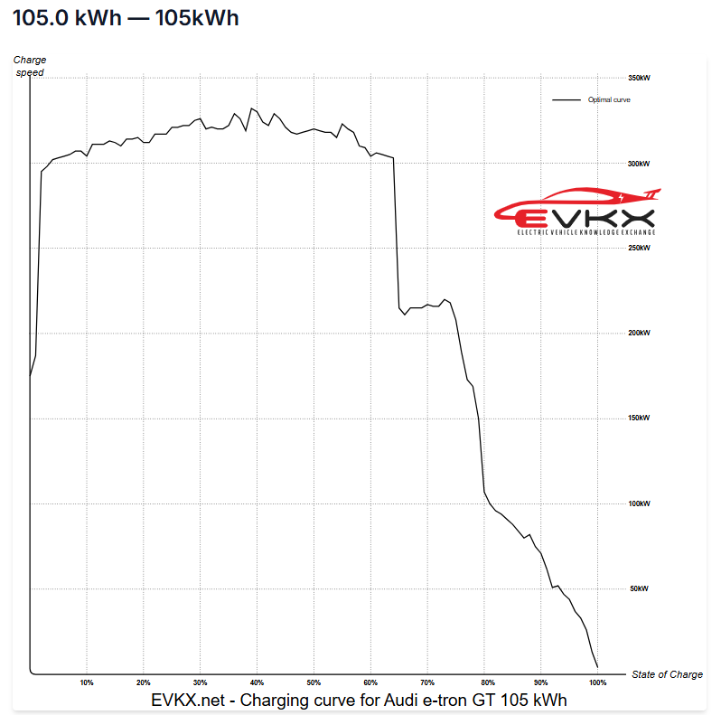

With the latest Porsche and Audi's charging really quickly, I'm optimistic.
Check out this charging curve from Audis latest. It holds over 300kw from ~3% - 65%. As a result, it charges over 10 minutes faster to 80% than my Ioniq 9 (which is also 800v, and a decent charger). Thats a huge improvement.
More of this please.
