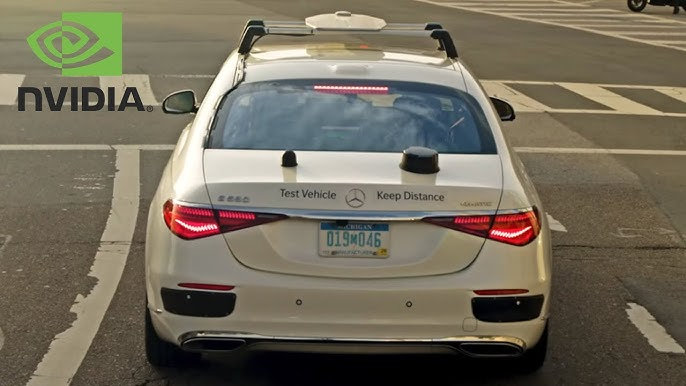

"Lucid targets industry-first self-driving car technology with Nvidia"
Just to be clear, Lucid is looking to buy off the shelf AV tech from NVIDIA that itself is an industry first, nothing of what Lucid is doing is industry first. I've been seeing the NVIDIA AV test vehicles driving around Silicon Valley for a handful of years now. They work pretty well except recently I saw one of these S-Classes suddenly think the outside line of a bike lane was the edge and it swerved right to line up and almost went into a restaurant parklet before the driver pulled it back. Whoops.
