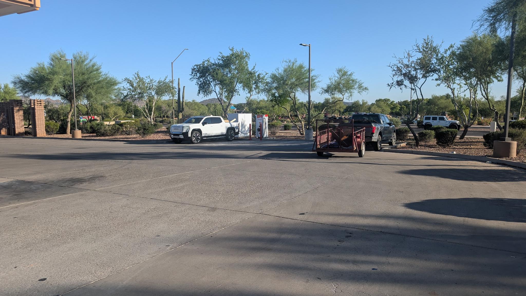

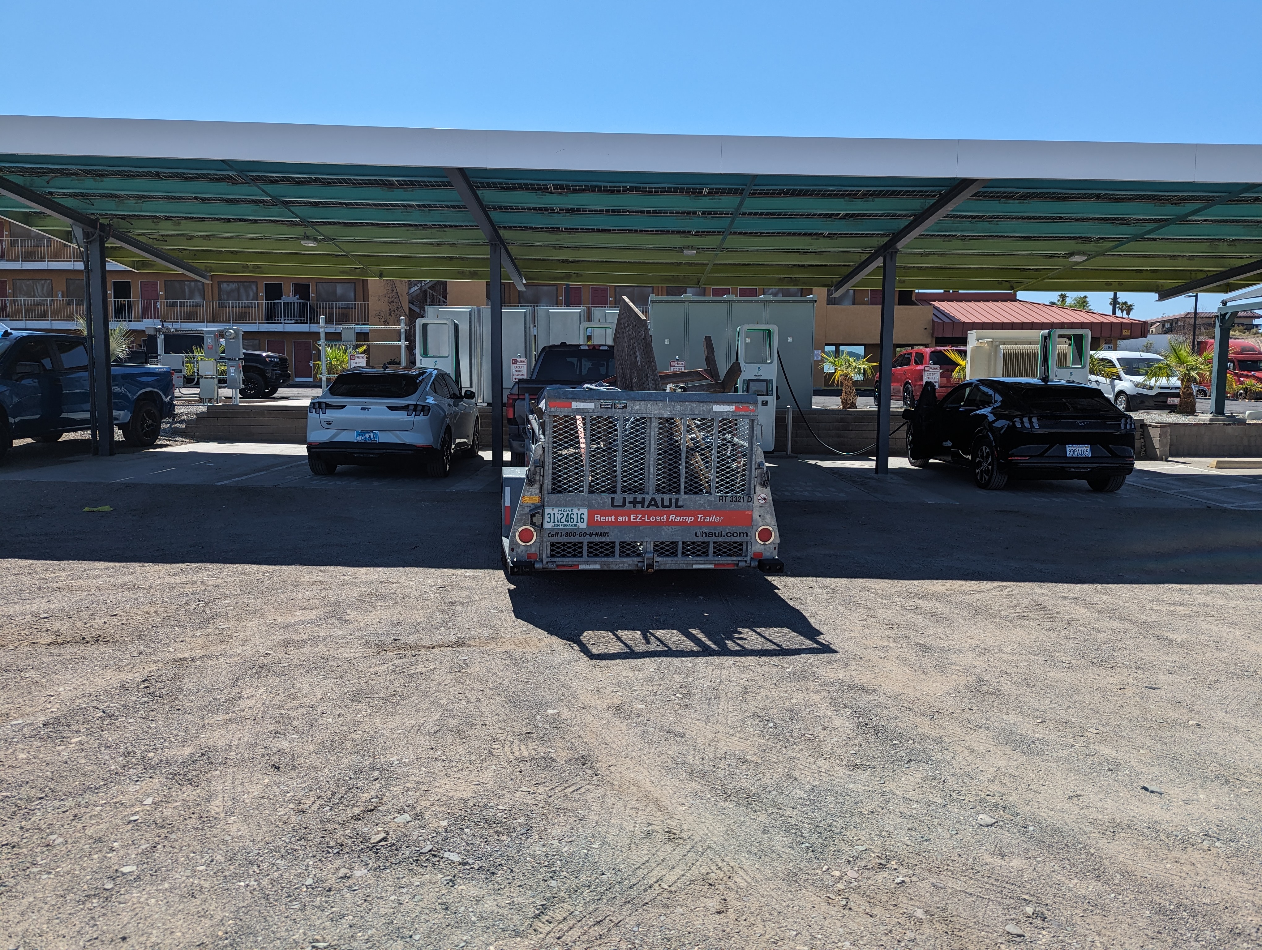

They are claiming a towing capacity, which means your argument that they shouldn't cater to the towing population makes no sense. By that logic, I suppose they shouldn't install a hitch or a high GAWR axle either. Since only "1%" of the customers will use them.
The vehicles are 80" wide but 220" and 208" long. It's not shorter to route from the back. But that argument is just silly anyway because they can install the charge control hardware anywhere they like.
Most chargers of every brand are pull in, so a rear port all but guarantees the necessity of dropping a trailer. There aren't going to be large-scale replacement with pull-through or pull-along chargers, which would be asking the charging companies to cater to an even smaller percent of customers than a company selling a tow vehicle with a front right charge port.
I know I won't be replacing my Lightning as a tow vehicle with one that's configured poorly, And putting the charge port in the rear is very poor configuration. To me it's the most concerning part of the configuration. The tow capacity isn't an issue for me. The tow range isn't an issue for me. But the concept vehicles' position of the charge port is a major design flaw.
They can match the geometry and reach those hilariously short cables by putting the charge port in the right front. No extra cost; lower likelihood of having to drop a trailer while towing; no added difficulty for non-towing drivers.
There's no logical or engineering reason for any tow-capable EV to have its charge port in the rear.
