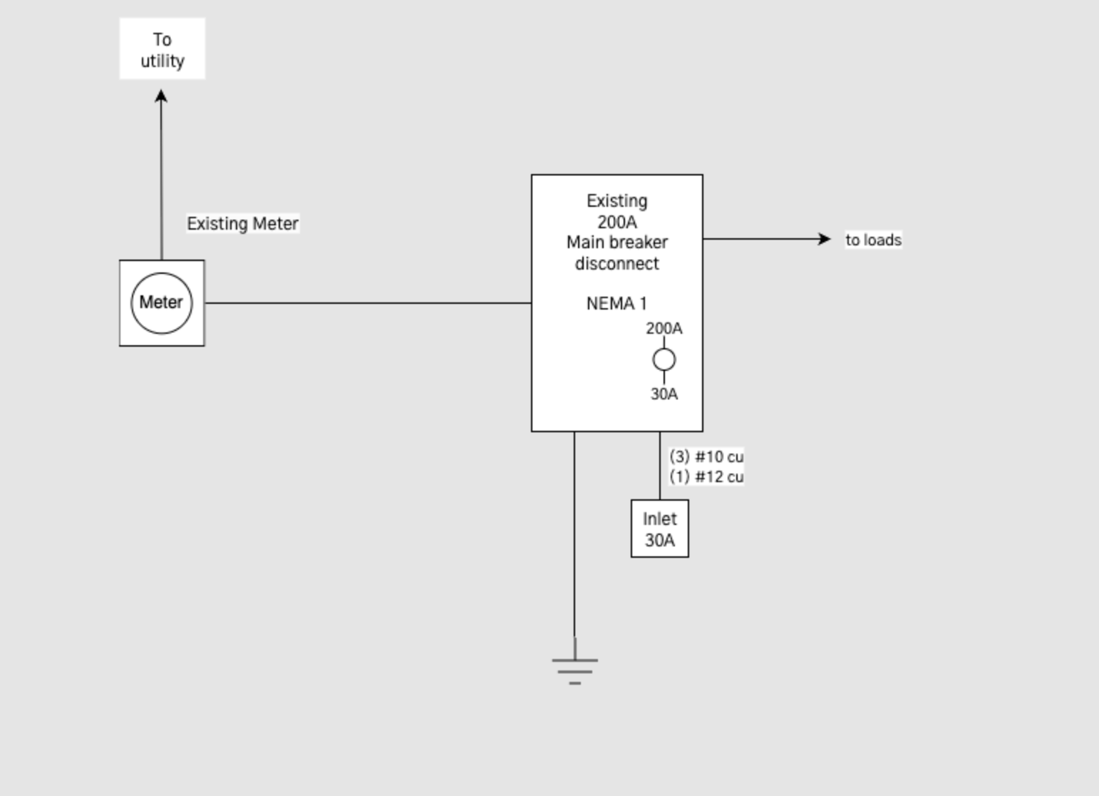

You must have an input that's on the same logical side as the main grid input such that there can only be one of those two inputs active at any time. The grid input must not be connected if the generator input is connected. It must be "physically impossible" to have both connected at the same time.
You cannot achieve that and also have power available to anything plugged into that inlet port when the grid is connected.
This line drawing shows what has to happen. The interlock/transfer switch is between the 200A grid and the 30A generator inlet. If one is connected, the other is not. And there must be a break-before-make situation so that it's not possible to even momentarily have the two connected at the same time.

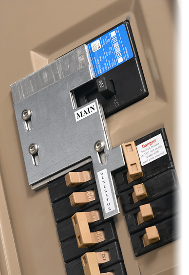

And this is what a manual interlock looks like when installed on a service entrance panel. When the main breaker can be turned on, the generator breaker cannot be turned on.
