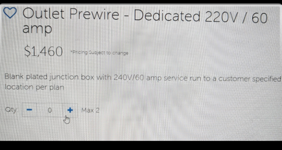

I'm having a house built in a new development. I have only one option for EV wiring from the builder.
I still have to choose a charger and have someone install it, but I don't currently have an EV. How do the specifications look?
Perfect.
This gives you full flexibility. You can install a hardwired, 60 Amp service, 48 Amp actual EVSE if you want. Or you can go for a slightly cheaper, 50 Amp plug, 40 Amp service EVSE.
The brief description looks fine, but at that price you'll want to make sure of a couple things:
  • Make sure the line is wired into the panel with an appropriate circuit breaker. The breaker should stay off until the other end is hooked up.
  • It says installed at a customer specified location; if you select an outside location makes sure the "blank plated junction box" is rated for outdoor use. If you end up installing an outlet, you'll need to replace the box, but if you hard wire a charger the box should be usable.
