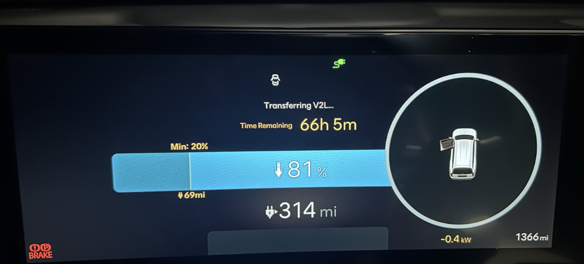

Our usage is different. Almost everything in our home is electric (save the propane stovetop, and fireplace). We have a heat pump water heater, and a heat pump heater (with backup resistive electrical heating). We have a freezer in the garage, a fridge/freezer in the kitchen inside, networking gear, and then the fireplace blower.
We had a power outage this year that was relatively short (2-3hrs), and I got to test things a bit. I did the above load + my gaming computer (which seems to use a few hundred watts, I forget the exact number). And everything worked fine... until I think one of the fridge/freezers did a defrost cycle. Because after about an hour and a half of < 1kw of output, the breaker on the end of the V2L adapter tripped.
I also noticed that the V2L adapter doesn't like the surge load of having all of the circuits at the same time. So I have to be careful to engage the 120v circuits one by one now (whereas my generator doesn't care if I just flip them all on at once, despite being a ~3250w 120v generator).
But in that ~2hr or so window, we used 1% of my Ioniqs battery. But, the V2L adapter efficiency is unknown. IIRC, I was seeing estimates of ~70hrs or so, with a ~400w-1000w load on it (I have a screenshot showing 66hrs left with 400w load, and 81% battery).
Oh, and one other thing. For the V2L adapter situation, you don't get to use all of the battery. It always keeps some in reserve (I think 20% is the default??). So in my 66hr situation, I was actually only using ~61% of the battery, because it would only draw down from where I was at the time (81%) to 20%.

I have a similar setup at home, but currently missing the 240v output side of things. I currently have an Ioniq 9, which can also use the V2L adapter to access its 107kwh useable battery. The problem is its low output (120v x 15amps :/). I also have a manual transfer switch.
I was considering adding a battery/inverter to provide more power when needed like you did, but considering I also already have a 240v generator, and most 240v output capable power stations/inverters cost more than the generator... I haven't done anything yet. Especially considering that the Scout will likely make the Ioniq 9's role in this process obsolete, in just a year or two.
