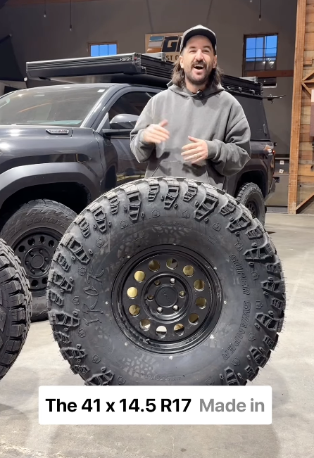

Might as well roll 41's while you're at it:

How is that not just a tractor tire!

What the H. Wow now that is some rubber.
