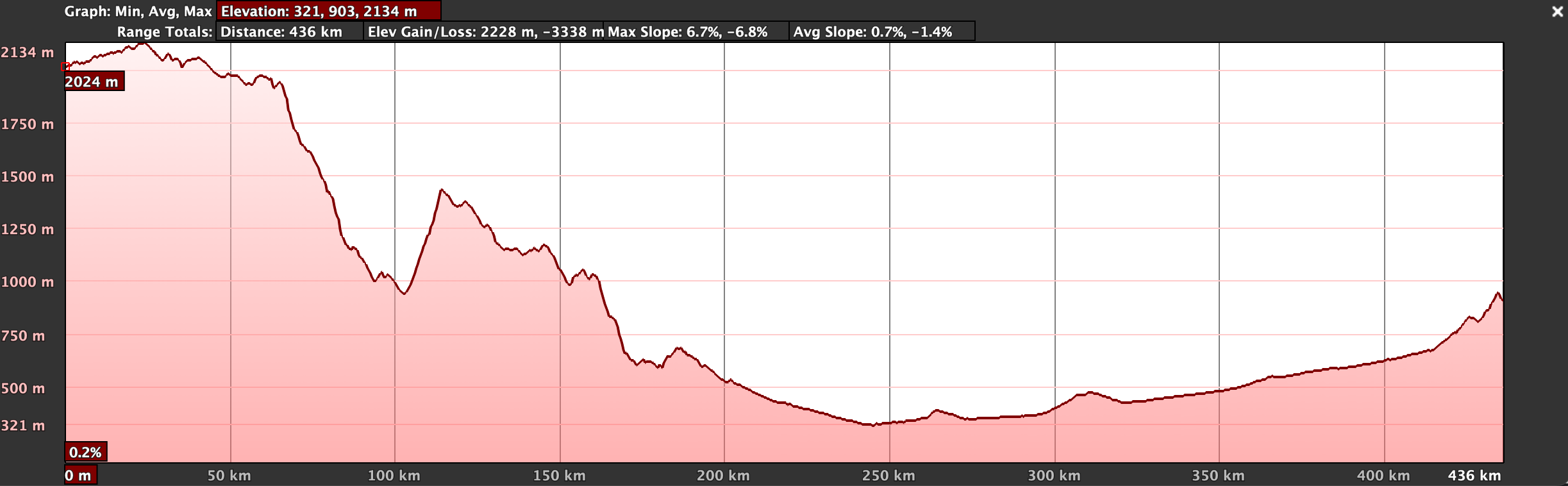

Back on the road.
Took a drive down from northern AZ to southern AZ. Tucson, to be specific.
I started the drive with 100%. Decided I wanted to just be at the hotel, so didn’t stop. I arrived in Tucson with 18% remaining.
After 15 minutes of gravel road and old, slow highway, I hit the freeway. Once the speed limit allowed, I set my cruising speed to 73 mph. There was traffic going through Phoenix. There’s always traffic going through Phoenix. Google estimated it would take 4.75 hours. I arrived 4.5 hours after leaving my home. Yeah, I’m too old to do that any more.
That’s 272 miles (from start to finish) using 82% of 131 kWh.
272 miles/ 107 kWh = 2.54 miles/kWh
272 miles / 4.5 hours = 60 mph average.
How was the range? Nearly exactly as the EPA estimate suggests. Maybe a little better. I was going down in elevation.
2.54 miles/kWh * 131 kWh = 333 miles.
272 miles / 0.82 = 332 miles.
I plugged into the charger here at the hotel and now have 100% charge to do the things I need to do this weekend.

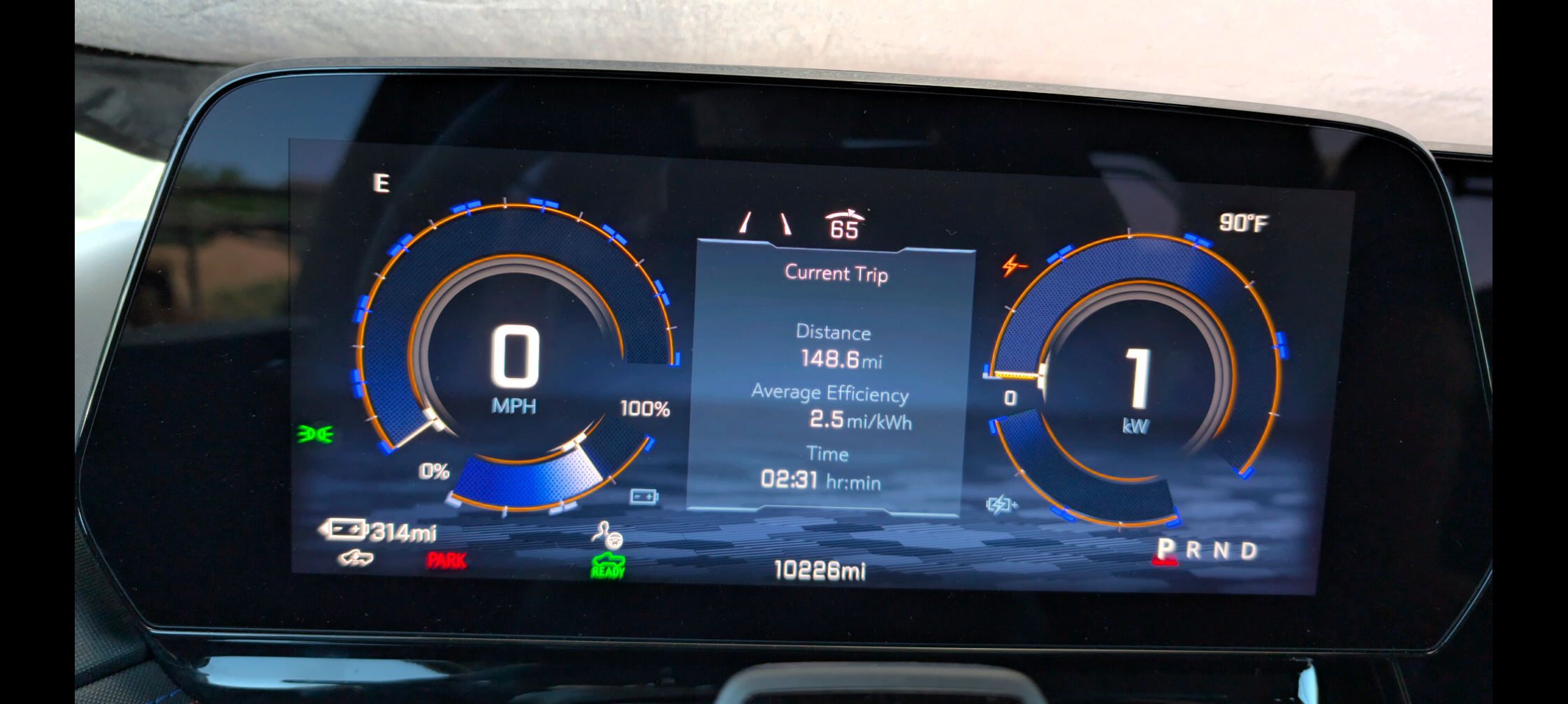

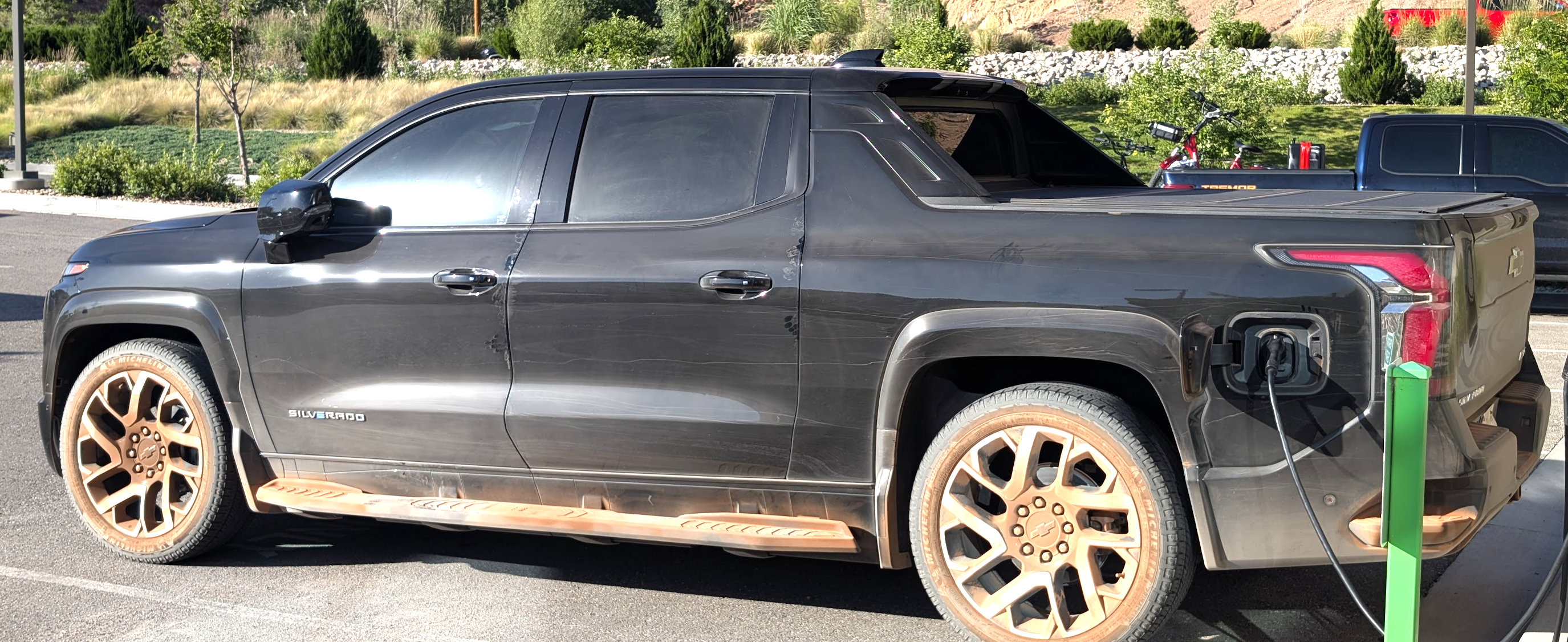

We've had the Silverado for less than two days and already added the desert pinstriping all trucks in AZ and UT deserve to sport.
We're on our way to Boulder, CO so I can teach a couple of workshops. Decided to take a short off-road / desert trail jaunt to test out the truck. It would be better if it had a locking rear (and front) differential. But the truck is decent. The tires are terrible for off-road.
We left home with 100% charge and stopped for lunch about 150 miles after leaving home. We arrived with 71% charge. We spent our normal amount of time at this lunch stop: 25 minutes. Using the brand T charger, we charged up to 95%. That's an average of 118 kW, mostly above the 80% soc mark.
We may need to stop for a charge tomorrow, and if we do, I'll try to remember to use the scanner to record a graph of the charge curve.
Our second leg was 180 miles, including the short off-road excursion. We left with 95% and arrived with 56%. The truck estimated we had 249 miles of range remaining.
On the first leg, we got about 2.52 miles/kWh. We did go downhill, but the wind was bad. On 2.52 mpk, we would expect to see 2.52*205 = 517 miles. I think that's optimistic for many trips that we do, but not all. The truck suggested we had another 314 miles after driving 149 miles; that's 462 miles that, which seems more realistic. the EPA estimated 440 miles for this truck.

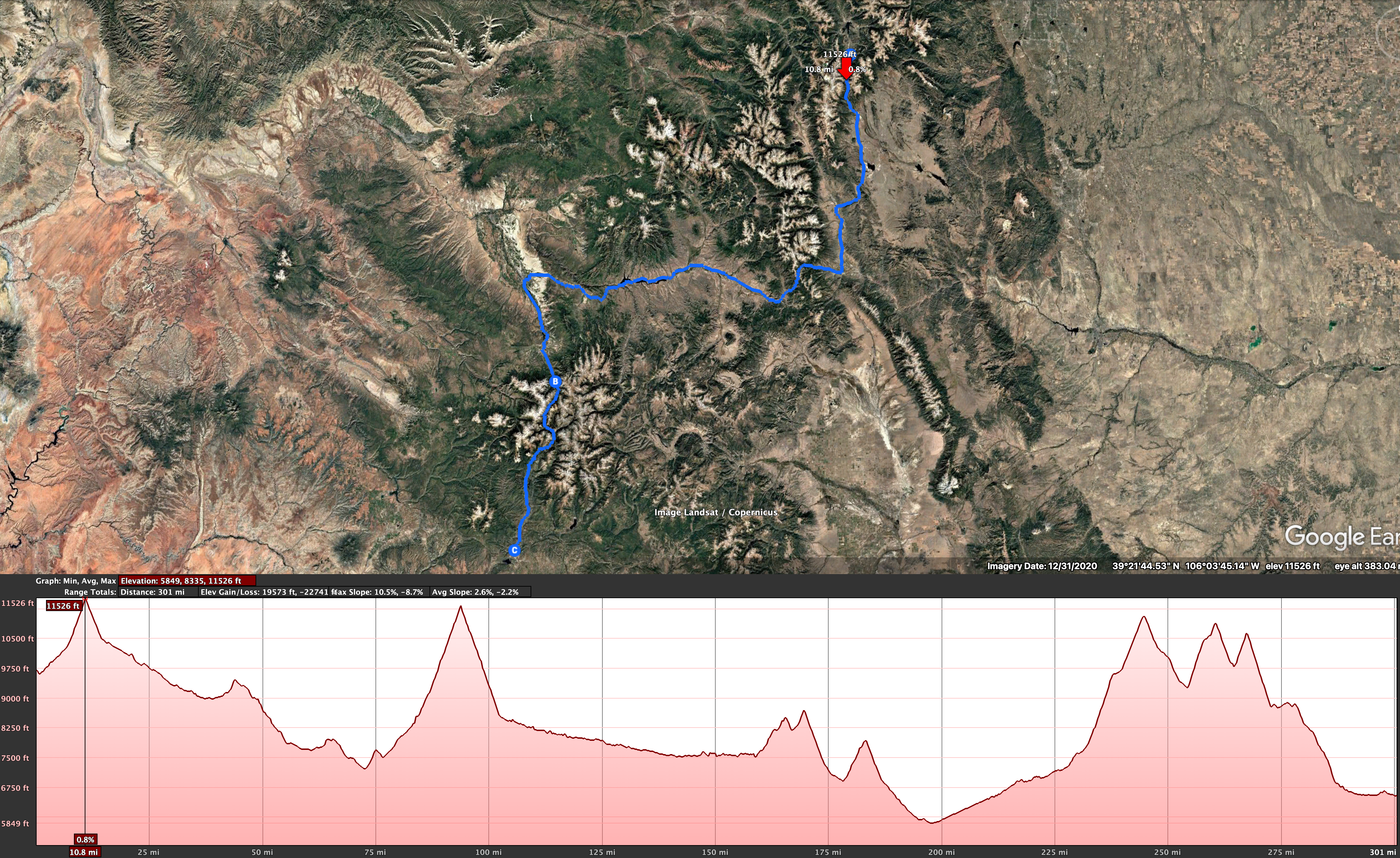

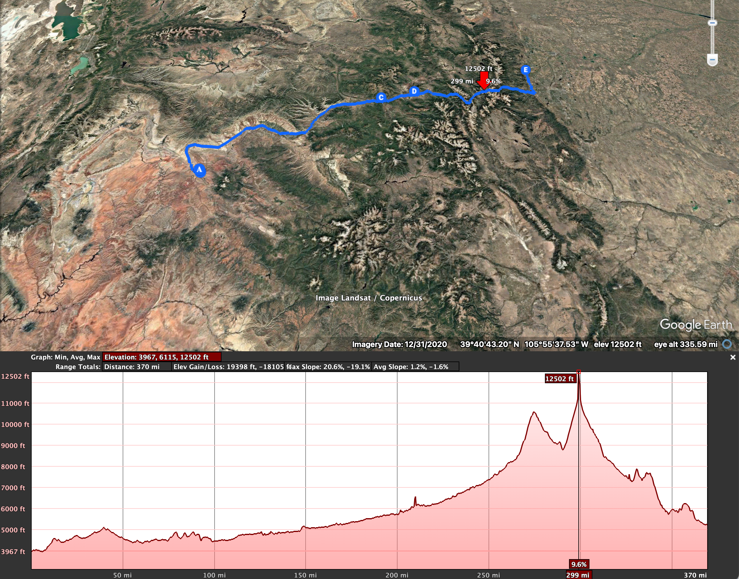

We drove from Moab to Boulder today. Total distance is 375 miles.
We started with 100% state of charge from charging on the hotel Level 2 overnight.
We drove from the hotel in Moab 200 miles to Glenwood Springs, CO. We were going to charge on the 350 kW Electrify America chargers there so we could get a feel for the faster charging capability. but it was busy. We had enough range to make it all the way to Boulder, but we needed food and a restroom break and didn’t see the point in not charging while eating. So we drove another 31 miles to Gypsum, CO to grab lunch at the Costco and a slower charge at the Tesla Supercharger. It wasn’t busy. A total of 231 miles of driving brought us to 50% state of charge, giving an estimated range of 462 miles.
We walked to the Costco and grabbed a hot dog. We were on the charger for 28 minutes. The T app complained about the charger losing connection multiple times, but each time the truck kept on charging. We got 68.3 kWh (36% of the battery capacity), which brought us from 50% to 86%. The truck estimated that 36% added 162 miles of range, which would mean a 450 mile range on 100% battery. What it really meant was that my partner won’t have to charge while exploring Boulder and we’ll only have to charge just before we leave. But I might plug it into a L2 near the hotel just to get some cheaper electrons.
We left Gypsum with 86% state of charge with an estimated 382 miles of range (total of 444 estimated range at 100%). We arrived in Boulder with 60% state of charge and an estimated 262 miles remaining (total of 437 estimated range at 100%).
So far the range estimates and arrival states-of-charge have been spot-on. Whatever data they’re using to estimate the route, speed, weather, etc, is giving them a better overall data set for range estimates than I’ve seen in any of the other BEVs I’ve driven far enough to need to charge.
Total climb was from 3967 feet elevation to 12,502 feet and back down to 5255 feet.

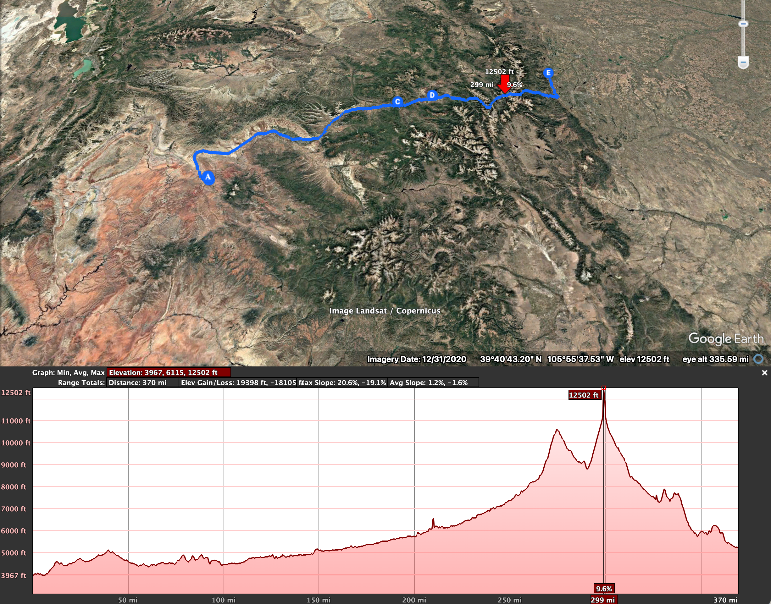

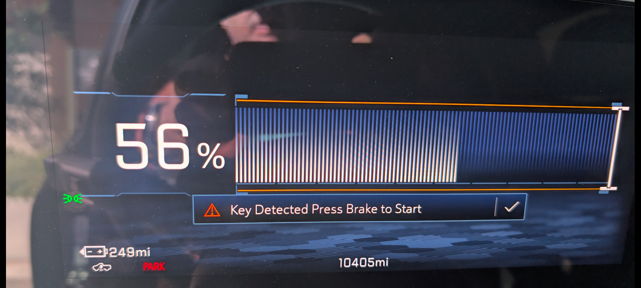

Drove around Boulder for work for the past several days. Never really needed to charge, but we did some opportunistic cheering in a couple of places. Parking + charging costs are pretty high, so we didn't put too much effort into charging. And we didn't need to with 63% battery. We had plenty of range.
Right before we left town, we stopped at Trader Joe's. There we charged on an EA DCFC from 62% to 85%. The charger is limited to a max state of charge of 85%, so we had to hurry back to the truck before they added an idle fee.
From Boulder, we took I70 up to Breckenridge. Google predicted we would use 29%. We arrived with 56%--used 29%. Using 29% to go about 100 miles is the worst efficiency we've seen in the Silverado so far (about 1.6 miles/kWh). But we did climb from about 5200 feet to over 12,000 feet before coming down to 10,000 feet. And we stayed with traffic at 65 mph.
The hotel isn't one we'll use again; it appears online as though it offers free L2 charging, but that's only available behind its valet parking, making its charging more expensive that most DCFC.

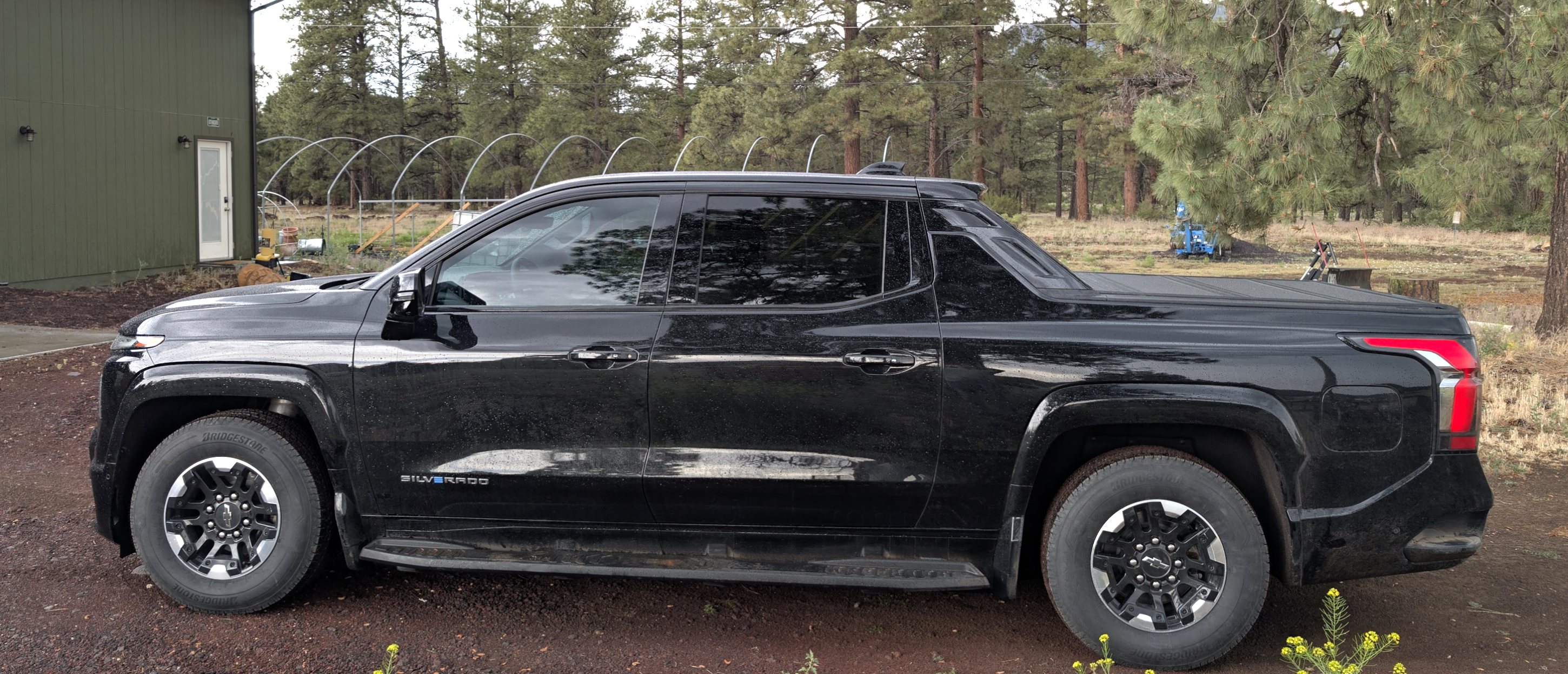

After 1540 miles road tripping with the Silverado through northern Arizona, southern and eastern Utah, and the Colorado Rockies, here’s my preliminary review:
The Silverado is a phenomenal BEV pickup truck. It drives like a truck (except when you forget to turn off the 4-wheel steering before you hit the freeway). It’s not as comfortable as the Lightning. It’s more comfortable than the Tacoma or the Mustang Mach-E. Its range is ridiculously long. Too long to be worth the cost of buying the 205 kWh battery (max range) unless you’re going to often tow long distances with it. We made many of the same stops with the Silverado as we’ve made with the Lightning on the same trips. We didn’t have to charge at every one of those stops, but we were stopping anyway. I think it’s going to save us a little bit more money per mile driven, but not a substantial amount. It will make it easier to tow our tent trailer to Canada this summer—well, except the rear charge port is dumb design.
Some things we’ve encountered, good and bad.

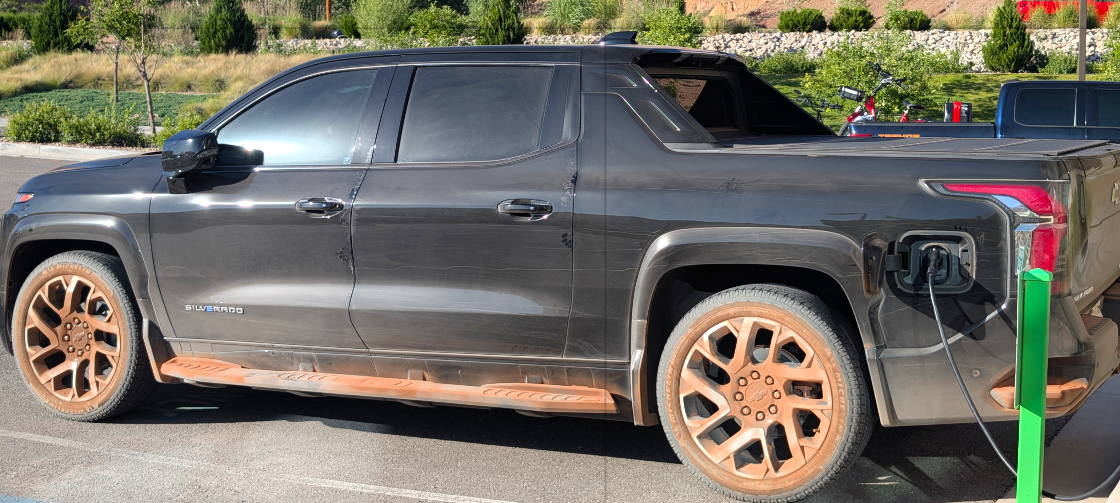

I just replaced the 24” wheels and 35” tires with 18” wheels and 33” tires.
Specifically, I got a set of four Bridgestone Alenza A/S 02 LT265/70R18 on closeout for $129 each. These are AS tires, not AT tires. I don’t usually run AT tires unless I am planning a long trip offroad.
These tires have a load range of E, 3525 pounds maximum load, a Service Description of 124/121S, compared with the OEM tires Service Description of 121/118S and max load of 3195 pounds.
I also found a set of 18” Hummer EV takeoffs for a decent price.
Going from the 275/50R24 to 265/70R18 means a decrease in diameter from 34.8” to 32.6”, so a reduction of 2.2 inches in diameter.
The weight per corner for the OEMs was about 120 pounds, for a total of 480 pounds for all four.
The weight per corner for the Hummer wheels are 39 pounds, the tires were 44 pounds, for a total of 83 pounds per corner, or 332 pounds for all four. That’s a savings of around 150 pounds of unsprung weight, and a significant savings of rotational energy spent on spinning up the tires.
I can lower the air pressure a bit and still have OEM-like load capacity. I’ll probably run it with just a few PSI lower than the door jamb recommends. The recommended pressure is 61 PSI front, 68 PSI rear. I’ll probably run it at 58 PSI front and 65 PSI rear, but I need to sit down and do the calculation.
I took it for a 21 mile round trip test ride before and after, but a rain storm blew in before I could finish swapping, so the after test was in the wind/rain. I need a longer drive than this to really understand the impact. Note that the smaller diameter tire has a 6.3% smaller circumference, which means the odometer gives me a 6.3% longer distance measured than actually driven and a 6.3% slower speed than reality. I still need to learn how to reprogram the odometer and speedometer. A 6.3% smaller tire should give a 6.3% better efficiency reading when just doing distance driven divided by energy used. But a smaller, lighter tire/wheel combination will give a better real efficiency. I didn’t do a great job of measuring the energy used before and after, and the weather changed dramatically between the two test drives. I may swap again to do a longer, better test.
StateWeatherCruise Control SpeedActual speedDistance on trip meterActual DistanceMeasured Miles/kWhActual Miles/kWh
BeforeClear, dry, slight wind75 mph75 mph21212.22.2
AfterWindy, heavy rain81 mph75 mph22.4212.52.4
