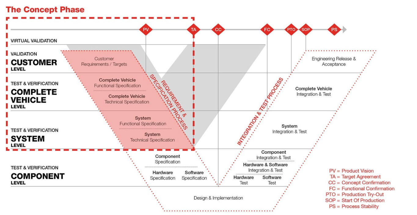

This is a pretty good methodology (caveat being that I am not an engineer and do not work for an OEM). I would say Scout is through the Concept Confirmation phase of this. My only point was that before "Pilot" with real vehicles to flesh out those assembly issues, we would likely see a prototype run, which might look something like the current concept vehicles we have seen, BUT with actual core components built into the frame of the concept (as opposed to solely on mules).
Exciting times ahead for sure as FC or the Functional Confirmation phase gets underway to include all HW, SW and components. This is from Magna FWIW:
